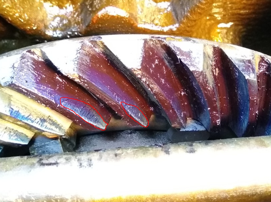

The shims are 9-10-11 from the looks in the diagram and that plate is inside the transmission housing - correct?
Also its hard to tell the engagement sitting here, but when you say driven side of the ring gear is the very "inside" tip, do you mean engagement is near the bottom of the pinion, or just on the top 1/3 of the pinion?
The pictures and pattern seem to indicate they are 3/4 engaged, not just the tip. If they are in the top 1/2 then tear down, if they are 3/4 or better engaged it's your call, but I would be inclined to leave it.

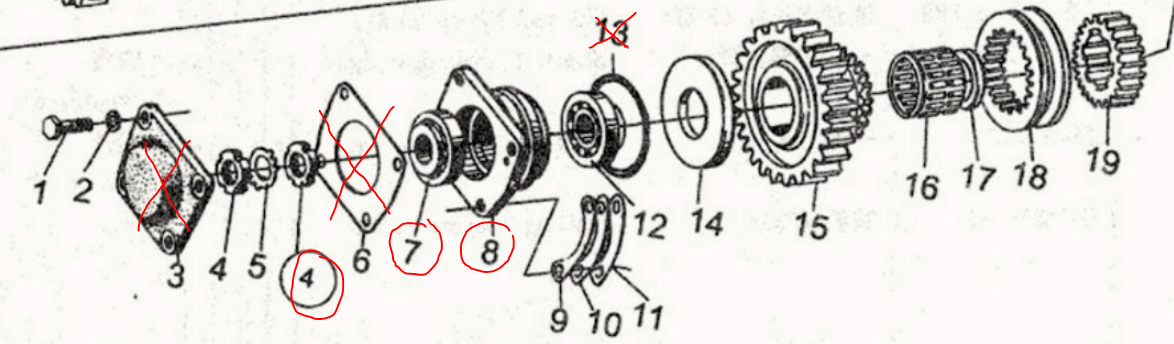

Is #13 your shims? Looks like you are pretty limited as to what you can do. Is the #8 bearing retainer is holding you back? Maybe you can shim it?
13 is an oring.
9, 10 and 11 are the shims.
I think 31 is what's limiting further movement.
Highlited driven side pattern in red

Items X'd out don't exist.
Nut 4, bearing 7 and housing 8 along with shims sets the pinion depth.
Housing 8 sits on outside front of rear casting. So more shims moves pinion forward away from ring gear.
BUT, you can remove 4,7 and 8 and the pinion shaft will not move much further forward.
Hope that makes sense.

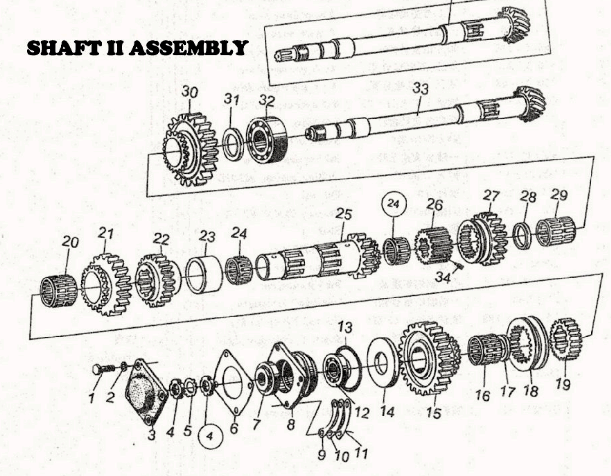

Thanks for the detail pics - I don't like that engagement either, but don't know what is spec?
It appears# 31 is a spacer between the bearing and the gear on the back portion of the shaft not a snap ring
So from what we know is removing 9-10-11 does minimal to engagement.
What about removing # 8 and shimming behind bearing # 12, as it appears it would hit a flange on the pinion shaft?

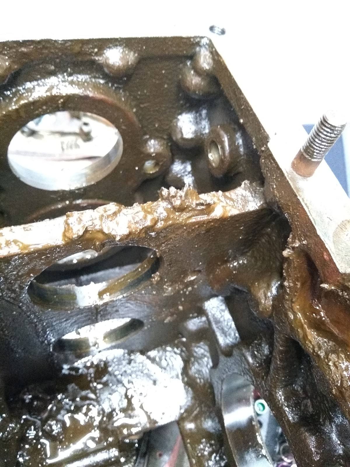

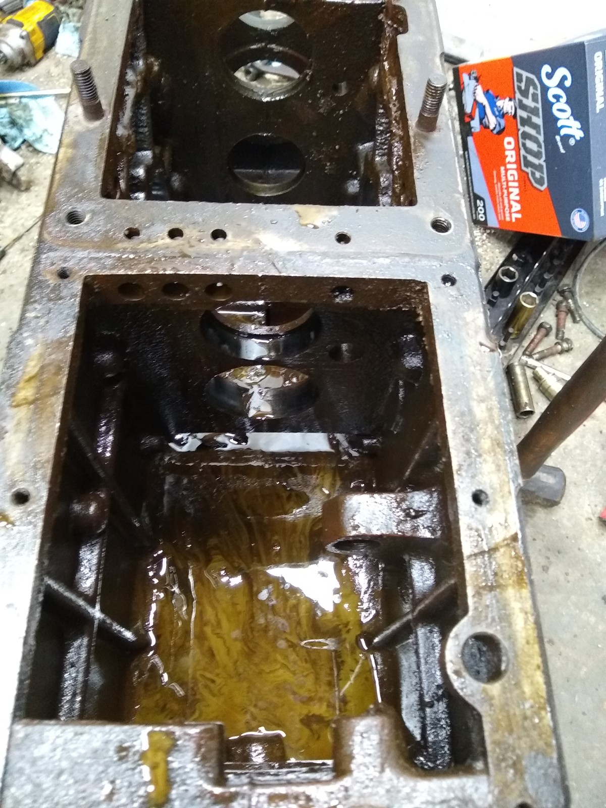

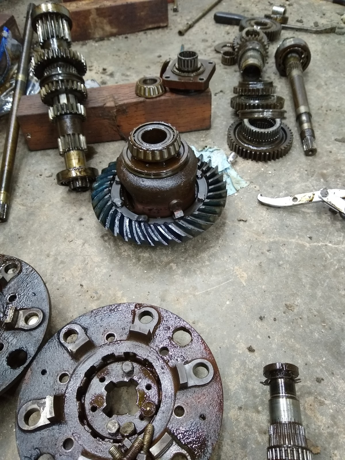

Took 2-3 hours to take pinion shaft out. EVERTHING has to come out including PTO gear to get at pinion.
Now I'll clean everything real good and start re-assembly. I think there are two spacers where it shows 1 in the part manual. Not sure if this was on purpose or not, have to investigate further.
Why do they put 1/2" of goop on everything at the factory? Nasty stuff that's like bearing grease mixed with clay. Is it so the castings don't leak through any voids in metal?
   / Kama KM554 rebuild and upgrades
#68

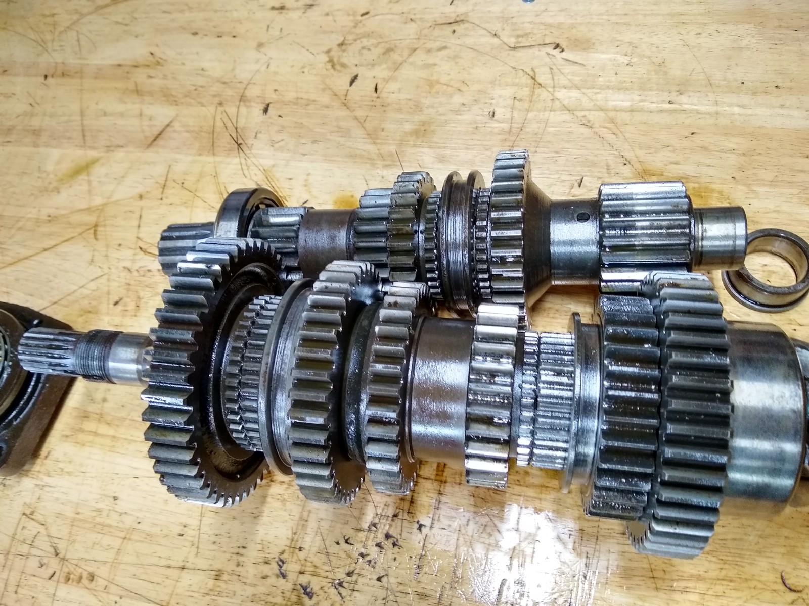

Gears clean and ready for assembly.
There were two spacers (one thin one thick) where the part diagram said there was one, but that wasn't the issue. Issues was the rear bearing wouldn't budge in housing. This prevented the main shaft with pinion from adjusting with shims.

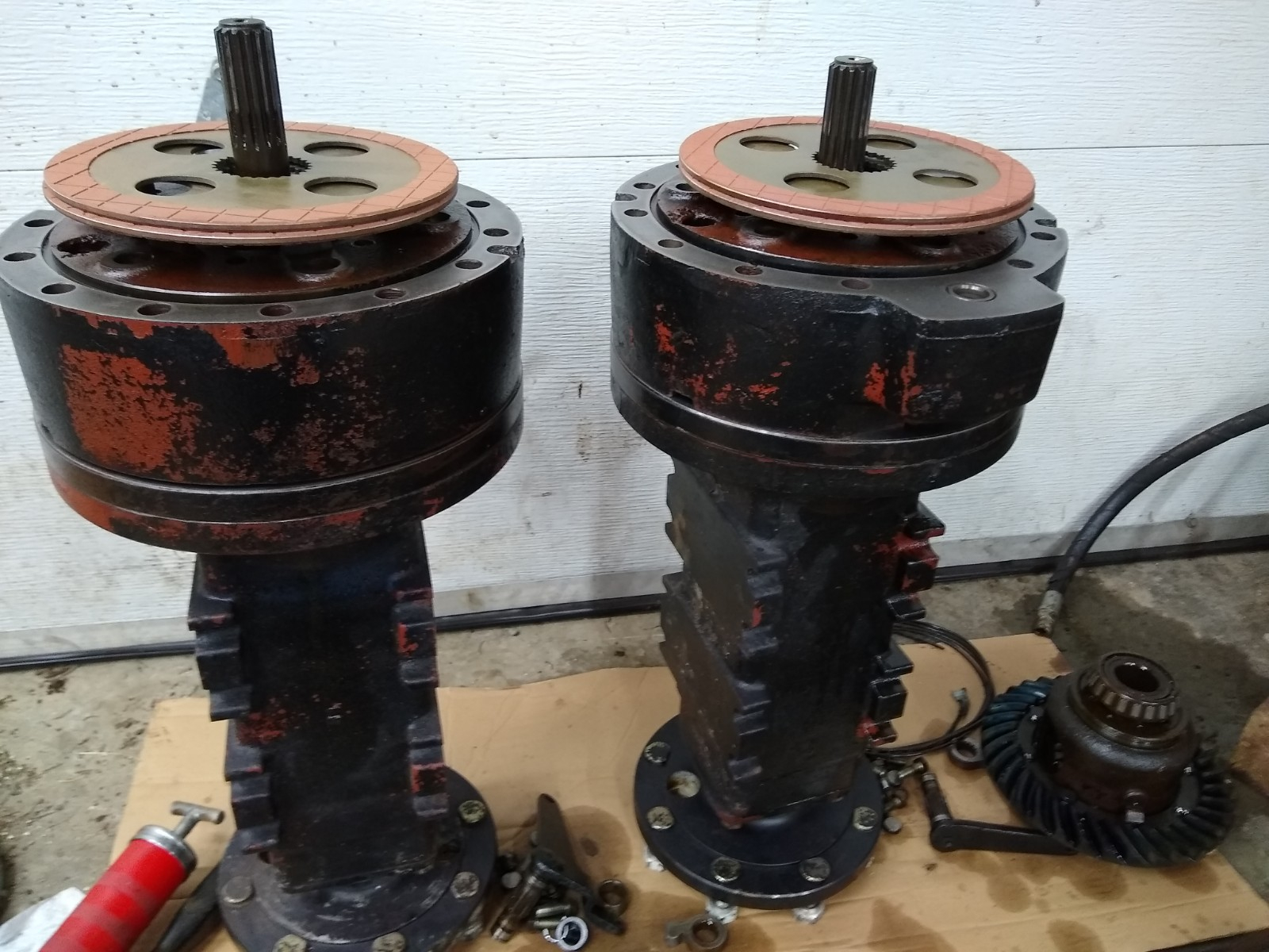

Brakes and axles cleaned prepped and ready for assembly. New friction disks and resurfaced metal wear surfaces should fix poor braking.
