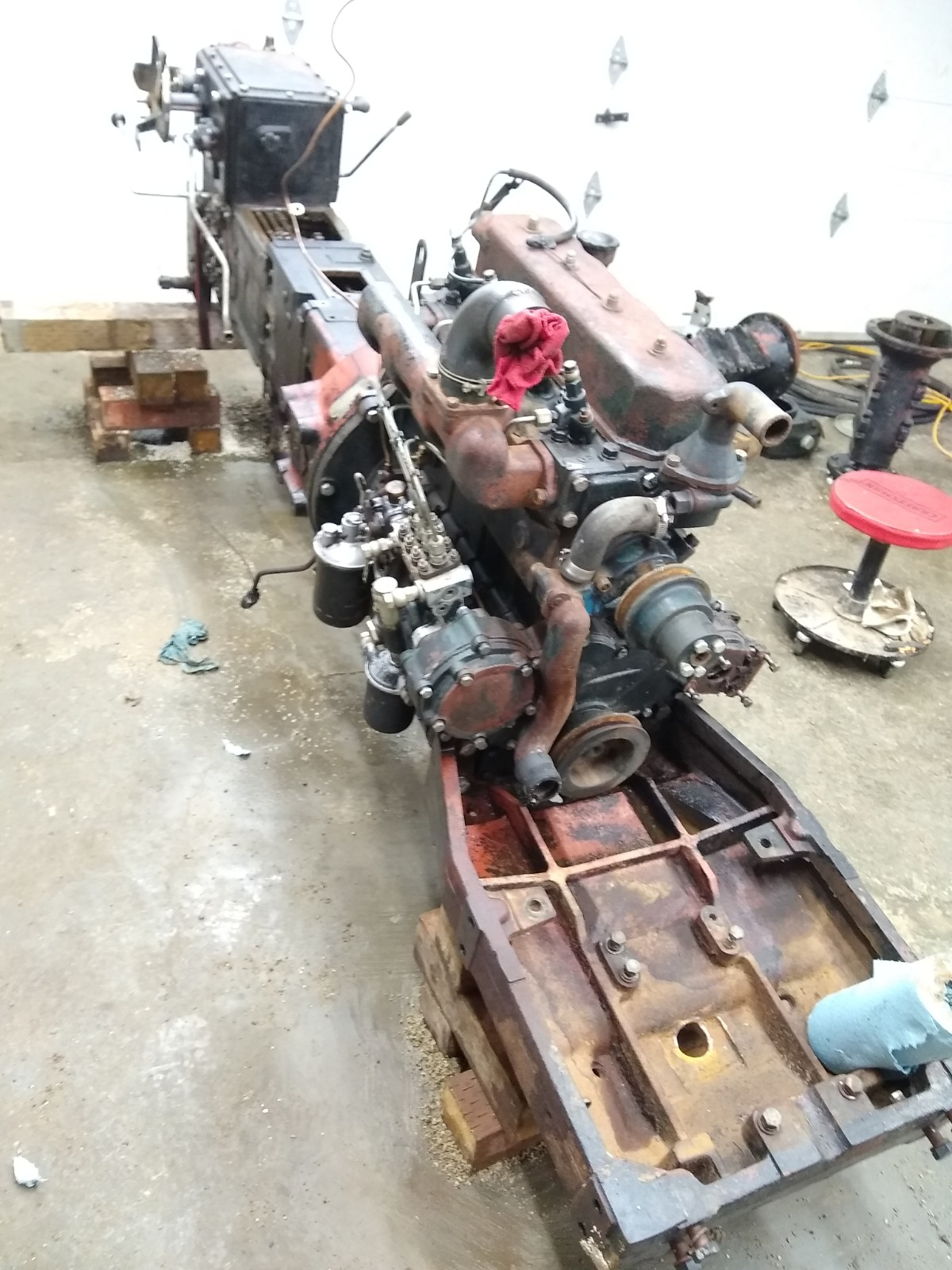

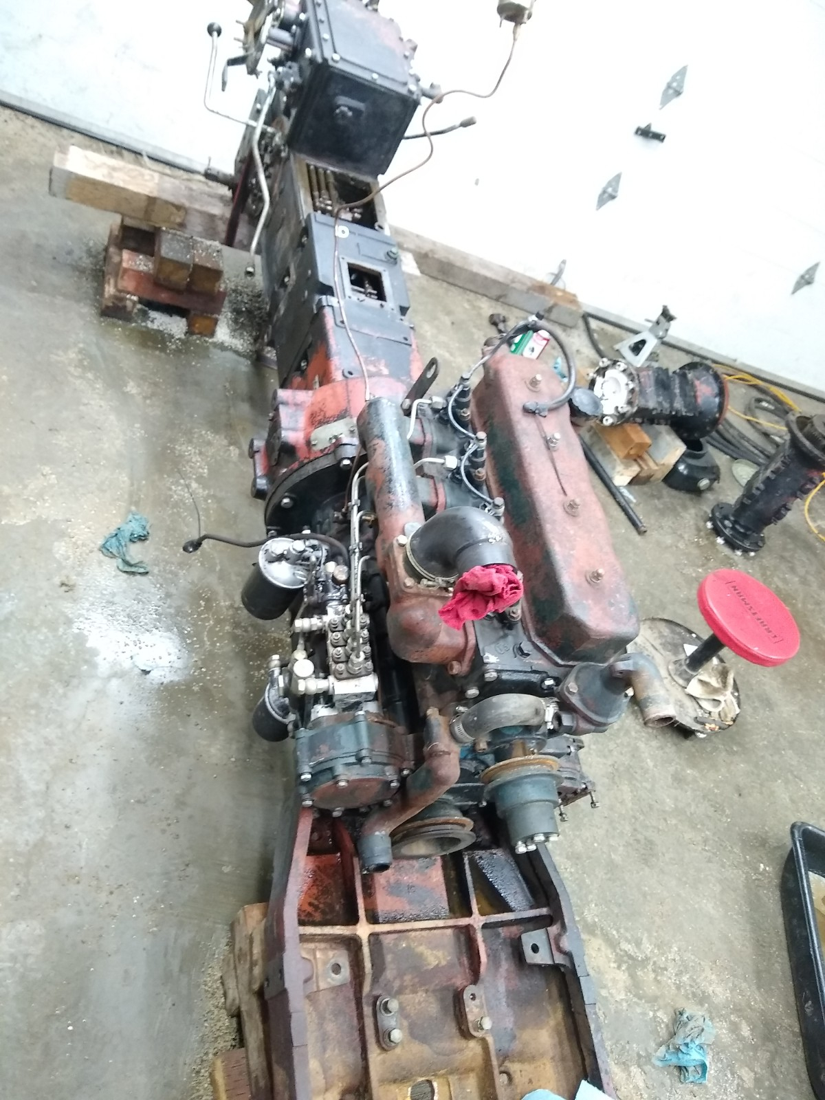

Well driller showed up unannounced so had to take care of that mess. Got lots of water now.
Almost ready for paint. Any recommendations on type of brand of rattle can paint for the engine/frame?

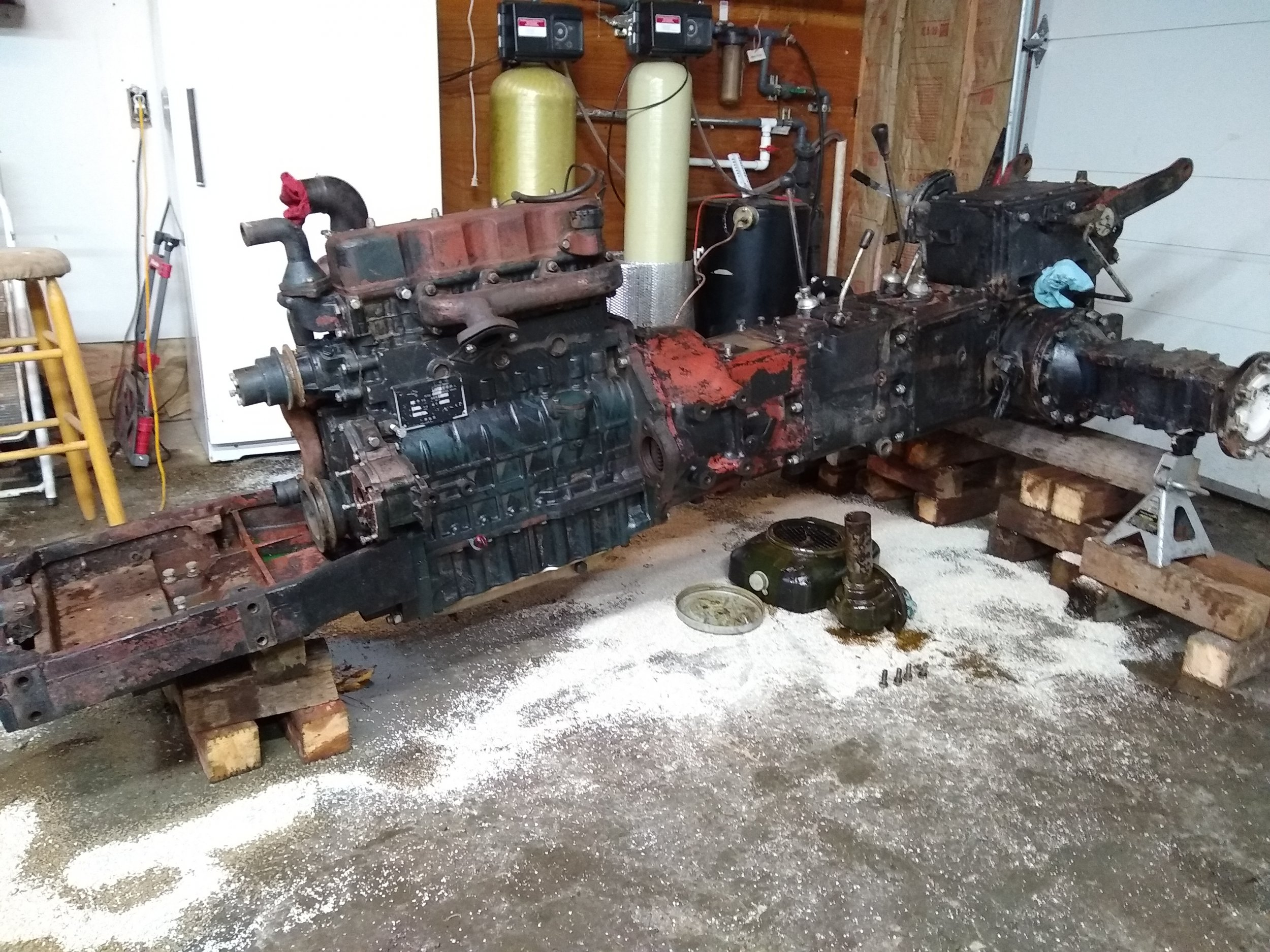

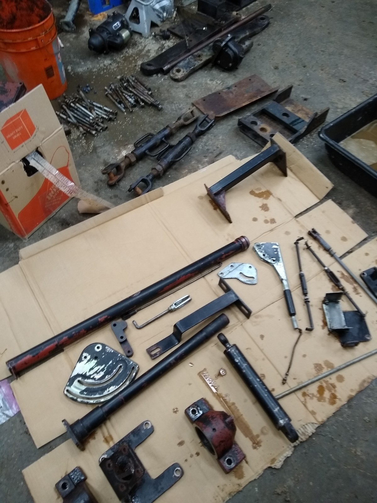

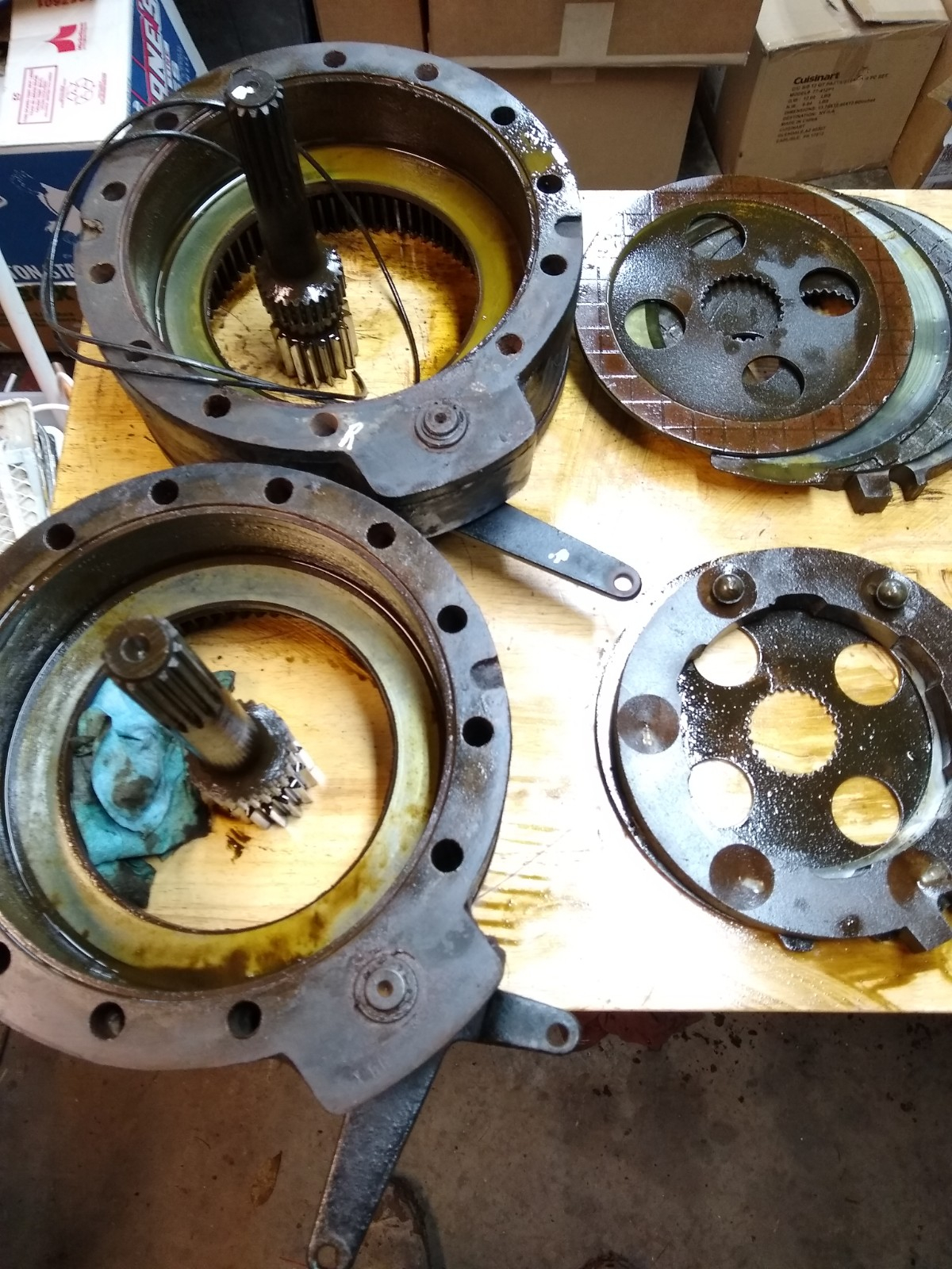

Brakes fully disassembled.
4X brake disks on order from China.

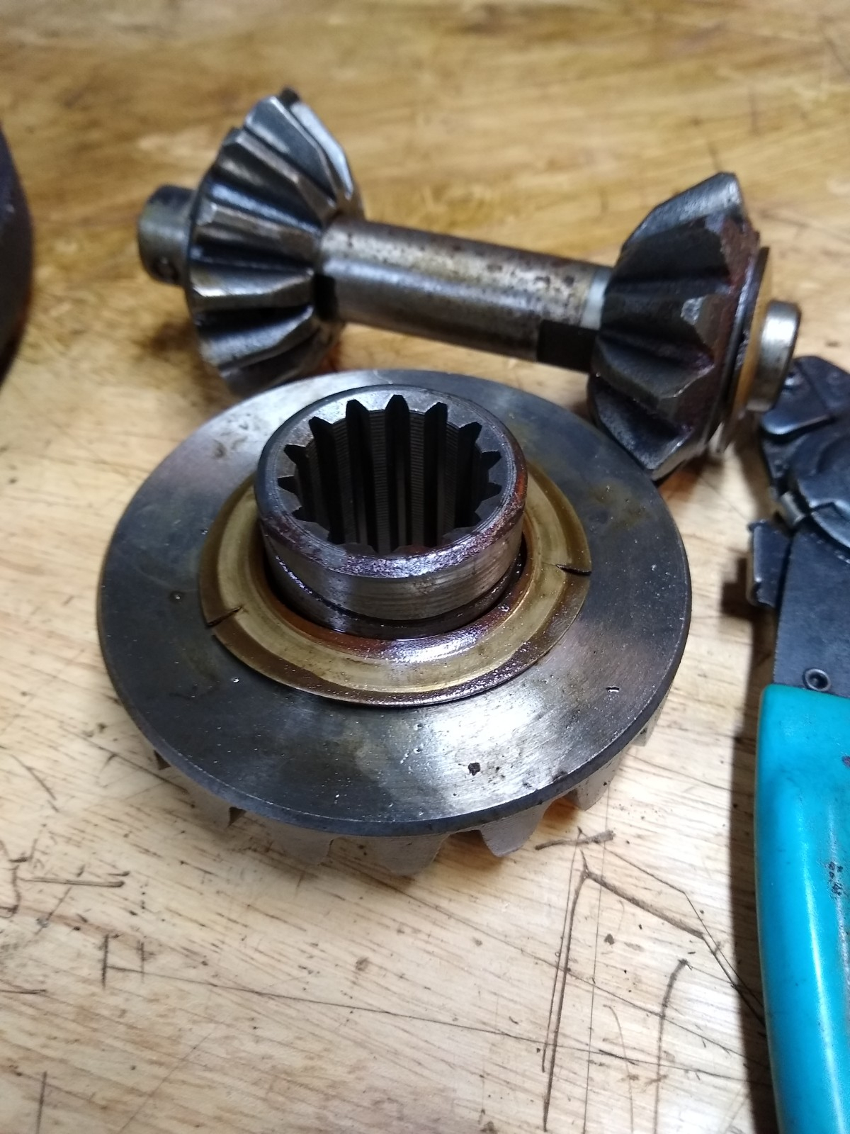

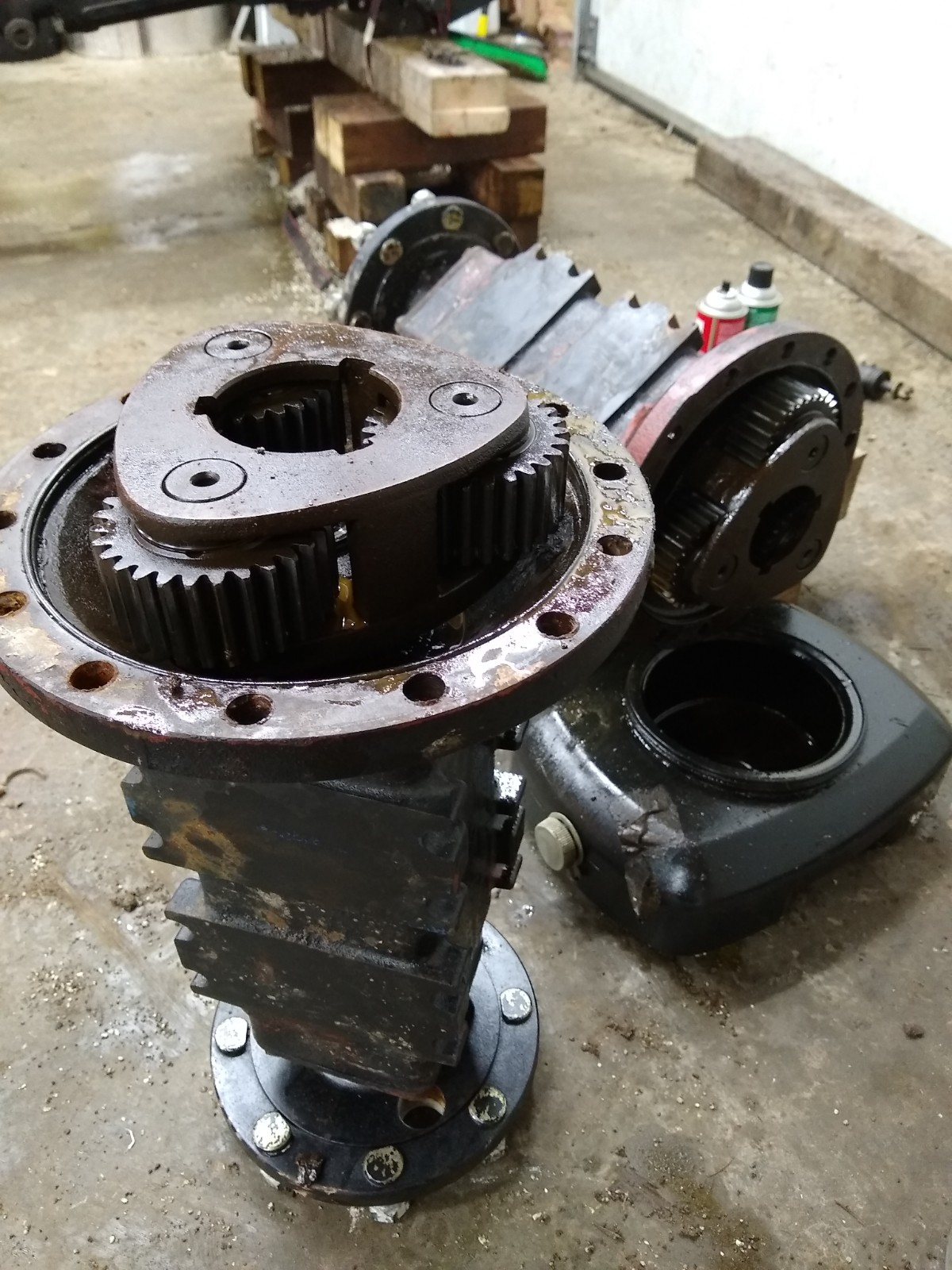

Need new thrust washer for front diff side gear. Should be able to find something close enough locally or online.
Rear axles removed. Everything is good. Built super heavy, one axle and housing probably weighs close to 200 lbs.
She's stripped down and ready for paint after quick de-wax rub down.

Robust looking planetaries in those rear axles. NICE! Are you going to mask off the traditionally unpainted parts or are you just going to spray bomb it?
   / Kama KM554 rebuild and upgrades #45
Great progress - didn't realize you were taking it down this far, but like they say while your in this far might as well.

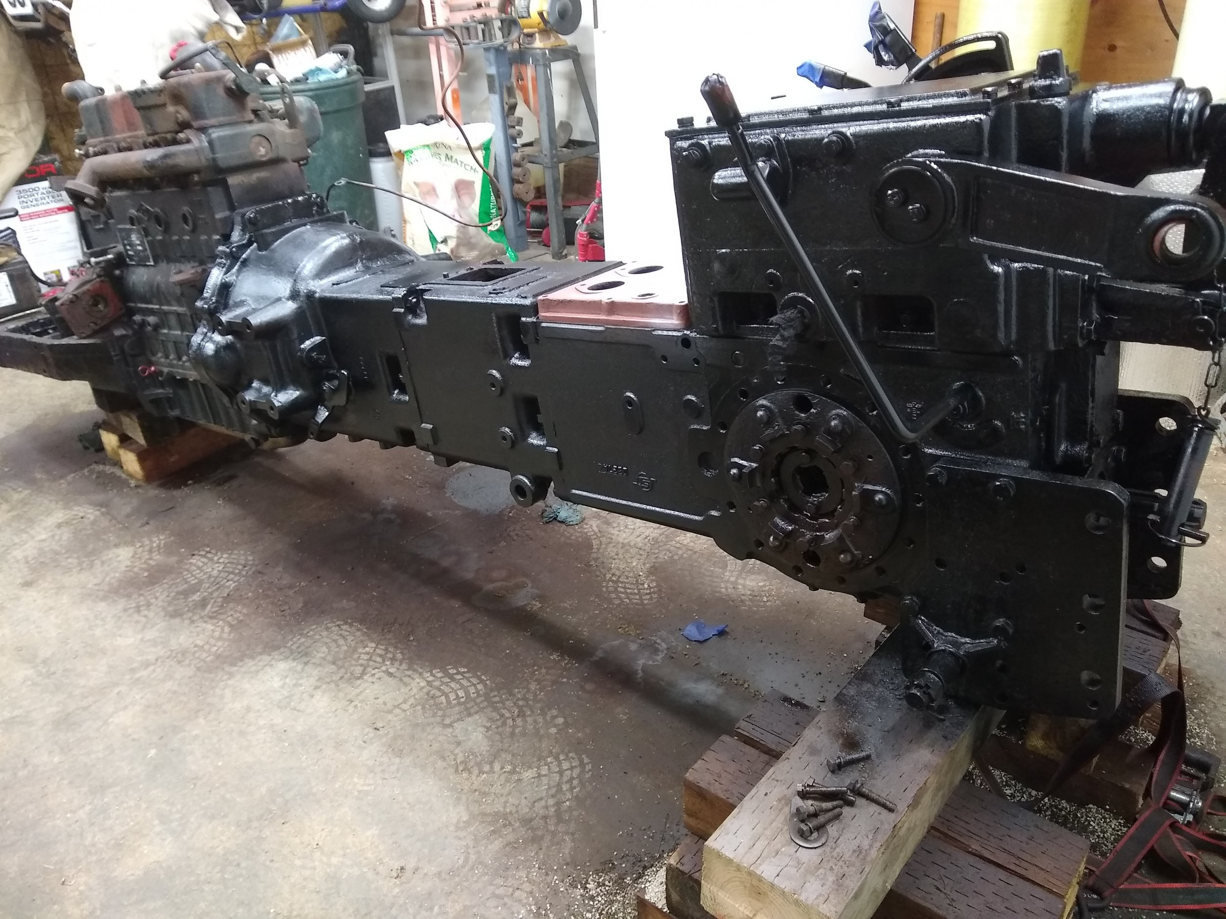

#46
Rustoleom Professional lacquer and primer rattlecans. Prepping is key, paint went on real nice and looks good.
   / Kama KM554 rebuild and upgrades #47

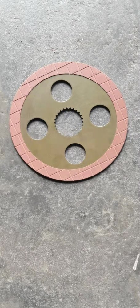

Looking better every day - nice work. The brake pads you found in China, from the OEM, and curious on shipping time, and were they reasonable?
#48
I didn't order direct for OEM, they are sourced through a middleman on Aliexpress.com
Haven't received them yet, but prices on parts are low. Cost of shipping is high if you want air freight.
4 bevel gears for front hubs and 4 brake disks were $180 total, shipping is $135.
   / Kama KM554 rebuild and upgrades #49
Not terrible for parts cost, as most brake discs I saw were 25-40 ea. but the shipping is very expensive these days with containers going up 4x or more from last year, so i guess air freight, that's to be expected.
