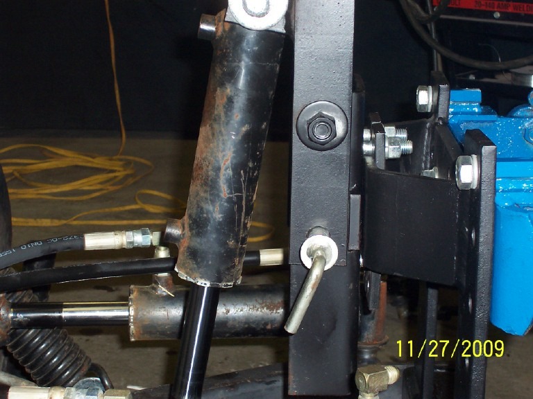

I think I have every thing figured out. I have everything in place just not tightened up.I still have a little fabricating to do. I do have 1 extra piece but I think that is because this was bought for a cub and I am putting it on a Ford. This is a verry well designed blade. I do have 1 more question. The lift cyl has 2 pins on the upper mounting plate. If you remove the lower pin it allows the blade to float and still alows you to raise the blade. With both pins in you have the ability to use down pressure. The control valve that came with it doesn't have float. I am wondering if it would be easier to get a control valve with float so you wouldn't have to keep changing the pin.

Here are some pics. The 1st pic is of the lower brace that goes from the bottom of the mount back to the drawbar mount in the back. The second pic has both pins in locking it so you have down pressure. The 3rd and 4th are with the pin out allowing it to float. I did think about using my loader valve but it is mounted to the loader and is a PITA to remove the hoses. I also wanted to get away from the regen. I dont think the valve that came with the blade has it. ll I have left to do is hook up the hydraulics.

Excellent pictures, Now I understand that you FEL valve is attached to the loader and removed with it.
So, this blade came with a 2-spool valve? I would suggest a new joystick valve run your blade-and if your real ambitious you could make it work the loader and the blade and solve your regen problem forever.

I got it finished today! here are some pics.

Since there isn't any snow I took it out to play in the dirt! I was verry impressed. Even with a full blade you could angle it to put the dirt where you want it.The down pressure also helps you keep grade. It is like having a small dozer. The one thing that was really noticeable is how well you could see. Evan with the blade at full angle you could easily see both ends. I am going to replace the control valve. The control levers are so close together you can put your hand around both at the same time. It makes it hard to just grab one.

Looks great! You made pretty short work of that project.
Looks like a dozer, why can't you bend those levers to your liking instead of getting a whole new valve?
Still can't get over that plumbing set up for the angle cylinders, the way they are powered in opposite directions I see how you could angle full blade fulls of dirt.
