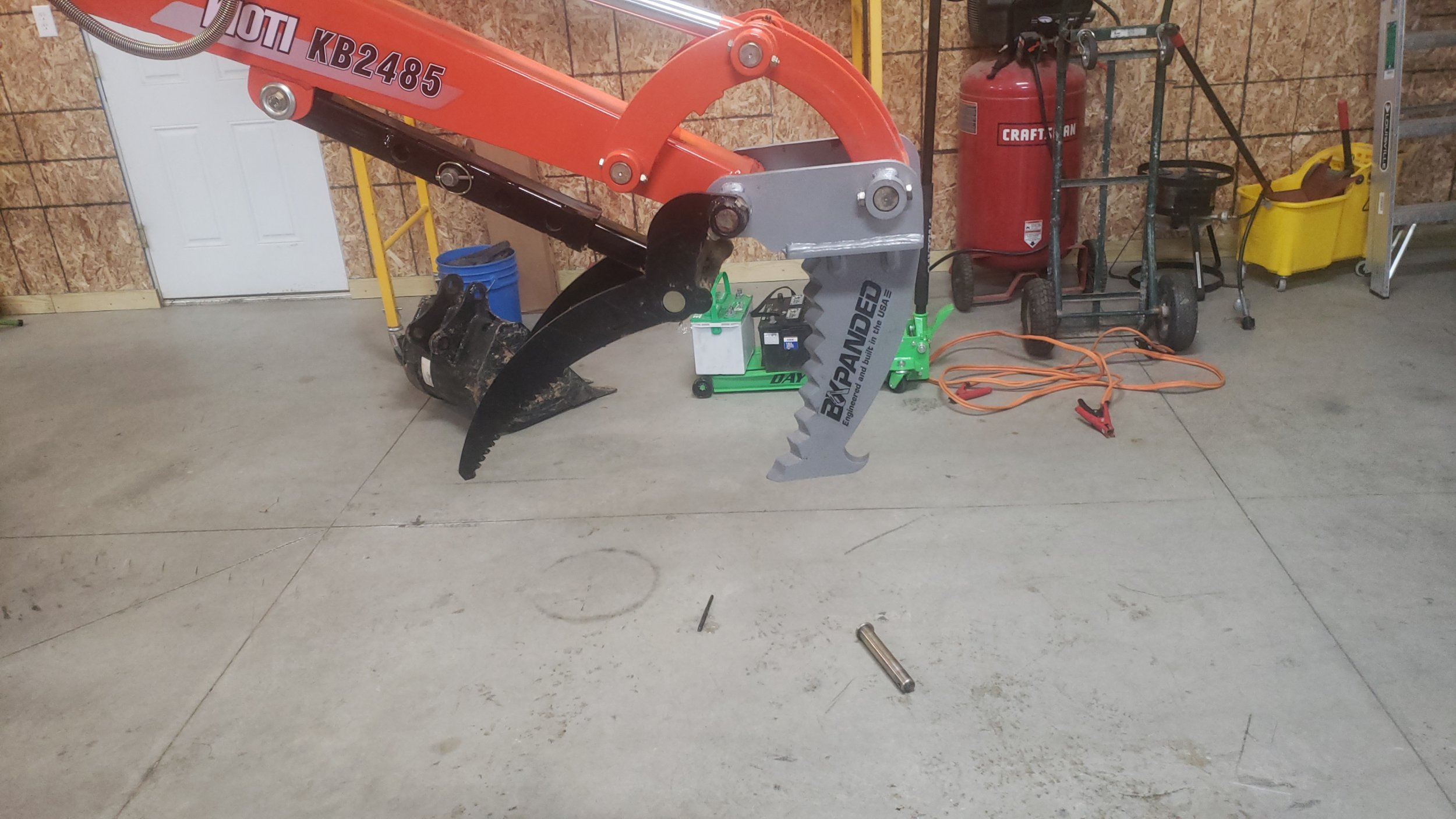

I had bxpanded make me a custom one I gave them all the measurements. My experience with this is your better off with a narrow bucket. You start digging and tearing stuff up you have no way of removing dirt. Found it faster and easier with narrow bucket

Thanks for the advice. I finally got the KB2485 backhoe. It came with an 18" bucket. The bucket moves a lot of dirt, but now I'm thinking about a very narrow but long bucket with serrated edges like you have there would be more useful. I think that the 18" bucket is not going to perform well when using a thumb, but I could be wrong.
