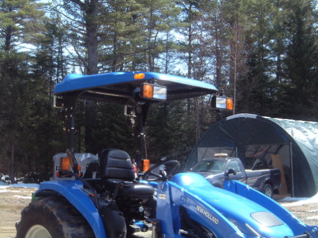

Oops, forgot to add the pic.

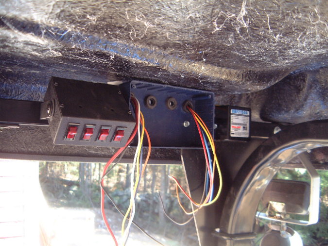

This picture shows the "light control center" in order of appearance
Switch's, junction box, Whelen flasher.

Mark,
Since we also have a '92 JD 970 with 2 55 watt Hobbs brand lights off the rear of the machine installed at the dealer when we bought it new I figured I should be good to go by using the same setup with different lights. They are going to draw the same amps so I figured I should be OK. I am using the same 2 connectors in back that will tie me into my factory switch. I had thought about putting a seperate switch somewhere but never gave it much consideration.
One question for you since you seem to know a fair amount about lights: On all these work lights I see I notice 2 wires coming out of the back. Is one a positive and one a ground? I ask this because the KC manual says that I can ground right to the mounting bracket but on our other tractor both 2 wires go into the factory harness same with a 990 I looked at in the shop with the factory rear light.

I'm an electronics engineering technologist by trade, so I'm pretty comfortable "pushing the envelope" without damaging anything.
I've never seen a factory wiring harness on any vehicle that had wires I consider heavy enough, so anything I add will be via some dedicated, fused wiring direct from the battery and using relays to handle the main current. Any switches (existing or ones I add) will just switch the relay coils.
Even if the lighting load is a bit more than the alternator can theoretically sustain indefinitely, and assuming the battery is in good condition, the worst that should happen is discharging the battery a bit. I'm going to replace the OEM battery with a yellow top Optima (deep cycle) as soon as I get the tractor, so I'm not too worried. A couple hours on the charger after a good session of night time work and everyone should be happy again. /forums/images/graemlins/smile.gif
If all else fails, I can buy a higher output alternator which Deere offers as an option for the 990.
Brad.

That alternator is like 400 bucks! I looked into it so I could buy 2 round KC lights at 100 W each.
   / KC lights finally ordered! #18
OUCH!! $400 US is, like, $50,000 Canadian! /forums/images/graemlins/smile.gif /forums/images/graemlins/tongue.gif
I wonder if an auto alternator could be fitted? Cheap from a wrecker, or even a "new" rebuilt.
Guess for now I'll stick with keeping the load under control.
Brad.

I have no idea. Maybe talk to your local autoparts store about doing that. I thought the kit would be cheaper but when I looked it up on JD parts it was way too expensive for me to buy so I just looked at smaller lights.
   / KC lights finally ordered! #20
Mark, Where did you get your "4 gang switchbox"? I need the same unit.
