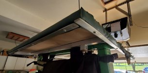

Can I ask .. is that carpet you are glassing over?
Yeah I was going to go to Joann's fabric and get some thinking spandex to soak down but had that outdoor carpet left over. It actually was better because it soaked up a lot of fiberglass resin. It's hard as a rock. Didn't even need to add the fiberglass sheets tbh

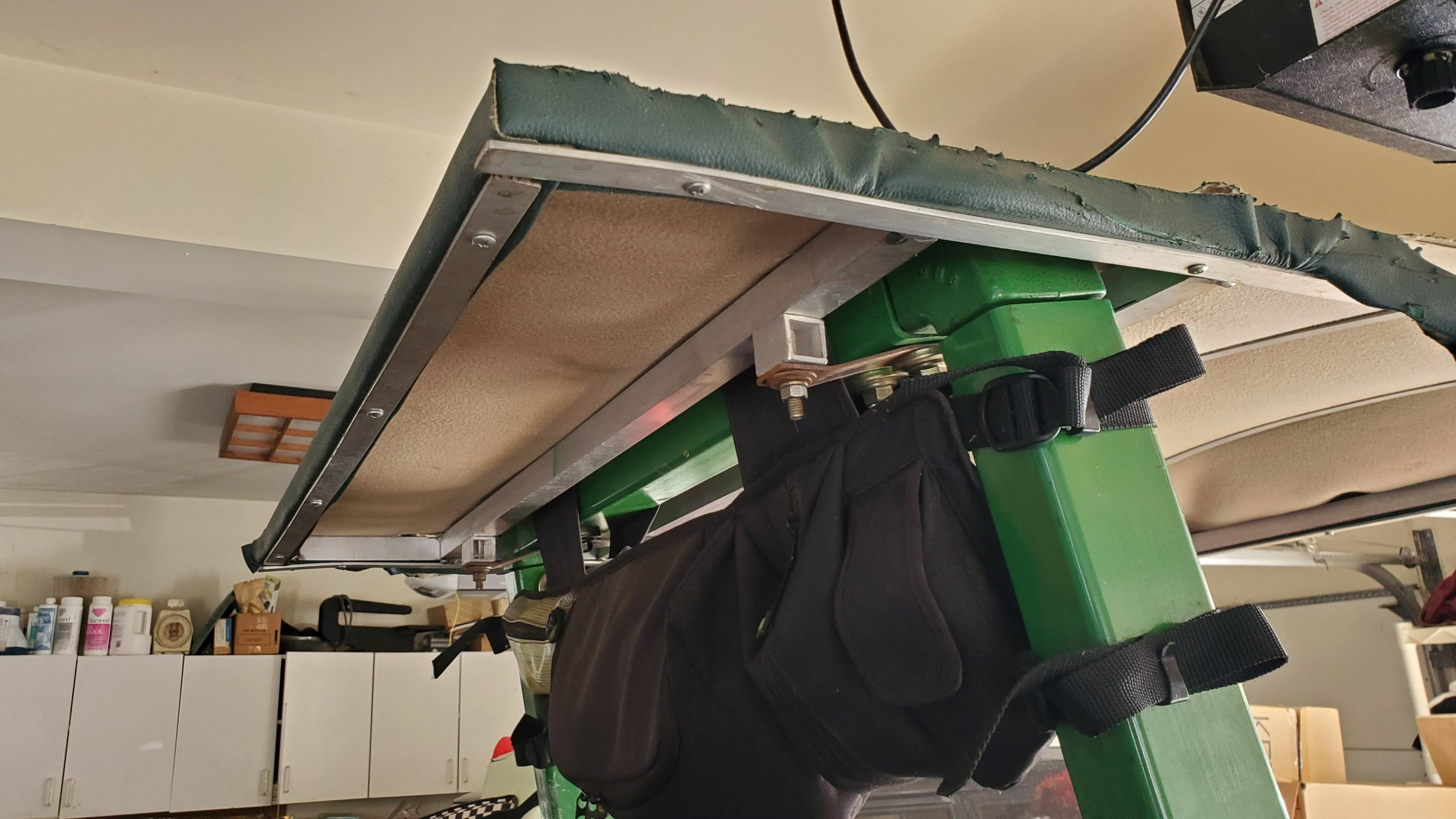

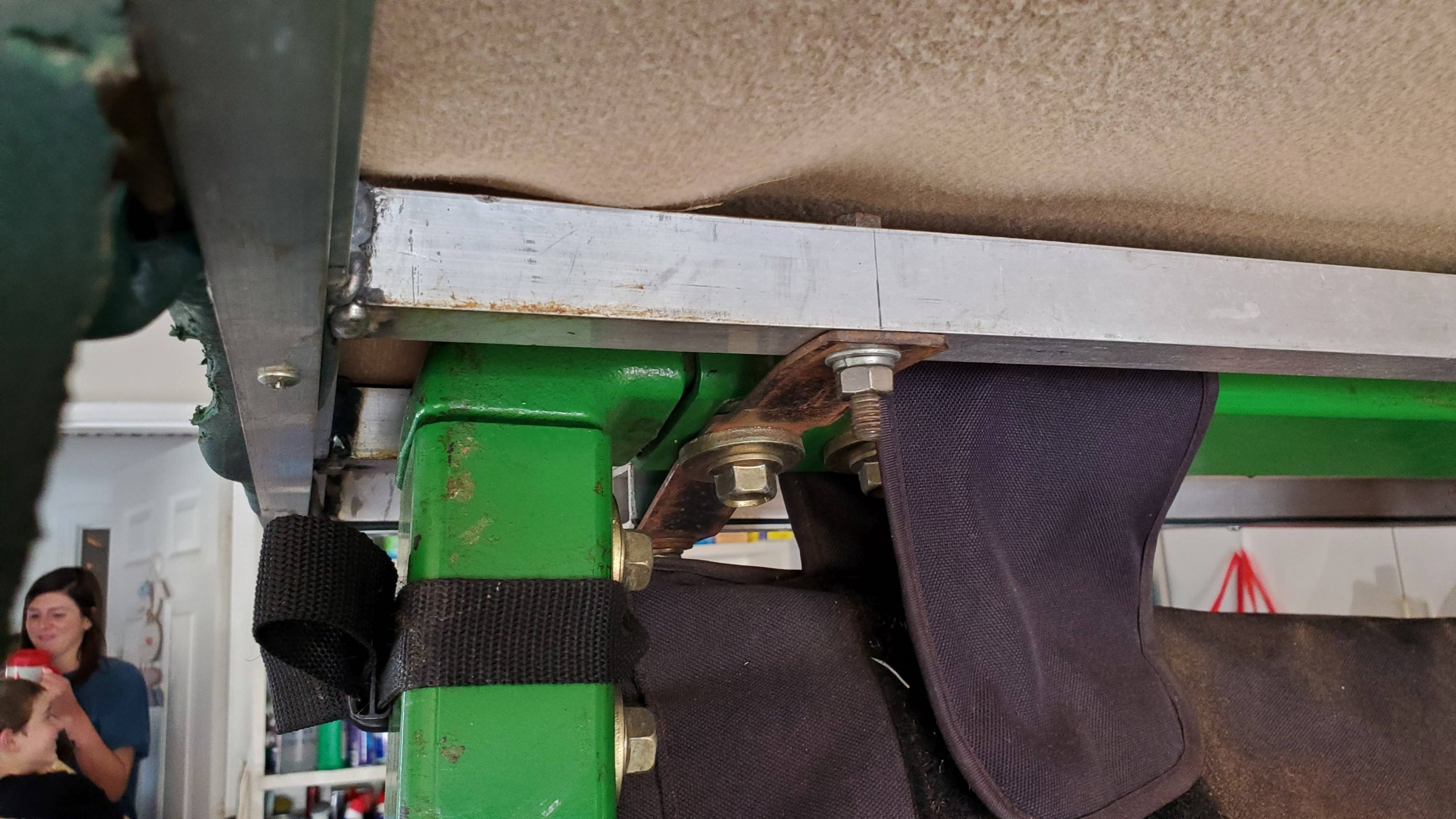

Fortunately, I was able to get some of the mounting legs from the golf cart, they ended up being the perfect angle to mount the canopy. I used some 2" square tube that is bolted to the ROPS, then the canopy mounts fit into them, secured with a couple of pins. These pics are the first mounting using just the u-bolts....
So far from what I've seen IMHO You have installed yours using the kiss method & it looks very professional & the color match is a nice touch:cool:! Thanks for sharing your Idea(y).

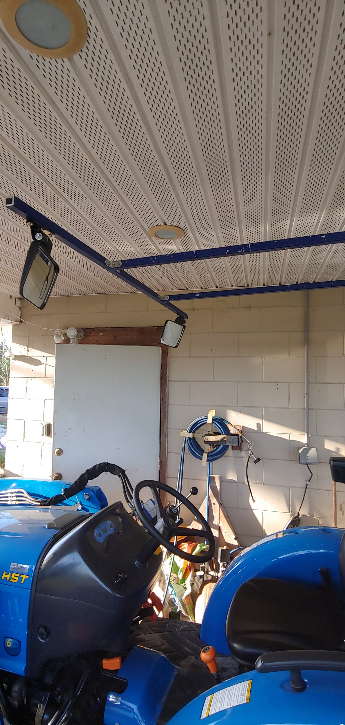

This is where I'm at with my install of the golf cart roof, & I hope to done next weekend :unsure: ? I'm just waiting on the wiring harness & a couple of extensions for the harness & 4 led lights & a black swivel antenna & I need to find a radio that can be left out under the canopy with a built in speaker & just AM-FM:cool:.
/ Custom Tractor Canopy #71
Looks good and sturdy can do!

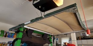

Did the Bondo and got 80 percent done this evening. Going to finish up in the morning. (work hasn't stopped and only been taking off Sundays and those days have been either with the family or at the property before all the rain)
Last weekend turned into a lot of flooded homes and businesses, I own a floor cleaning company and was doing water extractions and setting up flood equipment all week.
Hoping to spray it with bed liner tomorrow morning ( I'm not worried about smoothing out the Bondo perfectly) I'm ready to get this project done and installed

Raptor liner spray right now.
I don't care about making the Bondo smooth and level. Honestly should have just sprayed this over the cloth and it would have been better and just as hard with the hardener in it. Oh well.
I'm ready to get this over with and functional.
Definitely will need some extra supports to mount it
