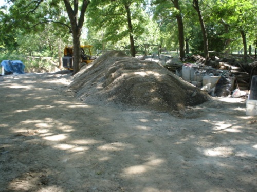

Aug 23, 2005 / Keeping character, or restoring a pond Thread Starter #222 OP W wroughtn_harv Super Member Joined May 12, 2002 Messages 6,092 Location Denison, Texas Tractor 2013 Volvo MC85C Last night the washout god blessed us with thirty plus yards of the good stuff. Attachments 720185-DSC01521.JPG 88.5 KB · Views: 369

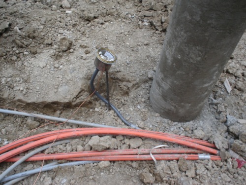

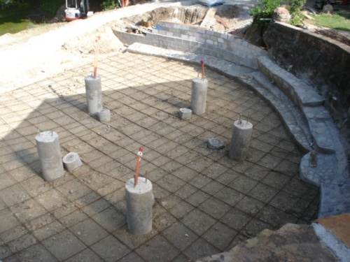

Aug 23, 2005 / Keeping character, or restoring a pond Thread Starter #223 OP W wroughtn_harv Super Member Joined May 12, 2002 Messages 6,092 Location Denison, Texas Tractor 2013 Volvo MC85C We're putting in niche lights to shine up from the floor to highlight the floating boulders. We have a number six bare ground tying all the lights together will all the rebar plus it's grounded via rods. We got lucky on the columns. Attachments 720188-DSC01525.JPG 88.5 KB · Views: 320

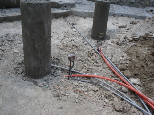

Aug 23, 2005 / Keeping character, or restoring a pond Thread Starter #224 OP W wroughtn_harv Super Member Joined May 12, 2002 Messages 6,092 Location Denison, Texas Tractor 2013 Volvo MC85C I think it will be a nice effect. Attachments 720191-DSC01527.JPG 83 KB · Views: 304

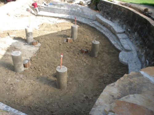

Aug 23, 2005 / Keeping character, or restoring a pond Thread Starter #225 OP W wroughtn_harv Super Member Joined May 12, 2002 Messages 6,092 Location Denison, Texas Tractor 2013 Volvo MC85C We didn't get as far as I'd hoped. But it was a good day. Tomorrow we'll finish filling in and doing grade and then we'll do the rebar. The floor will be six inches thick and it's a little over twelve hundred square feet. Attachments 720197-DSC01532.JPG 81.3 KB · Views: 306

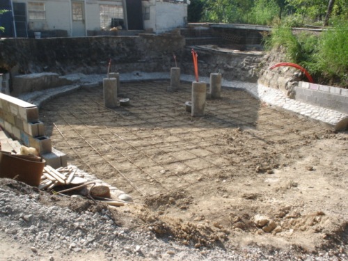

Aug 24, 2005 / Keeping character, or restoring a pond Thread Starter #228 OP W wroughtn_harv Super Member Joined May 12, 2002 Messages 6,092 Location Denison, Texas Tractor 2013 Volvo MC85C Here's a shot of the area to be poured tomorrow. We're looking west. Attachments 720951-DSC01554.JPG 85.1 KB · Views: 305
Aug 24, 2005 / Keeping character, or restoring a pond Thread Starter #229 OP W wroughtn_harv Super Member Joined May 12, 2002 Messages 6,092 Location Denison, Texas Tractor 2013 Volvo MC85C Looking south west Attachments 720953-DSC01555.JPG 81.2 KB · Views: 281

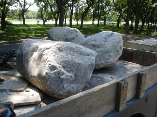

Aug 24, 2005 / Keeping character, or restoring a pond Thread Starter #230 OP W wroughtn_harv Super Member Joined May 12, 2002 Messages 6,092 Location Denison, Texas Tractor 2013 Volvo MC85C Look what I found today. /forums/images/graemlins/grin.gif Attachments 720954-DSC01537.JPG 81.2 KB · Views: 359
