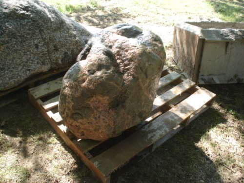

   / Keeping character, or restoring a pond
#232
That's "each" for those three rocks.
Now I'll bet you looked at that big ole girl and thought I was a sick puppy to want that dull bland looking puppy on this project.
Granite boulders share something with a t-shirt on a young lady.
Everything changes with the application of a little water. /forums/images/graemlins/blush.gif

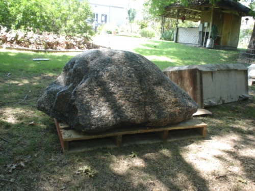

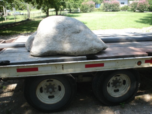

#233
This rock will have to be prepared for the column with a lot of TLC. It's got about four colors in it in layers and a lot of quartz.
It lacks perfect shape and consistant pattern.
We call that character.
Some have it.
It is it.

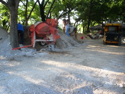

#234
Today we had what would have to be best described as a most excellent day.
We added four extra pairs of hands with strong backs to our mix.
They did the trick.
A little after eight this morning we started mixing cement, two mixers doing a dance with four partners.

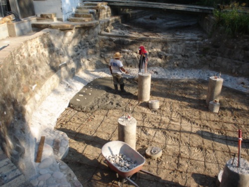

#235
A third of a yard at a time eventually adds up. But when you've only got about four or five of them down it looks like finish is only forever away.
#236
At noon we had fifty one or two mixer loads down so we broke for lunch. That's about seventeen cubic yards, mixed, poured, and spread.

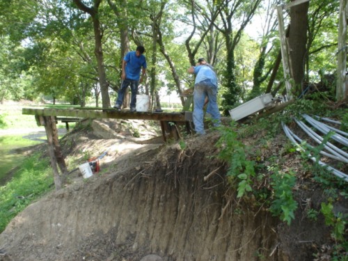

#237
After lunch I put three to work removing the old observation deck and three forming up the end beam of the pour.
Here's the deck crew.

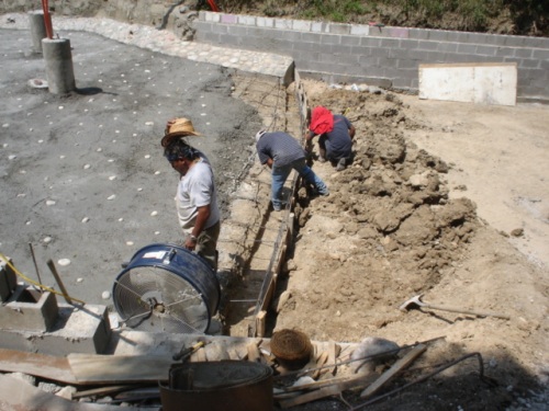

#238
The beam forming crew didn't have the shade. But they did have a fan.

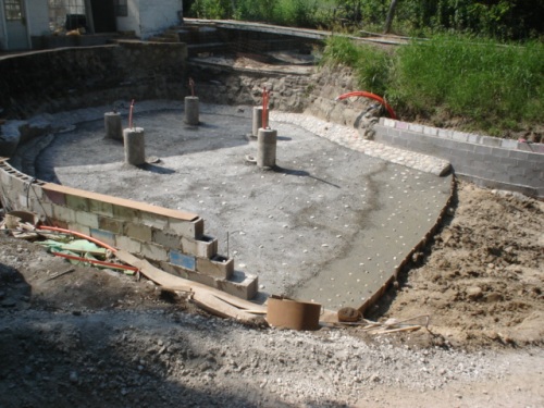

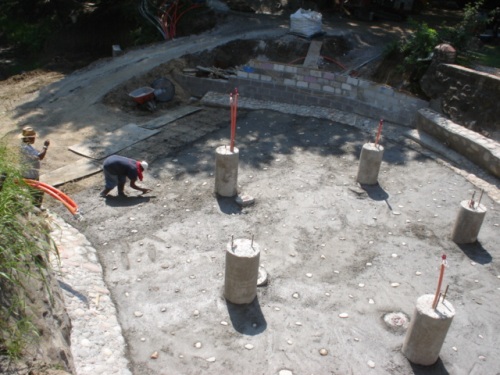

#239
At quiting time we had a pond with a concrete bottom.

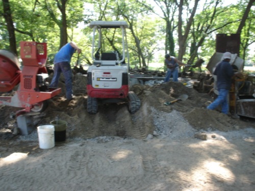

#240
If you get the chance to talk to an old folks that worked through the depression they'll tell you stories about hand shoveling ten fifteen yards of sand and or rock a day for next to nothing while being proud to have a job.
We ended up mixing twenty yards today.
It was a good day. No one fainted. No one quit. And I didn't see any evidence of hard feelings either.
In fact I had to back off the pace of the guys feeding the mixers to keep from wearing out the guys in the hole. I did this spontaneous water breaks and breaking their rhythm.
Once everyone realized where I was coming from the testosterone levels settled down a bit and the competition slowed. After all, four men working you're going to have at least sixteen competitions going on semitaneously.
One of the things I did to make it easier on the guys feeding the mixer was to move the mini-hoe in between them and keep a pile of freshly turned mix for them to handle. It's easier to load a mixer when the pile is at a certain height and the mix is of a certain rate of compaction. (almost none, compaction)
