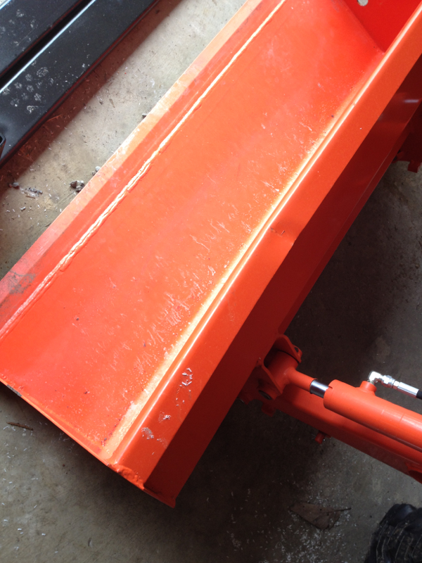

I got a chance to put it together last weekend, this is how it came out. I used a couple of Ken's mounting plates to put the shackle mount inside the bucket and the hook on the lower part of the back of the bucket. The shackle mounts on the top of the bucket lip are from Ken's too.

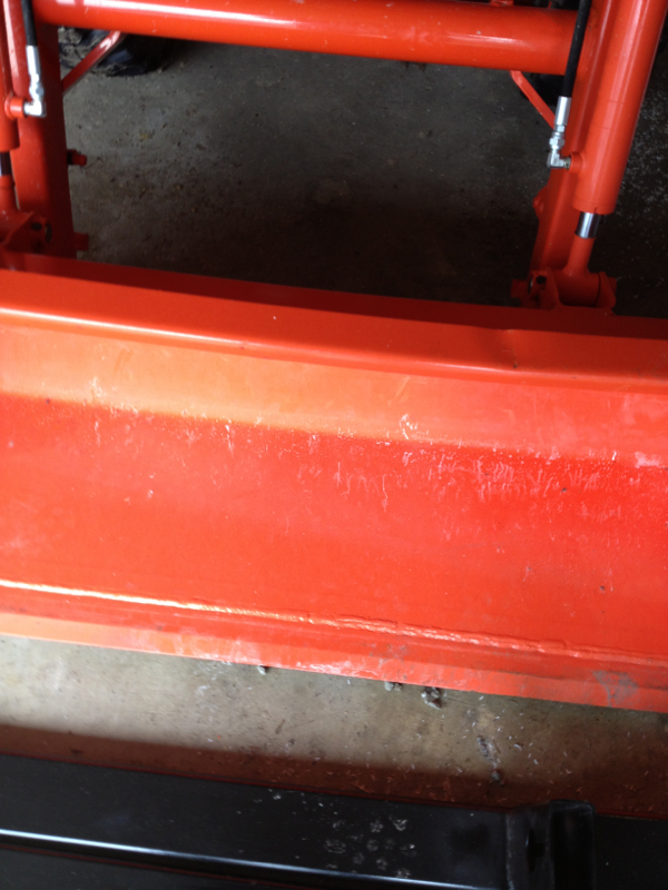

Here is my bent bucket. Any idea how to straighten it so I can see about mounting the hooks or should I just see if someone can weld angle iron on as it is?
You did an AWESOME job!!
Great job.
