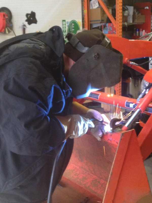

Just welded some hook on my L3800
   / ken's bolt on hooks on b3200 bucket #15
I have often wondered why hooks wouldn't just come standard?
Simple answer: Liability. No OEM offers them-even on large construction grade machines, and some dealers will not add them either.
