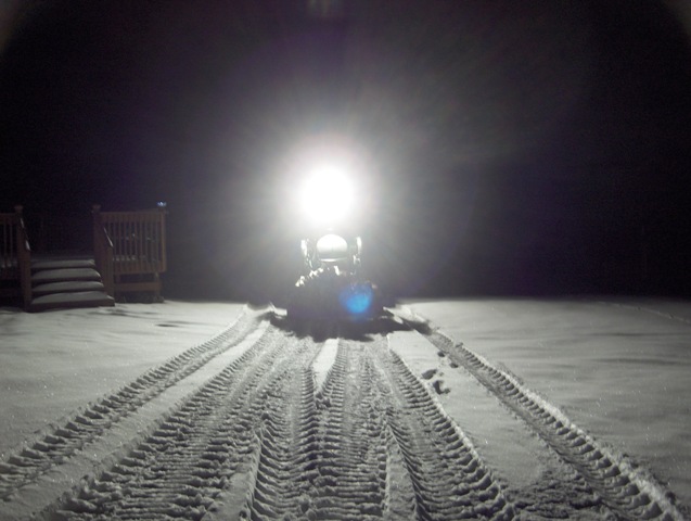

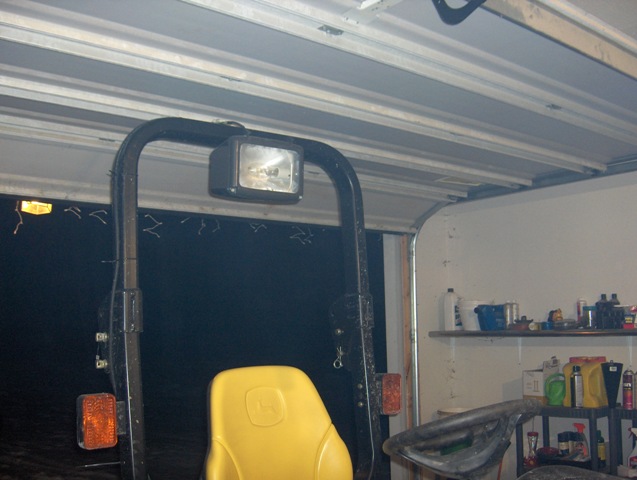

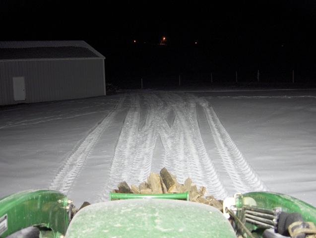

I wanted to share with everybody the light that I installed on my tractor back in the summer. It is a 175 watt metal halide flood light that runs off of a 400 watt inverter thats mounted under the hood. The light is extremely bright and will light up a large swath in front of the tractor. I have it mounted to the underside of the top of the rops and is only temporarily wired in due to the fact that I wasn't sure if the bulb would last. I mounted it back in July and mowed the grass a few times at 10:00 at night and have done numerous other jobs with it and it's still working good. The only drawback to the metal halides is that they take about 2 minutes to reach full brightness and will not fire back up immediately on a hot re-start but for the amount of light they throw it's worth it.

OK hot from the second picture you have already melted 1/2 the snow off your pole building:D Whats the deal...just open the barn door, turn the light on and the snow melts:rolleyes: Looks great. I hav e some lights on my tractor and a friend of mine added them to his skidsteer one night when he was feeding he spun around and hit a cow. Black cows at night.....so he put lights on his machine. Great job.

No, it wont burn your hair, I,m only 5'-10" and the rops is high enough that the light is well above your head. The light has a transformer in it that has multiple taps on it for 120, 240, and 277 volts. I don't have it fused yet as the inverter has an overload on it. Once I permanetly wire it in to a factory JD switch I will fuse everything neccessary. You should see the looks on the peoples faces driving by the house when I'm mowing late at night in the summer.:D

Wow, that last picture looks like something out of 2001 A Space Odyssey. Gotta wear shades when you're coming :cool:

The light itself only draws about 2 amps due to the transfomer in it that ramps up the voltage to fire the light so the inverter hardly draws anything to power the light. It will stay lit even if you shut the tractor off, but will kill the light when you go to re-start the tractor due to the starting system putting a load on the battery.

The 400 watt inverter that I bought from Pep Boys has the screw down lugs on it to wire it in.
