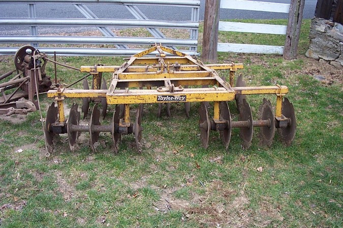

Afternoon Mike,
I dont think you would have any problem pulling that size disc with that much HP.
Some of KK equipment looks pretty descent and some looks a bit flimsy.
Last month my neighbor gave me this Taylor Way 7ft disc and the middle support that controls the agressiveness of the front gangs is cracked. Its just rectangular stock with evenly spaced holes to interchange the locking pin. Im thinking of cutting out that section and welding in a solid piece with the same hole pattern.
