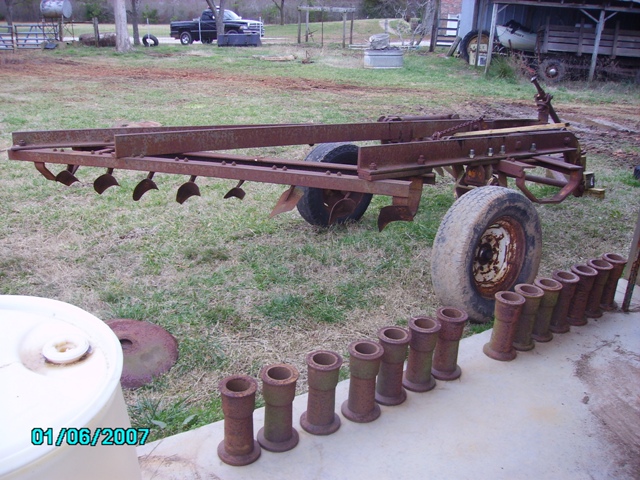

/ King Kutter heavy-duty disk #25
scotty I like your taylor way Too, here is a taylor way that I am working on.
