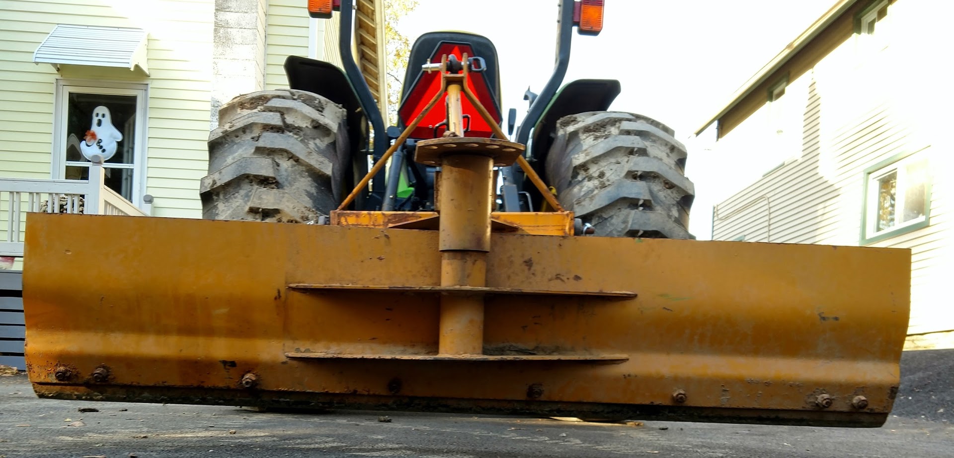

I thought my back blade was bent until I realized they welded the blade to the frame crooked!
I would have thought that you would have noticed that before you used it and taken it back.
/ King Kutter Quality #4
I bought a box blade from tsc once, got it home before i noticed broken welds. Took it right back, never bought one again. Cant remember what i was going to use it for now.
/ King Kutter Quality #5
I think I would take that back regardless of use. That is unacceptable.
/ King Kutter Quality #7
Maybe the OP bought it new??? Maybe he is just now noticing?
But to me....that looks like a used POS blade someone picked up on c-list for $100 or less

Agreed!
That Blade has been around somewhere for a VERY long time!
Look at the rust!
No one noticed the alignment issue until now?
I had a very minor fabrication issue with my new KK tiller.
I called, and they sent me free replacement parts.
I had a minor issue with their new blade also, but I fixed it myself.
From my experience their quality control is somewhat lacking, but their attachments are rock solid.
Their paint adhesion is TERRIBLE!
NO acid wash, and NO primer!

Your back blade welds do seem to be a bit crooked. I would not be happy. That said, you can just adjust the three point arm and your good.

What he said.Minimally, contact the manufacturer and send them pics.
I contacted King Kutter and sent them pictures. They never even sent me a reply.

This looks like a Monday morning weld. :D
After a hard weekend. I've have a King Kutter rototiller for about 10 years now. No complaints with that.
I'll cut the blade off and weld it back on straight. Not a huge problem, I just think a "sorry, we'll try harder next time" from King Kutter wouldn't have been too much to ask. Shi.. err stuff happens. Acknowledge it and move on. At least if you want me to give you my hard earned money. If your company doesn't care about me, there are far too many that do for me to waste my time and money on those who don't.
Yeah that is pretty sad customer service. You might want to try to elevate your complaint at King Kutter. If I was running the company, I sure would want to know. How old is it?
/ King Kutter Quality #19
I might be wrong, but I kind of know a thing or two about ag manufacturing. Can't say how kk does things. Alot of stuff is set up in jigs and then welded. I wonder if a new guy or a guy that didn't build blades normally got all screwed up when he set it up in the jig. No matter what happened, it should not have made it out the door. When I ordered my kk brush hog, the sent me the wrong pto shaft. I called a king kutter place I think it was in Alabama. Spoke to a customer service guy and they sent the right pto shaft. I said what do I do with the one that don't fit??? He said keep it. I think if you got the right person on the phone the work with you to get things right.
