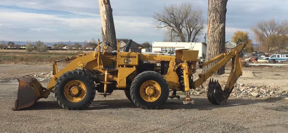

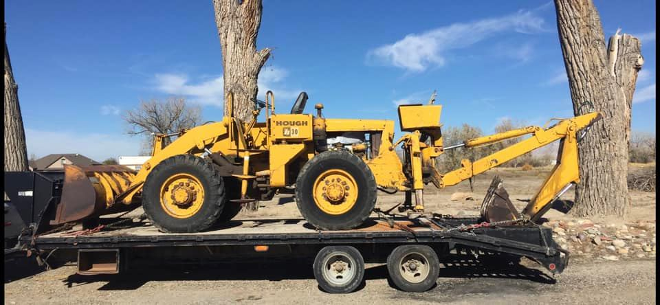

If you were going to use a tractor to build a loader this is how to solve the inherent design flaws. View attachment 730005
In a sea of people leashing cable-actuated loaders to tractors in the 1920s, Hough was the first to make dedicated hydraulic wheel loaders. This was the start and they went on to range up to huge open-pit monsters. Even so back in the day, Hough recognized the difference between lifting and carrying capacities.
