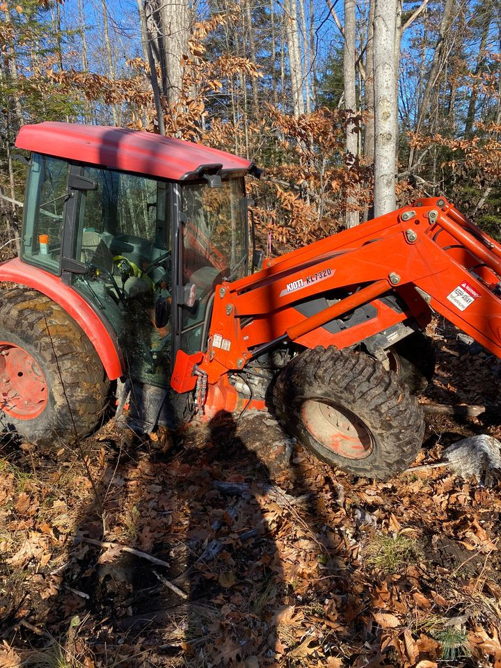

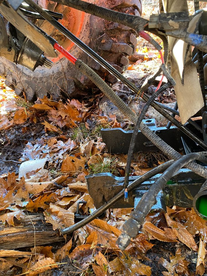

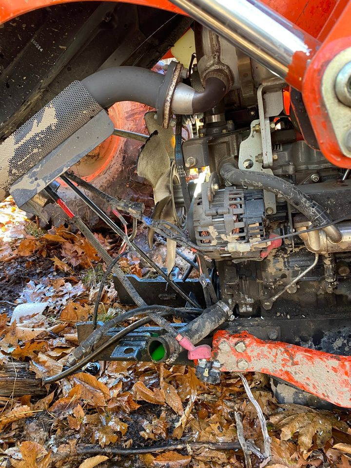

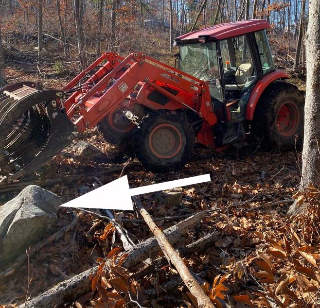

Tough to tell from the pics, but it almost looked to me that the frame had been previously welded where it broke in half.
Not sure, but the frame at the point of separation is far less structurally sound than about 2' back.

That's bad, it really makes you wonder what took place for this to happen. Wish we knew the entire story/history of this disaster.

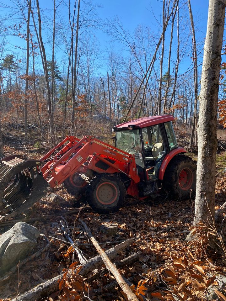

Wow! First time I ever see this type damage. I have no idea how this happened. I do see huge boulders half buried in the ground all around the area. Hitting them consistently at speed with heavy loads, may create repetitive stress fractures and metal fatigue leading ultimately to metal failure. It's still under warranty. It should be interesting to know what Kioti thinks and if possible abuse was considered.

Looking at the terrain, I wonder if the front axle was constantly banging side to side against its stops. Pivoting as far as it could and slamming into the frame/stops with heavy loads constantly I could see something like that happening.
I hate not knowing more to the story, what happened, was dealer contacted, what they said, etc etc.

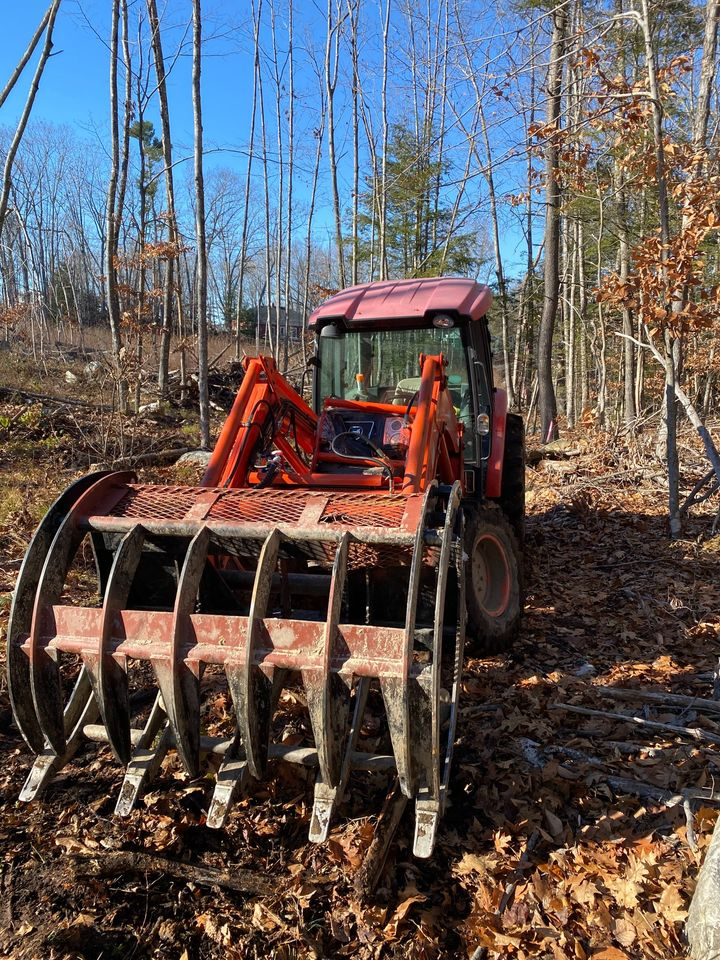

Bottom line is, it's junk. Looks to me like gross abuse. I cannot imagine getting it out of the woods either.

Funny how the front is clean and glossy and the back is faded and dirty.
