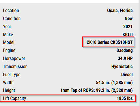

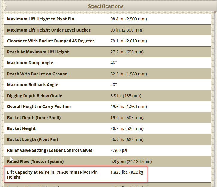

This example does not fit this model that broke in half but to illustrate how company mislead technically with the truth, and yet misleading. See the pic below Lift Capacity 1835. It uses the KL4030 You figure that it's the Lift Capacity to Full Height at Pivot Pins. which would be 98.4" in case of this loader. Not so. See second pic. It's Lift Capacity at 59.84 in. (1,520 mm) Pivot Pin. It does not tell you what the Lift Capacity to Full Height at Pivot Pins. I'm guessing read the manual on loading you would find out. You know it's going to be less 1835lbs. Of course if you the Loader model KL4010 which fits the same unit is the does the full 1835lbs.
