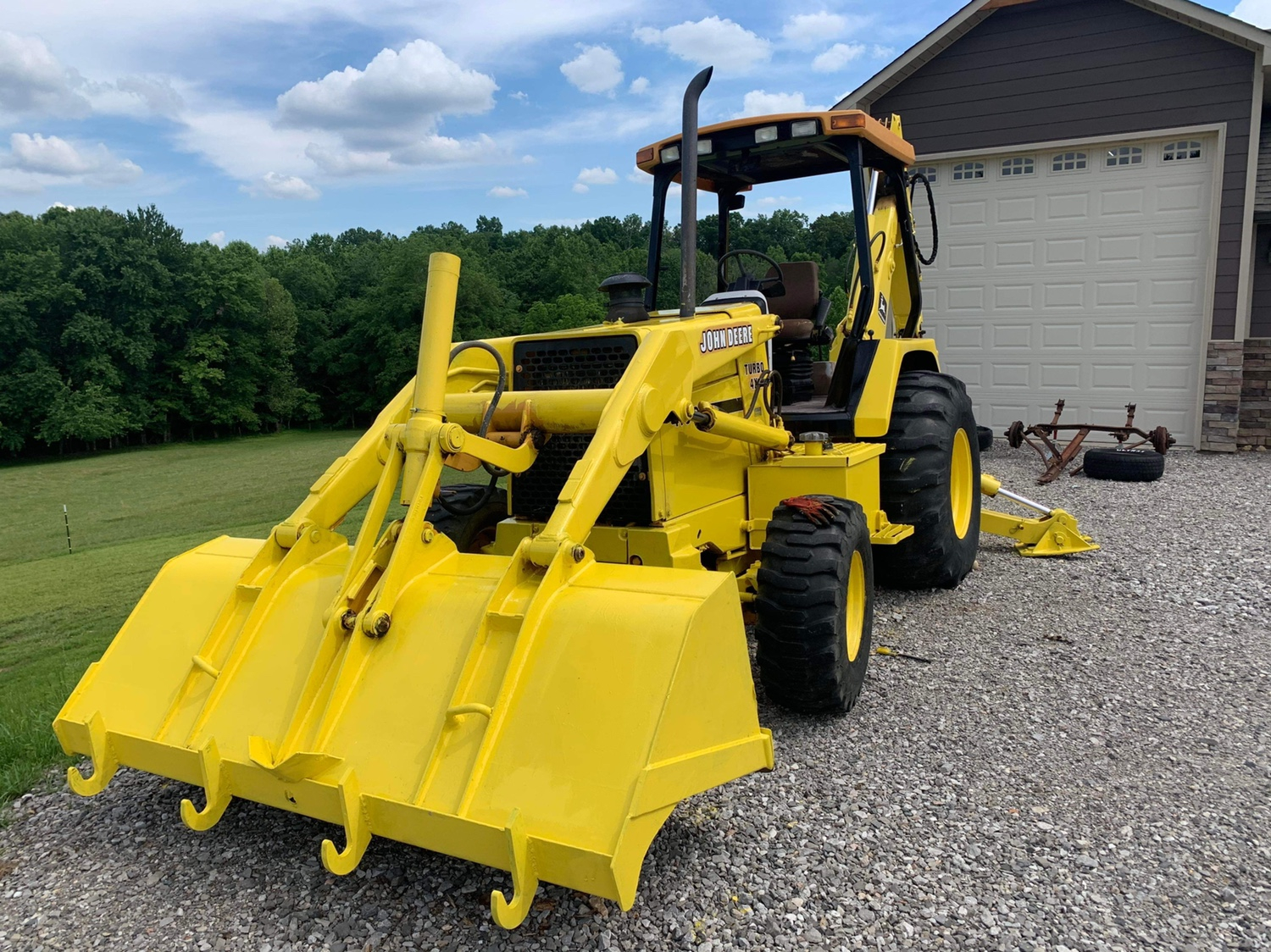

My backhoe that’s designed a bit more robust with a price tag to match has a frame that runs the entire length of the machine. That’s really how all tractors that are claimed backhoe/loader capable should be designed.

A full size backhoe still isn’t an optimally designed loader platform but they were built with durability in mind. They also don’t go around bending the curl cylinder every time you miss treat it. You don’t see them with busted front ends either. I won’t say it doesn’t exist but mine is rated for 54,000 pounds static load rating and has a planetary reduction on it. I’m sure it’s possible but I’ve never seen a stripped backhoe front end. There’s dozens of tractor front end failures in this site alone. I’ve never seen one for sale locally or I might own it but I wouldn’t mind having a Deere 210 with a Gannon blade with hydraulic tilt, hydraulic toplink and hydraulic rippers.

My backhoe that’s designed a bit more robust with a price tag to match has a frame that runs the entire length of the machine. That’s really how all tractors that are claimed backhoe/loader capable should be designed. View attachment 730007
Apples and oranges, one is a dedicated industrial tool, the other is a farm machine engineered to do a host of tasks your backhoe can't do. Can your backhoe detach it's loader and mount a snow blower? Tractors are designed to easily do that. But like I said, we are talking apples and oranges.
Nice looking machine though.
