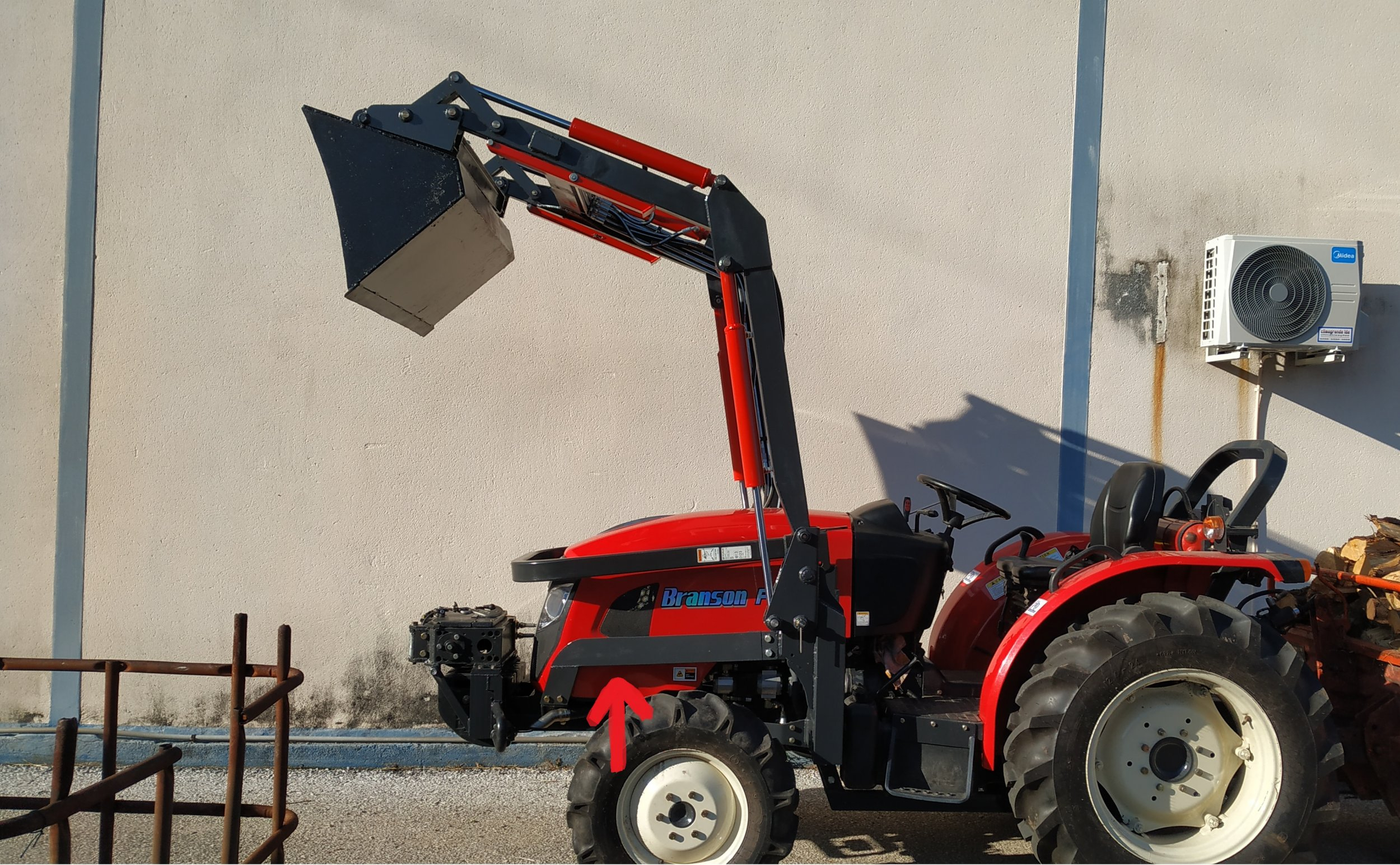

The only design process going on between the loaders and tractors is to reduce the materials used and squeeze every living bit of strength out of those materials so they can still sell expensive while spending less money building the tractors and loaders.
Why do you think they got rid of those upper support bars going to the front of the tractor just like the older tractors had? It's not for ease of maintenance. It's for cost savings. Those bars add a lot of strength to the loader frame and tractor by spreading the stresses through other areas. Removing this, will concentrating everything on a single point between the front axle and the front bolts of the loader mounts.
By the way, for those all triggered about me saying that tractors were not meant to have loaders on, doesn't really mean they can't use them but doesn't make them designed to have loaders either just because the manufacturers put them on. Use and abuse it, just don't complain later if something pops. You can also use 3 pt backhoes, no one is forbidding you, but we all know what happens with a little bit of abuse.
And I'm still waiting for some of these triggered guys to answer the question on what exactly did the manufacturers change on the tractors to make them designed for the loader? Removing the front weights? (while increasing the price). Incorporate the loader valve on the tractor? That won't help much with strength.
Haha, No one is triggered, just trying to get it into your brain that these CUTs are indeed specifically engineered with front loader use in mind.
However you make some good points and I'm glad you seem willing to die on this hill so that we can have a good debate!
I don't specifically KNOW what manufacturers have done design-wise to better incorporate a front loader. But I can surmise the following: Modern computer aided design and analysis have enabled a better understanding of design strength and durability in general. So those fancy "bars to the front" of the tractor you keep mentioning - well, you simply do not need them anymore. Because we can easily make a loader mount that is just as strong and rigid, with intelligent design at the mid point of the tractor and loader mounts. It's not like we see loader mounts getting ripped off the frame all the time.
Decades of experience observing front axle failures develops a good understanding of how robust the internal components truly need to be. Again, CAD/FEA are our main tools to dial these components in, as robust as needed, but not more - to provide value to the customer.
Front axles might be the same general design, with ball bearings - but they can be made bigger and more durable.
Some of the intelligent changes you proposed to improve tractor design and durability would essentially DOUBLE the cost of the machine, meaning almost none would be sold. That's not a win for anyone. I know tractors are probably already quite expensive in Portugal, so maybe it seems warranted to you. But in the US you can still get a 35 HP, 4WD machine with PTO that lifts nearly 2000lbs on the loader and 2000+ on the 3-pt, for under $20,000 USD, which is a terrific value (at least, until covid. Now ~10-20% more).
