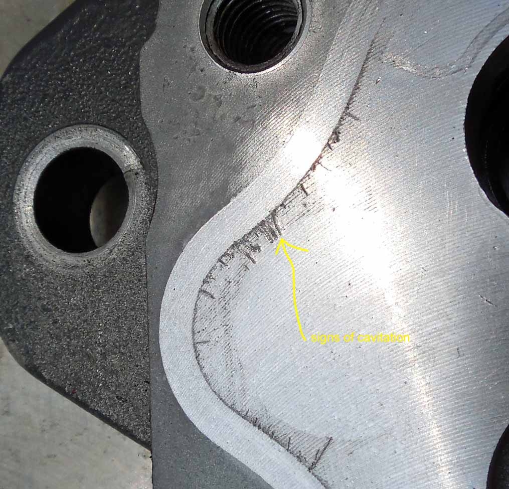

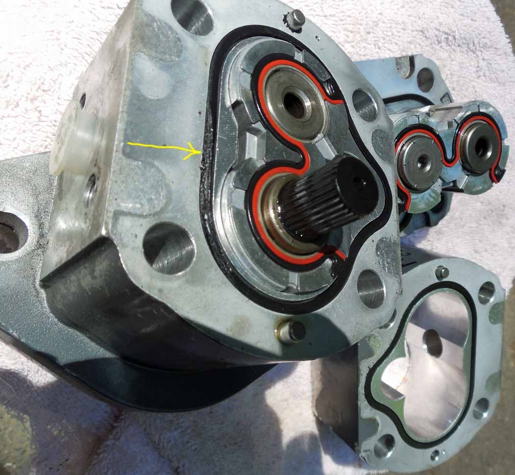

Took the pump off today, and found the previous owner has stripped two of the 4 bolts holding the pump together. So looks like my options are to either A)get a seal kit and helicoil the two holes or B)Find a new pump.
I ordered the ebay pump and it came in today, but it is not the correct pump. It has the same holes for mounting but the pump itself is longer and it seems the splines are different than the pump that was on it.
It is the original Casappa pump if anyone has a lead on one for a reasonable price.
   / Kioti CK25 Low Hydraulic Pressure #14
Both your original pump and the eBay pump are Cassappa brand?
Since you have taken your original apart, look at the seals and pressure chambers really closely to evaluate condition. Even if you have signs of cavitation, your pump may be rebuildable. When the outer O-rings get damaged, then no amount of tightening of the bolts will help.
I think I had a thread about rebuilding this pump.
