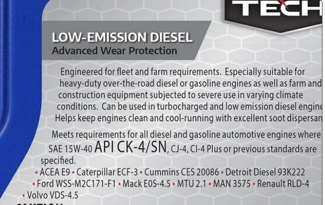

I don't get too wound up on oil brand names and over the years have no brand loyalty.
I just go with the latest API (American Petroleum Institute) diesel engine rating which currently is CK-4. The last rating CJ-4 is good too.
I most often buy Walmart 15W40 SuperTec when it is on sale and if you look on the back it is API rated CK-4.
For better or worse I just go with the least expensive with the most recent API rating and change out more frequently. Since my little machine only needs ~3.5 litres I go with no more than 40 to 50hours or 6months - which ever comes first and is convenient timing (got nothing else pressing on the go).
Hard to go wrong with changing out more frequently.
