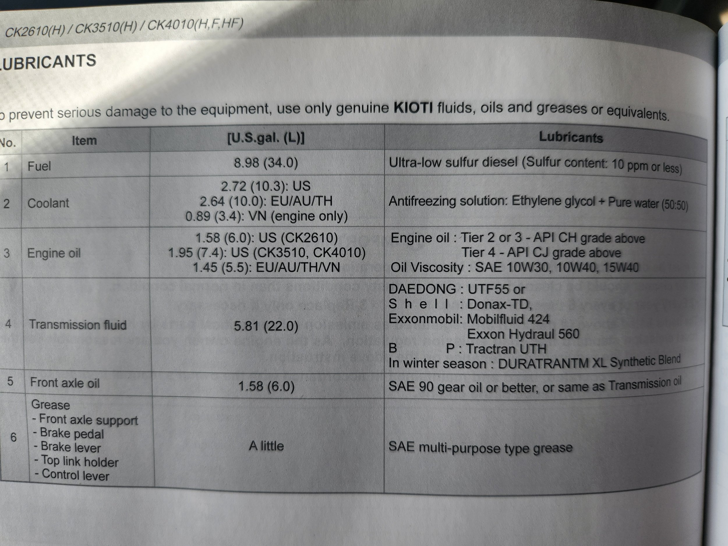

My dealer suggested Shell to save some money; here is the lubricant page for the CK-10 series.
/ KIOTI CK2610 fluid advice #7
Just a quick glance at the manual page tells me a couple of things;
One, i'm using better oil then the manual calls for it'll be T6 5w-40.
Two, the last line on hydraulic fluids calling for a synthetic blend as a minimum in winter weather.
One thing many people don't realize is that the listed fluids are all the "minimum" recommended fluids.

Oh, to Our OP, when you drain your front axles, you Will scratch your head, it calls for 90W gear oil, why is there a clear 30W type fluid in here, and you might start second guessing if you miss read something; it comes with a light, break in fluid in the front axles; which Is intended to be replaced with the 90W gear oil.

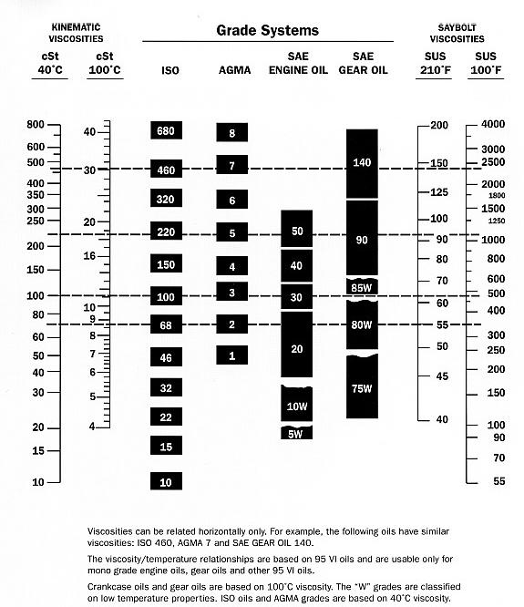

Here is an interesting chart to make you really scratch your head,
when you look at 30 weight motor oil compare to 85 weight gear lube.
Where did you get the info it's breakin oil ? It's trans hydraulic and can be replaced with trans hydraulic. Some seem to think gear oil is better I prefer the trans oil .
/ KIOTI CK2610 fluid advice #11
Well, I could 100% be repeating bad info seen on several videos and from sevwral people; but the manual does specially say 85 gear oil; and makes no mention of a hydralic fluid being an option.
/ KIOTI CK2610 fluid advice #12
Book says '90w gear oil **or same as Transmission**' ie, the Mobil 424, etc..
/ KIOTI CK2610 fluid advice #13
Interesting, I'll check this evening. I have however seen several people who suggest early swap at 25/50 to gear oil. Now, they might be wrong, and if I remember right, book only calls for the fluid change at like 200?
@tacticalturnip posted a shot of the book a few posts back
/ KIOTI CK2610 fluid advice #15
Yeah, I saw that, but im gonna check my book as well, not that I dont believe it, but still gonna look. Also, there are several folks on YouTube that have talked about early replacement of the axle oil, to get that out and switch to gear oil. I'm no petrochemical engineer or lubeatologist

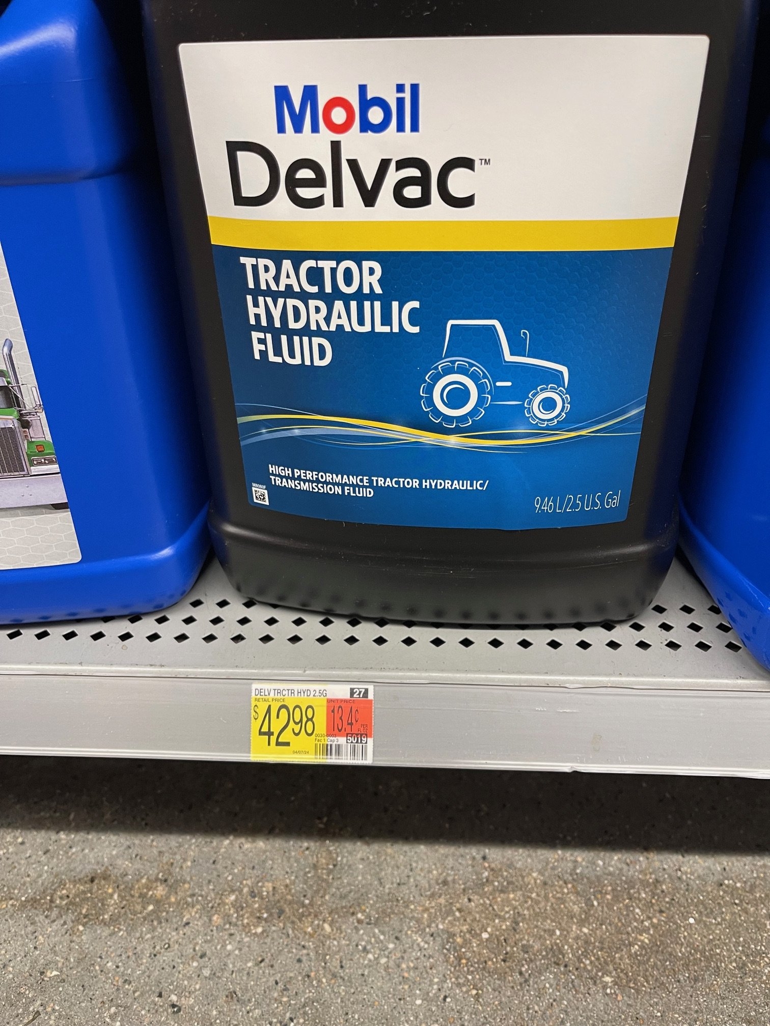

Walmart sells the recommended fluid.
/ KIOTI CK2610 fluid advice #17
Yep, glad you shared that. Although Kioti doesn't list it this way, my understanding was anything that meets JD20C will work, and Napa/Travellers/whatever often list the JD and Agco specs.
/ KIOTI CK2610 fluid advice #18
Yep, Kubota udt and JD20c are on the label. AGCO, cnh and Massey too? Must be magical stuff 😋
