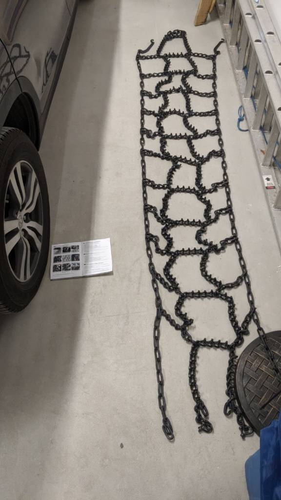

I'm still waiting for my tractor delivery, maybe today. But I picked up the chains from Windy Ridge on Monday. Based on my measurements at the dealer and measuring the actual chains, I should be fine. The chains are OFA8 studded on the rears and a bit lighter, diamond pattern chain for the fronts, with the same stud type.
Rears pictured.... View attachment 628583
I don't run any in the front and have never had a problem.
P.S. I'm up in Bartlett.

Well it seems there痴 a lot of us Kioti 2610 folks in the area I知 in Sanbornton . I知 planning on going to windy ridge this afternoon and pick up the chains. I measured this morning and got 1-3/4 as the tightest clearance. This seems pretty tight , is this what you have for clearance? Also to double check I have the R-4痴 Size 15-19.5

It's tight, but by no means too tight. As I mentioned previously, I put in about 150 hours in last winter blowing snow and pulling logs out of the woods with this setup (2610, loaded R4's, Eko8 chains on rear) and never threw a chain or had anything catch due to tight clearance. I was rough on them too, my farm is on the side of a mountain and all the driveways I do are steep and gravel. I just put them back on 3 nights ago, and again, no problems. I get what all your 2610ers are worried, but it really isn't an issue.
