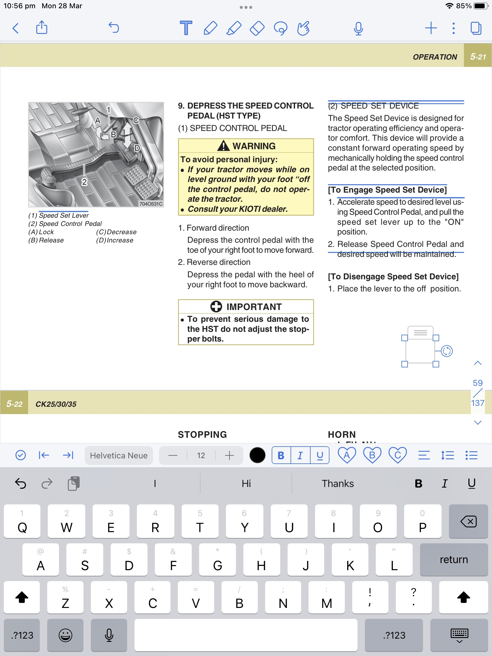

This is my first ever post so hopefully doing it right.
I’ve bought a 2014 CK35HST tractor with loader. Unfortunately the Yellow Speed Set lever (some call it cruise control) doesn’t seem to do anything.
I’ve checked the clearances mentioned in the manual and they seem ok.
Anybody got any ideas?

You are pushing it down to lock correct? As opposed to pulling it up to release… While holding it down take your foot off the pedal.

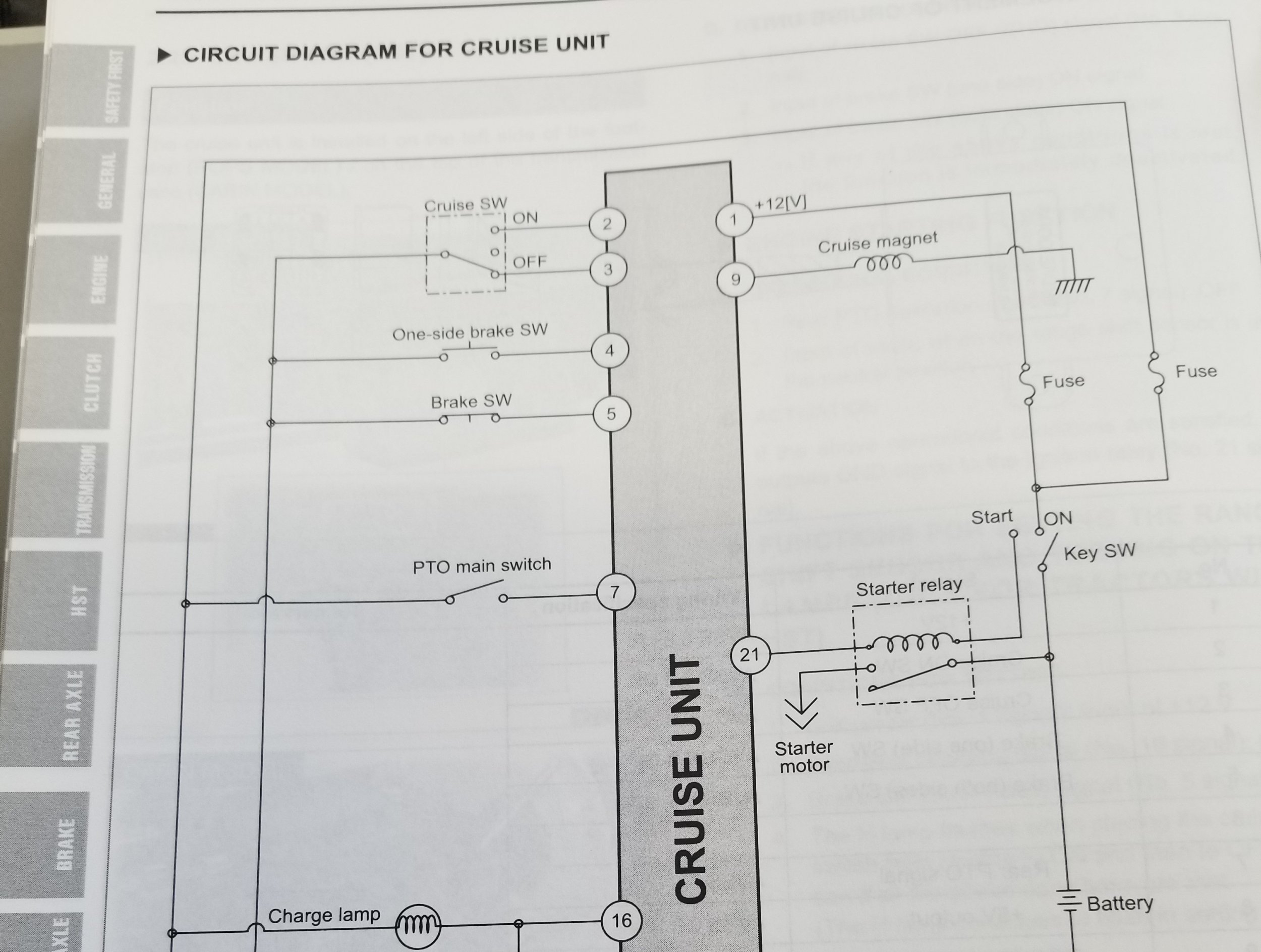

On my kioti DK45 a dash light comes on when i open the interconnect brake latch, and then the cc shuts off. Not sure your unit is the same. Its to prevent accidential use of one peddle braking while engaged in high speed roading of tractor while cruise is engaged.
heres a schematic on dk45. The brakes and the brake interlock switches both connect to cruise control module. Wire 4 is the one side brake switch, the interlock microswitch that signals when flip lever is open. A light on dash should also turn on.

The manual states get up to needed speed then to lift lever up to set speed. Nothing. Just stops when foot comes off pedal.
So tried the opposite ,starting with the lever up and pushing down at needed speed. Nothing. Just stops going forward when I take foot off pedal.
Brake interlock is on.
If someone could do a short video of the linkages as you operate your speed set I’d appreciate it.
Alternatively if someone has a manual that explains how the actual linkages work. I’d really appreciate that too.
