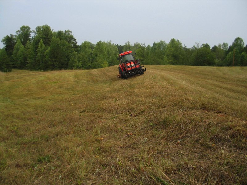

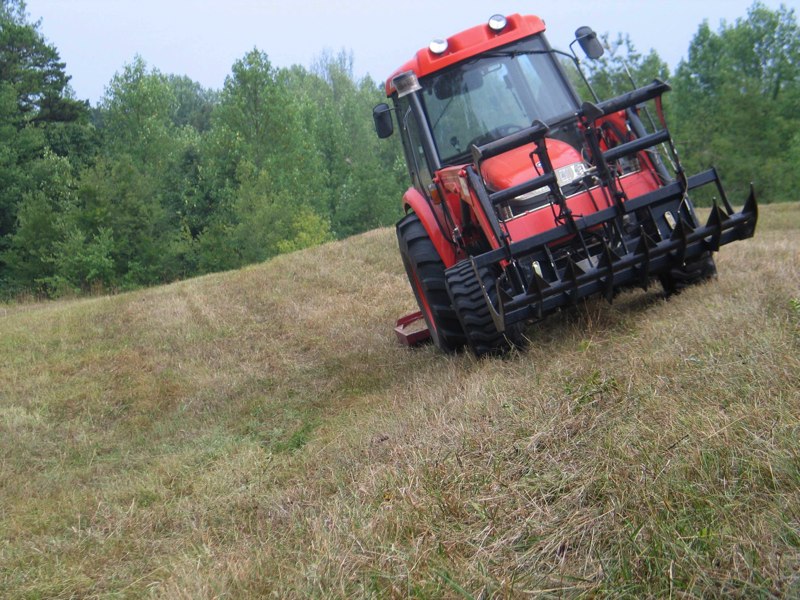

   / Kioti dk55 vs kubota l5030 #30
john_bud said:
. There is no company wide tendancy to tip over - not for Kubota, not for anyone.
I would agree as well. I can attest to the Kioti being pretty stable - I don't test it to the extreme but do find some challenging areas and areas I take an alternative approach to. We've got some intense terraces and you definitely have to be careful. Here is a moderate example. Also, my cab probably has a higher center of gravity.
