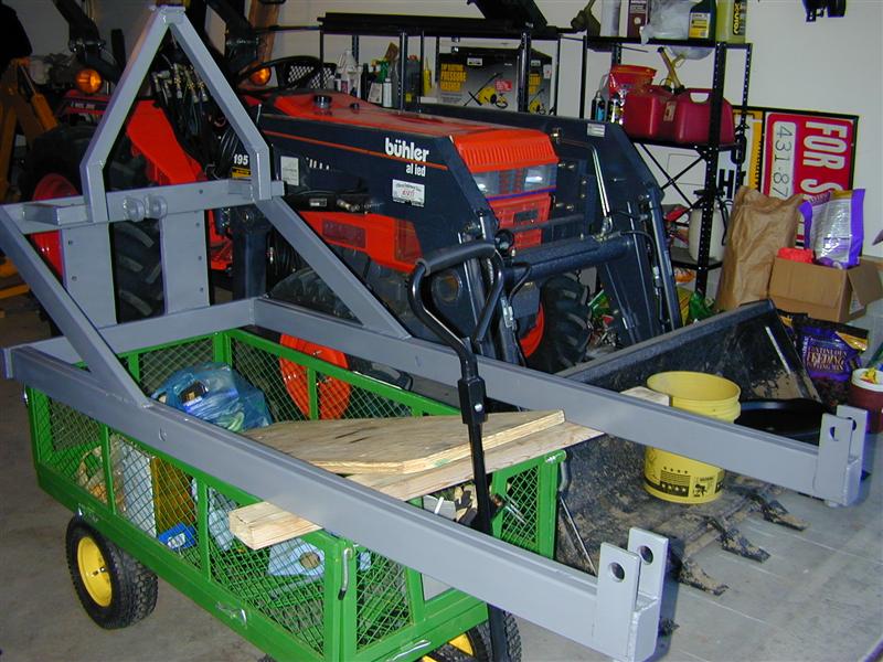

I made this subframe for my used backhoe I found. Regardless of what compact tractor I would not want to mount something like this hoe on the 3 point. Even with a fixed top link to hold it down on a 3 point setup there would be tremendous stress on the link arms. This thing will lift the back of the tractor up without much effort and my tires are filled.
Jim

That is a real nice job you did on that subframe.
Heavy duty and looks good.

Great job on that subframe Jim. I suppose you saved a lot of money getting the tractor backhoed. I saw the other post with the BH and it looks excellent. John
