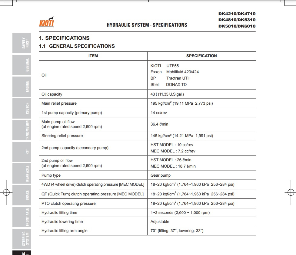

I can't find any such reference in my service manual. Seems they made it harder yet still since you posted this in 2016
Yours is a much newer tractor than mine.
Kioti's implement pump flow specs and pressure were hard to find in the past, and that seems to continue to be the case.
Is your manual a paper one, or PDF? I expect the DK4710 will still be somewhere in the range of 2500psi and 8.5 or so GPM. Others may chime in.
I went thru an implement pump rebuild for the 2nd of 2 CK30s I bought new in 2005. They had changed from a Cassappa to a Joyang pump, but only offered seal kits for the original Cassappa.

Kioti lists their flows and pressures on the hydraulic diagram in the service manuals.
   / Kioti hydraulic problem #15
I'll have to look again.
They also list it on the hydraulic specs page. Here is a print from the service manual for a DK4710.
