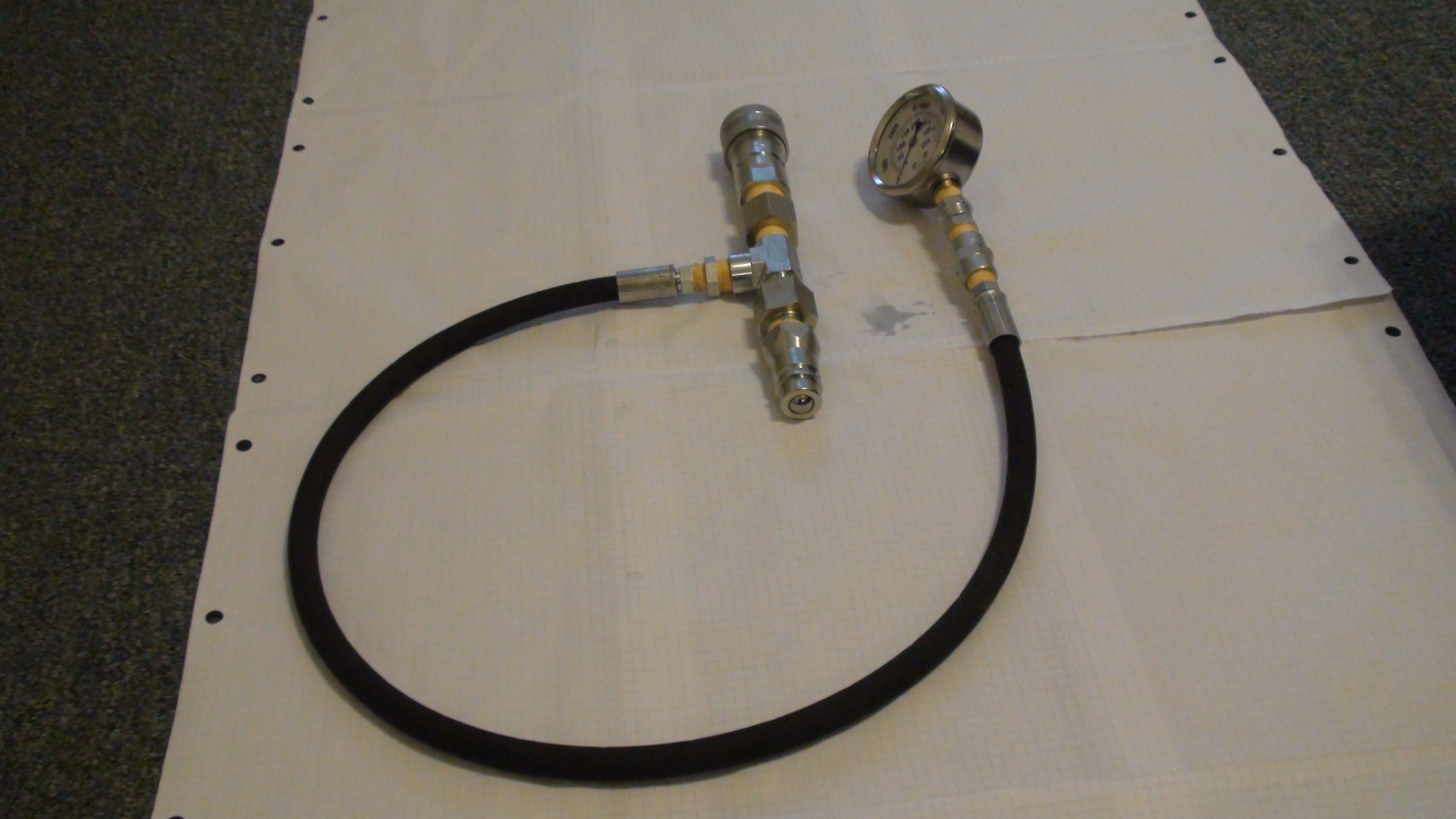

Here is what they are speaking of concerning a hydraulic pressure gauge, along with some helpful guides.
I built mine so it could be used as a Tee if necessary and have all of the various male and female QDs for any hydraulic connection on my tractor for troubleshooting. With this setup you should be able to eliminate/troubleshoot your issues down to a specific area. Plus adjust the pressure to specifications. Pressures are typically on the low side of specifications.
View attachment ports and connectors- thread_guide.pdf
View attachment qd_sizechart.pdf
As mentioned, you could simply be having an issue with a single coupler. Early on with my tractor's front hydraulics for the grapple, the grapple starting reacting very slowly, intermittently. Long story short after getting my dealer on the phone for a LONG troubleshooting call, and he getting the OEM for the front hydraulics on a three way call and with me doing the troubleshooting, the OEM was going to ship me a new hydraulic package for me to replace since I did not want to drive the 3.5 hours to the dealer.
As a last resort, the hydraulic OEM said to disconnect and reconnect all of the hydraulic QDs to the grapple, which I did and found the QD fitting that was causing the issue. All connections looked and felt secure but one was not seated correctly internally and could not be identified just by looking at it.
/ Kioti hydraulic problem #9
Thanks sdef. Theough inspiration from this forum, I have wanted to attach a hydraulic pressure gauge as my loader seems weak to me - no idea if it is operating to spec or not, but sometimes I go to lift something and I end up saying "Really - THAT is too heavy!" (The language is frequently more colourful). I just didn't figure out a good spot to tee-in and to mount a gauge. It may have been mentioned in other threads and I didn't get it - but your picture made it clear to me - I can easily build and connect a temporary gauge.
