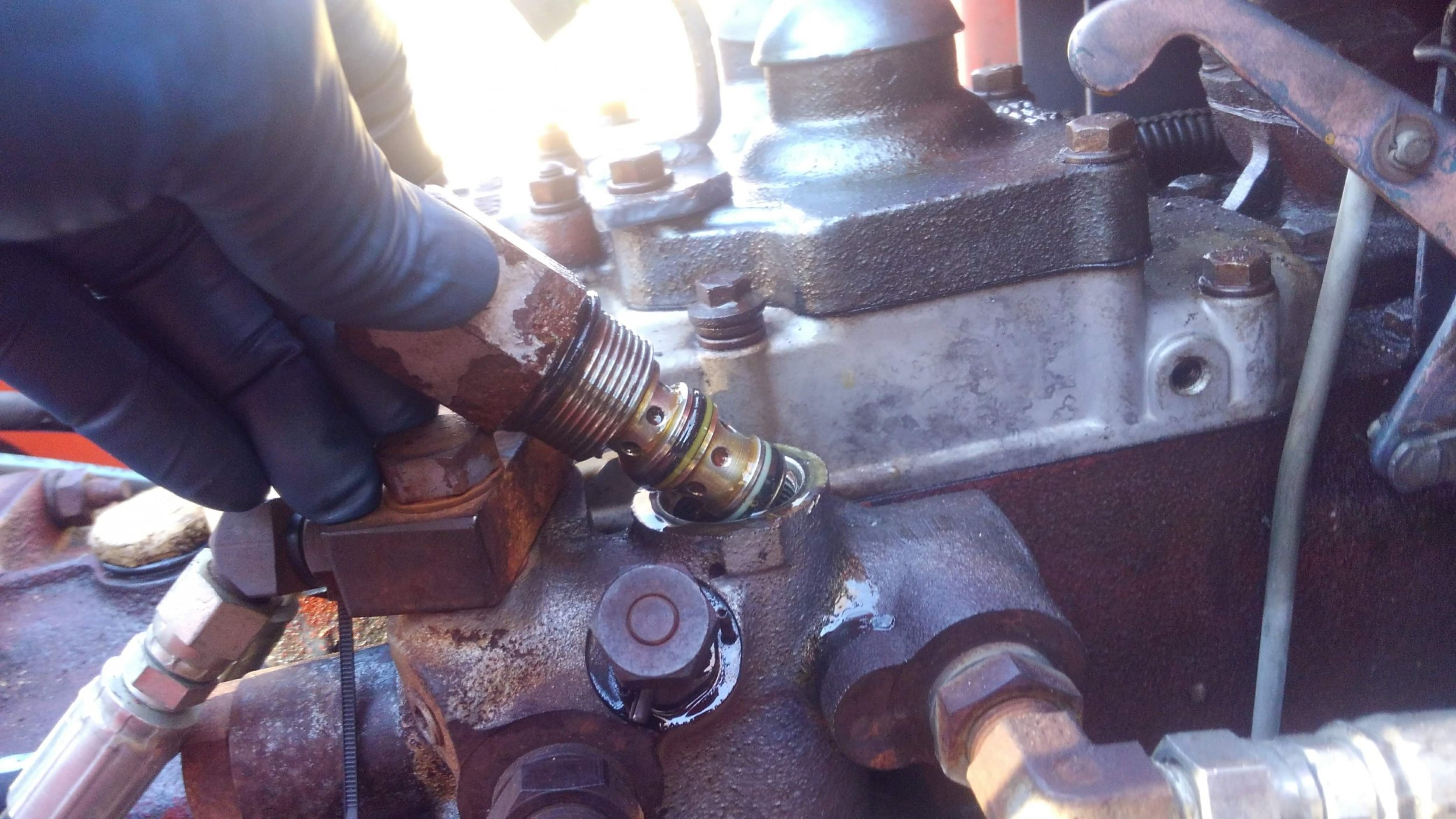

I have good news to report: So as well as removing the pump and having someone look at it I also removed all my hoses and blew compressed air through them. Upon re installing everything the rear will still lift slow at higher rpm but it’s holding position not falling anymore

That is progress. Good Job! Now you just have to figure out the flow problem and priority valve. Once that is done I am thinking you pressure will increase and things will work much better.

By any chance do you have any idea where I can get a new diverter or know of an aftermarket one I could replace this with?
   / Kioti LB2204 hydraulic issues #35
You could call the guys at Michigan Iron. They are really good people to deal with and will have a better idea.
I would take it off and clean it real good looking for any blockage.
