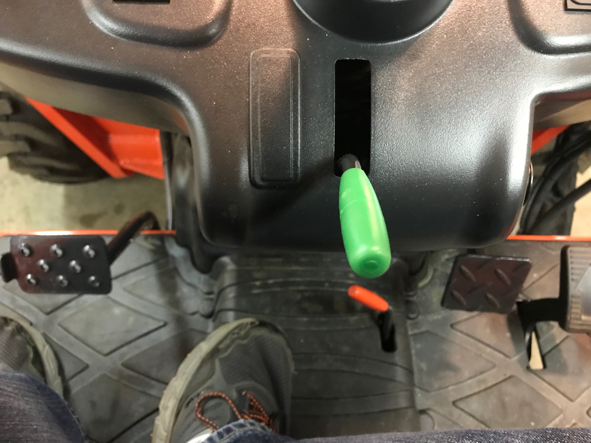

Basically you flip a lever and then your HST pedals will also engage the throttle very similar to a foot throttle on a gear transmission tractor. Basically you can leave the hand throttle at idle (but it works at any throttle setting), and then drive it around like a car. If you max the hand throttle out there's nothing left for the linkage to do so it won't have any effect. I think it where it will shine is in medium to light loader work and towing/dragging work, and obviously just driving around.
It's not going to help you if you're sitting still or heavy work while going slow.

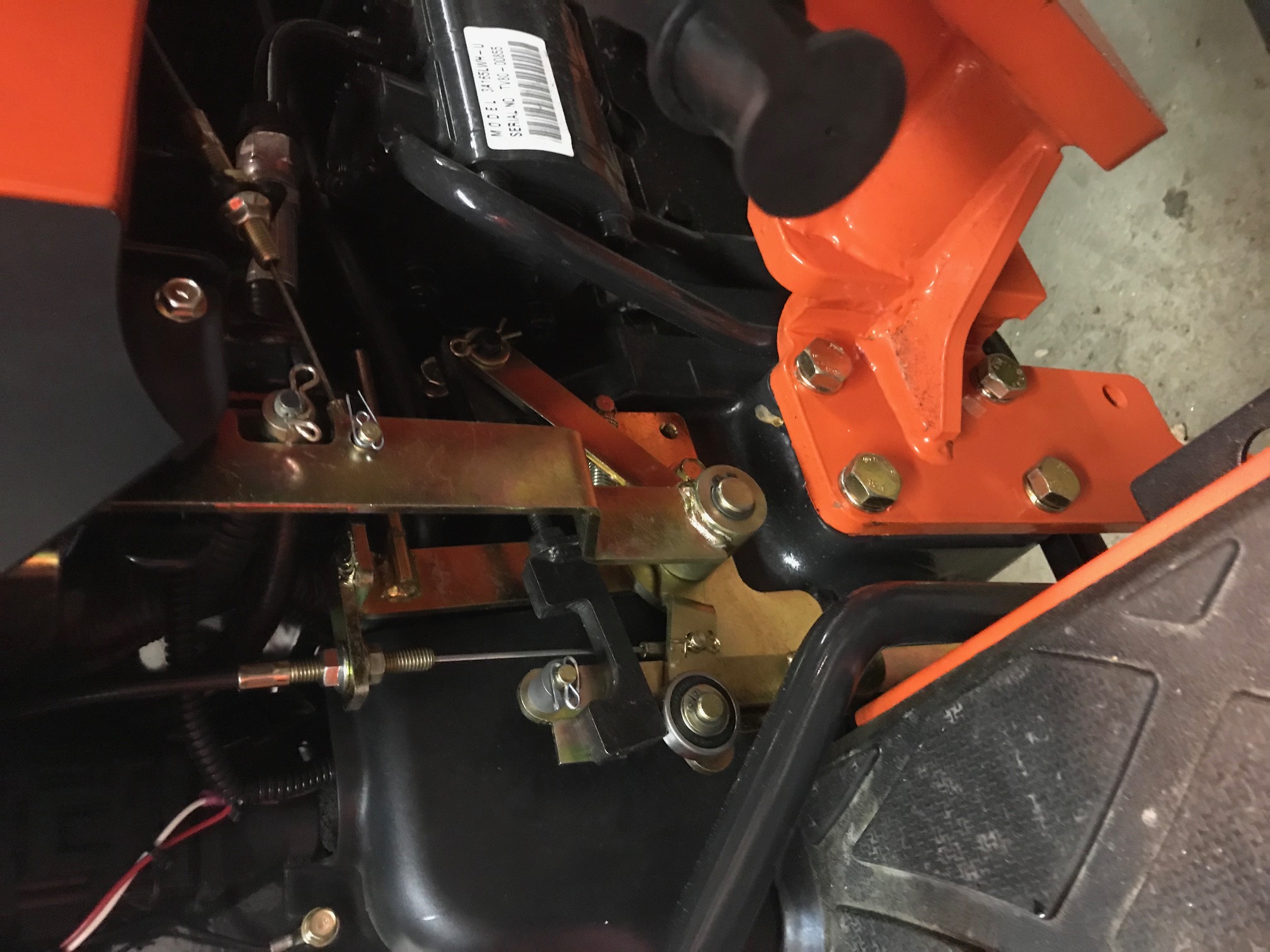

I installed the linked pedal kit on my CK2610, it works as advertised. It took me a few hours, but I took my time and am admittedly kind of ****... There are a LOT of small pieces and parts, clips, washers, linkage pieces, etc. But if you go slow and follow the directions it's not too bad. I wish I took pics during the install. The only part I didn't do was taking the steering wheel off. I fought with the puller a bit and gave up. I think this slowed me down a little. Here are the "after" pics:
View attachment 559059View attachment 559060

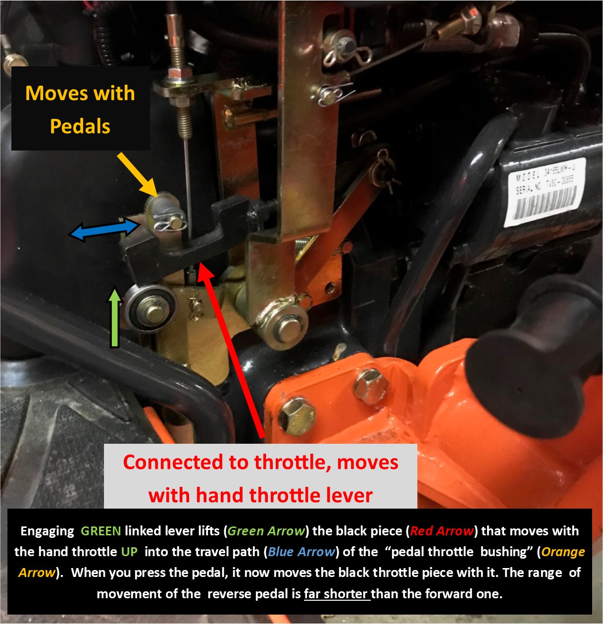

Do you have the instructions for adjusting the Linked Pedals? My son got it dealer installed on his CK2610 and in reverse the RPM's only go up to 1900. It's a bit slow in reverse. Not about to ask the dealer after the ordeal he with through with them.
/ kioti linked pedal #19
That is the only real frustrating part, there are no instructions for adjustment... I just sort of eyeballed it, and it worked great in forward. Since the throttle is fully mechanical on the 2610's adjustment is easy. I adjusted the cable so that the lift arm gets maximum travel. Then I adjusted the nut on the black throttle mechanism so that the full range of the pedal lever moves the throttle mechanism. It's kind of confusing in text, and the directions stunk, so I made this quick drawing. Hopefully it makes more sense. I made up the terminology... haha.
Long story short: Since the reverse pedal has a much shorter throw than the forward pedal, it cannot move the throttle linkage as far as the forward one... Net result is lower rpm's (and speed) in reverse. I haven't played with adjusting the stop screws on the pedals themselves (underside of the deck), I don't know if you can adjust the reverse pedal screw enough to increase the linked RPM's.
Sorry for the novel, hope this helps!
