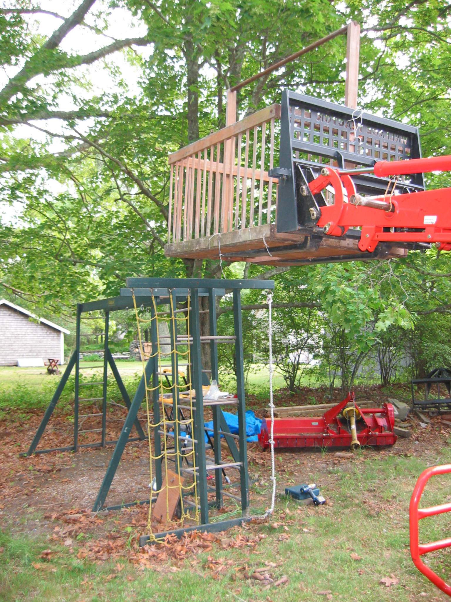

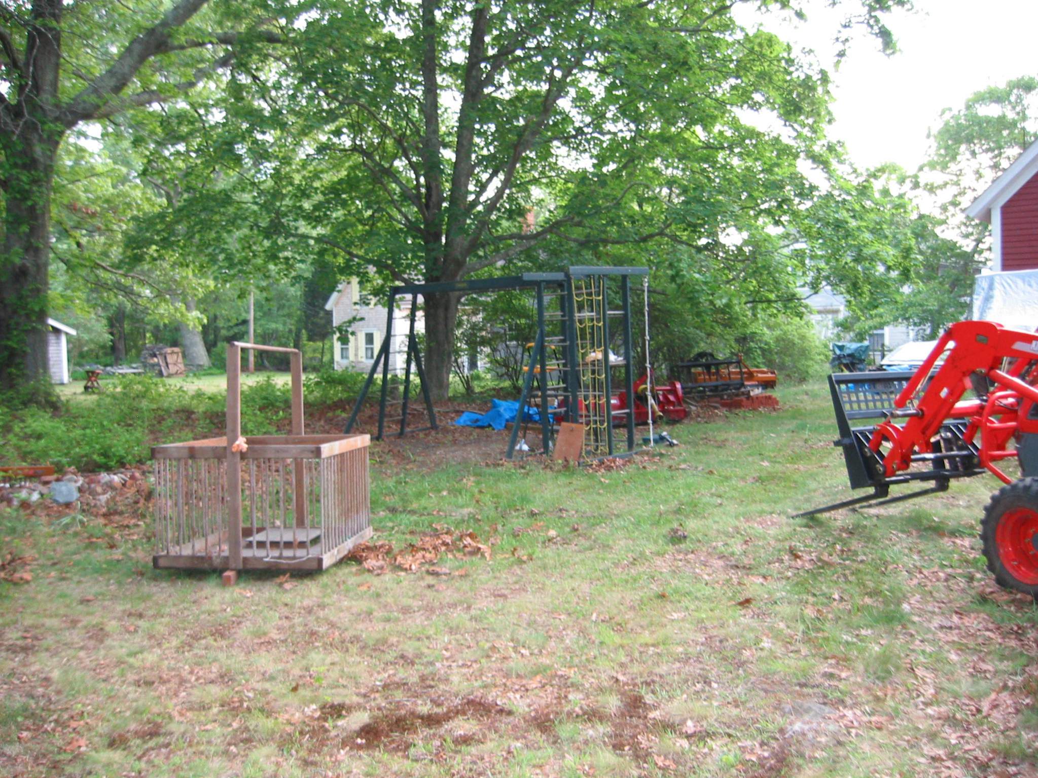

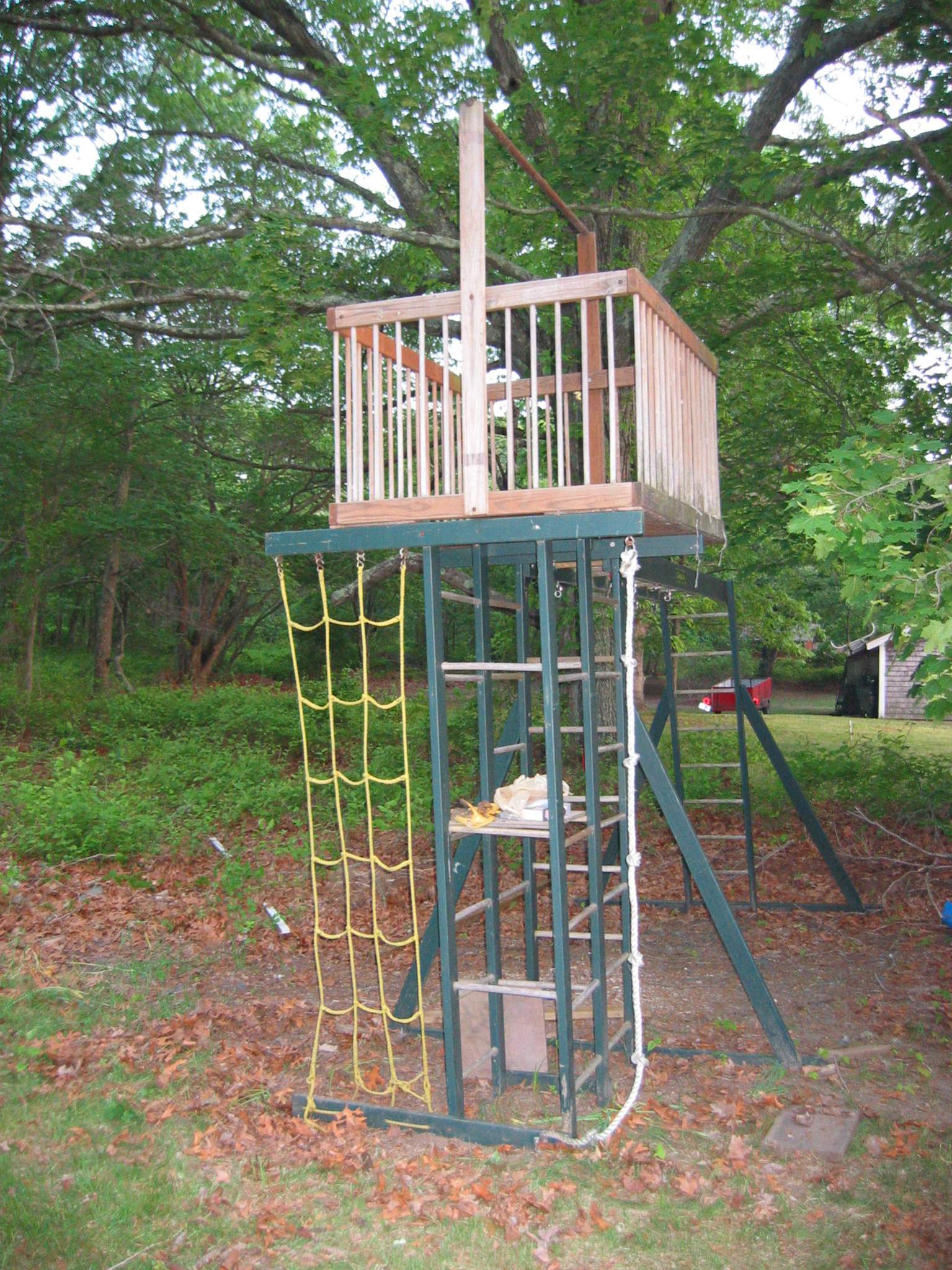

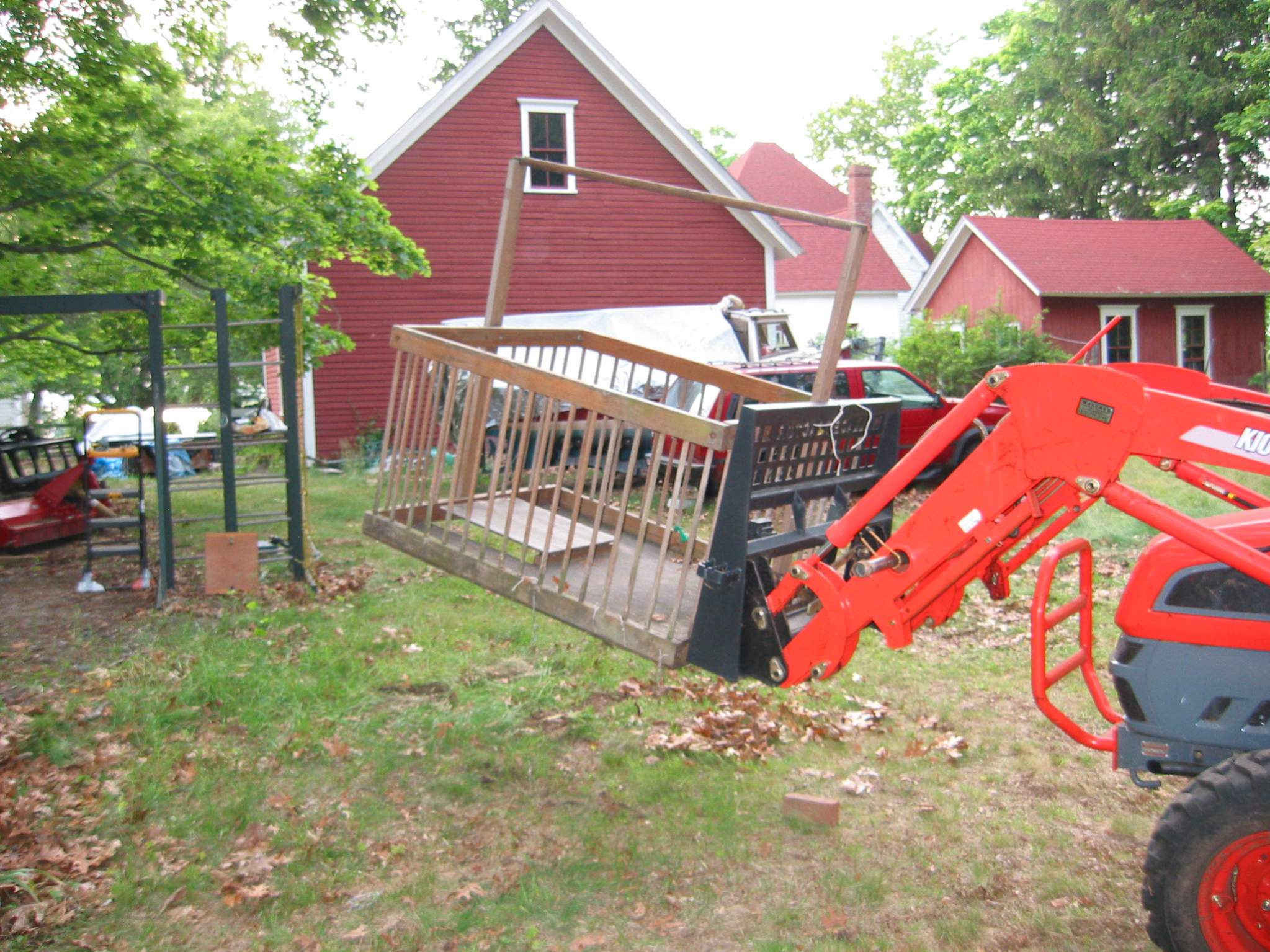

Here is my latest video, and my initiation into the "Eric the Oracle" Kioti damage club....:) I smashed both healight lenses, but thankfully I did not break the windshield!!
You need a set of forks. Easy to do that safely with forks. IMG_0122.jpgIMG_0123.jpgIMG_0127.jpgIMG_0133.jpg
Part of my ongoing series of lessons as to why "the right implement is more important than more horsepower".:rolleyes:
