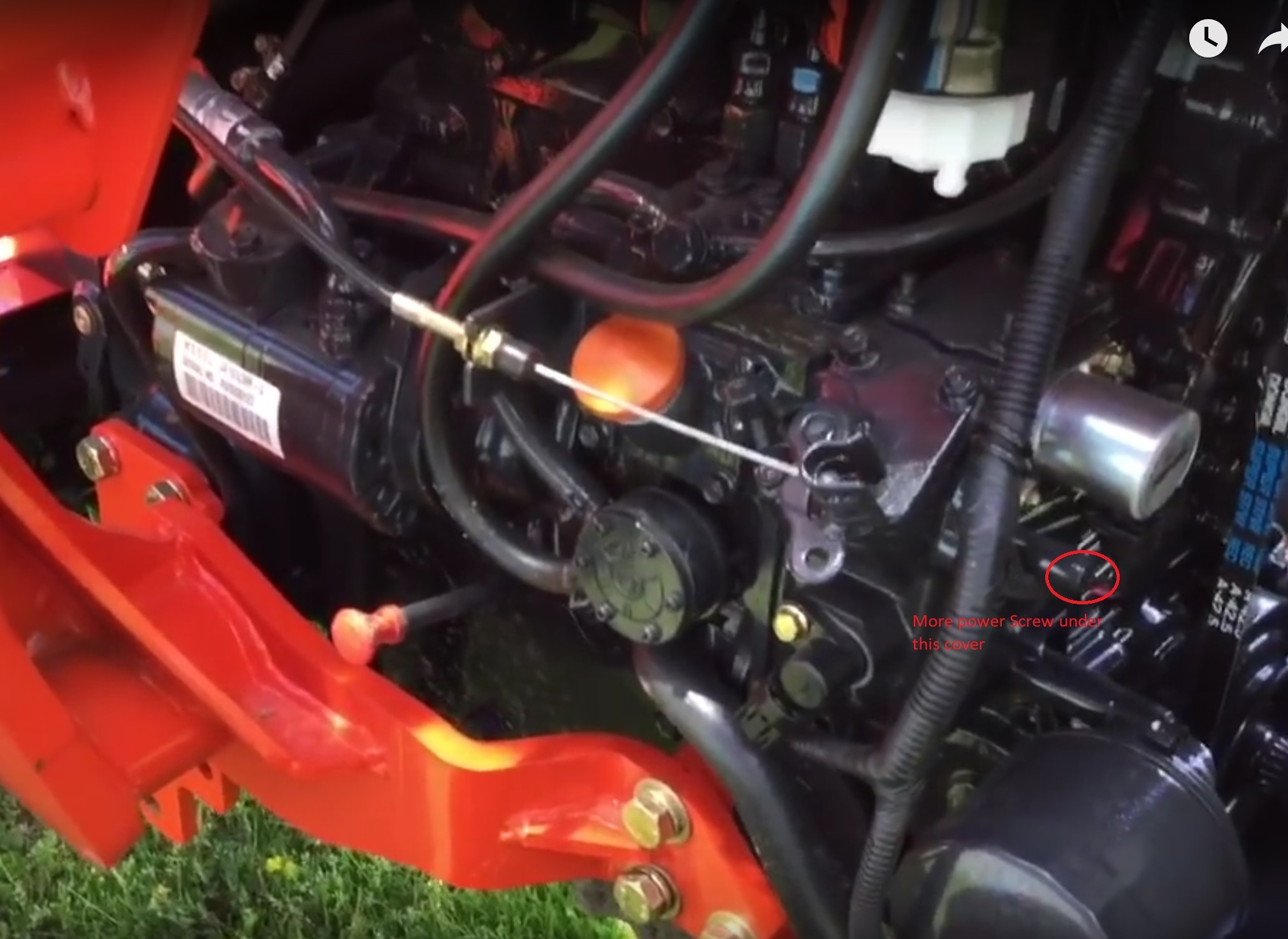

The new 2610 has the exact same engine as my 2014 CK35 1.6L. I believe it is not common rail just a standard plunger actuated injection pump that has been turned way back to get below the 25hp limit on tier 4. All you would need to to is turn up the fueling screw and you would be back at 35 hp easy.

See picture
Remove cover screw in 2 turns test machine and under heavy load look for black smoke, if none turn up more. Once you get to the point where you see black smoke under heavy load back off the screw 1/2 to 1 turn. Best way is to use a dyno for an accurate measurement. Good video on it here.
Turning Up the Fuel on a Diesel Turbo Charged Tractor New Holland TL-90 by Everything Attachments - YouTube
