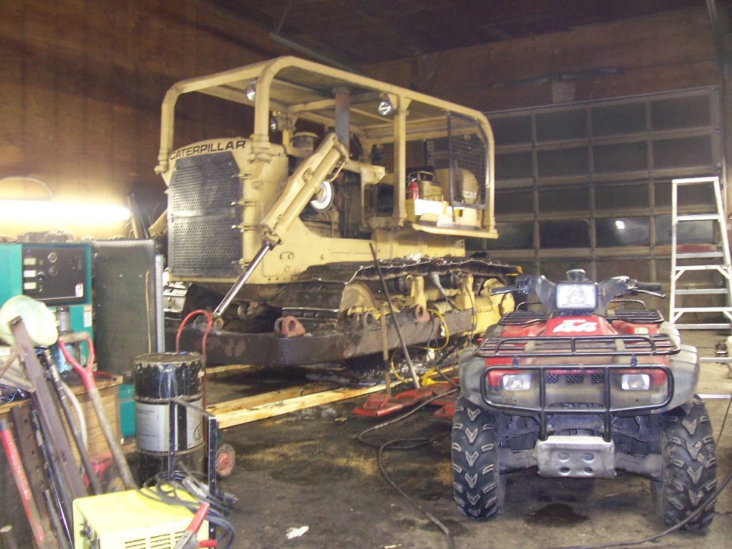

No disrespect ment but I do and did check all the fluid levels when I serviced it last fall. (That was just after the problmes started.) Just regular maintenance item. Typically I just take the owners or service manual with when ever I do a regular service. I always check oils and if I do indeed have to top something up I refer back to the manual to verify oil type.
This is a regular day in my shop working on equipment like this. Shops been updated a bit to make life a little easier since the pic was taken. New lights and a new over head door that we installed ourselves. Not trying to make myself look big and important or anything like that just the fact that we do all our own servicing and maintenance so it's not something that's new to us. Again please don't take any of this the wrong way as I do appreciate the help.
Ryan

Nice Cat! Want one!
Do me a personal favor and verify the axle's fluid level. It's as simple as looking at the site glass on level ground.
Thanks.
CM out

Thanks, it's a older machine but still in decent shape. Plan is to try and fully restore it one day and then buy a newer one for regular use.
