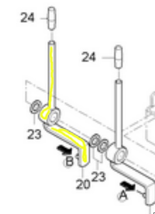

Hi all,
I just completed the install of a 2nd remote kit (T4145-A04040302) on my DK40se and would like to share some of the things that I learned the hard way.
1) buy 2 10mm x 1.25 nuts to install the longer studs. Put the first nut on and use the second to lock the first nut in place. Thread the stud completelly into the casting and then remove the two nuts.
2) the new valve is stacked onto the existing valve and will be closest to the rear wheel side of the tractor. Not towards the center of the tractor as I read here. The control levers will not function properlly as one is taller than the other.
3) the new valve comes with the orings already installed, no need of the orings (04810-00100 and 04810-00160) in the kit. Orings are found only on 1 side of the valve body.
4)the snap ring on the lever shaft is hard to get at. I had to access it through the side panel and had a tough time getting it back on.
5) the seat is heavy and an extra set of hands helped get the seat out/in without banging something up.
Although it took me longer than 2 hours complete, it was not too difficult. Thanks for everyone's input that gave me the confidence to attempt the install.
I now have a set of remotes for my hydraulic chute control for my rear blower and a set of remotes for my new power angle plow. Blower is a Pronovost 74 inch, plow is a HLA 2000 at 84 inches.
Bring on the snow !!!!!!!!!!
