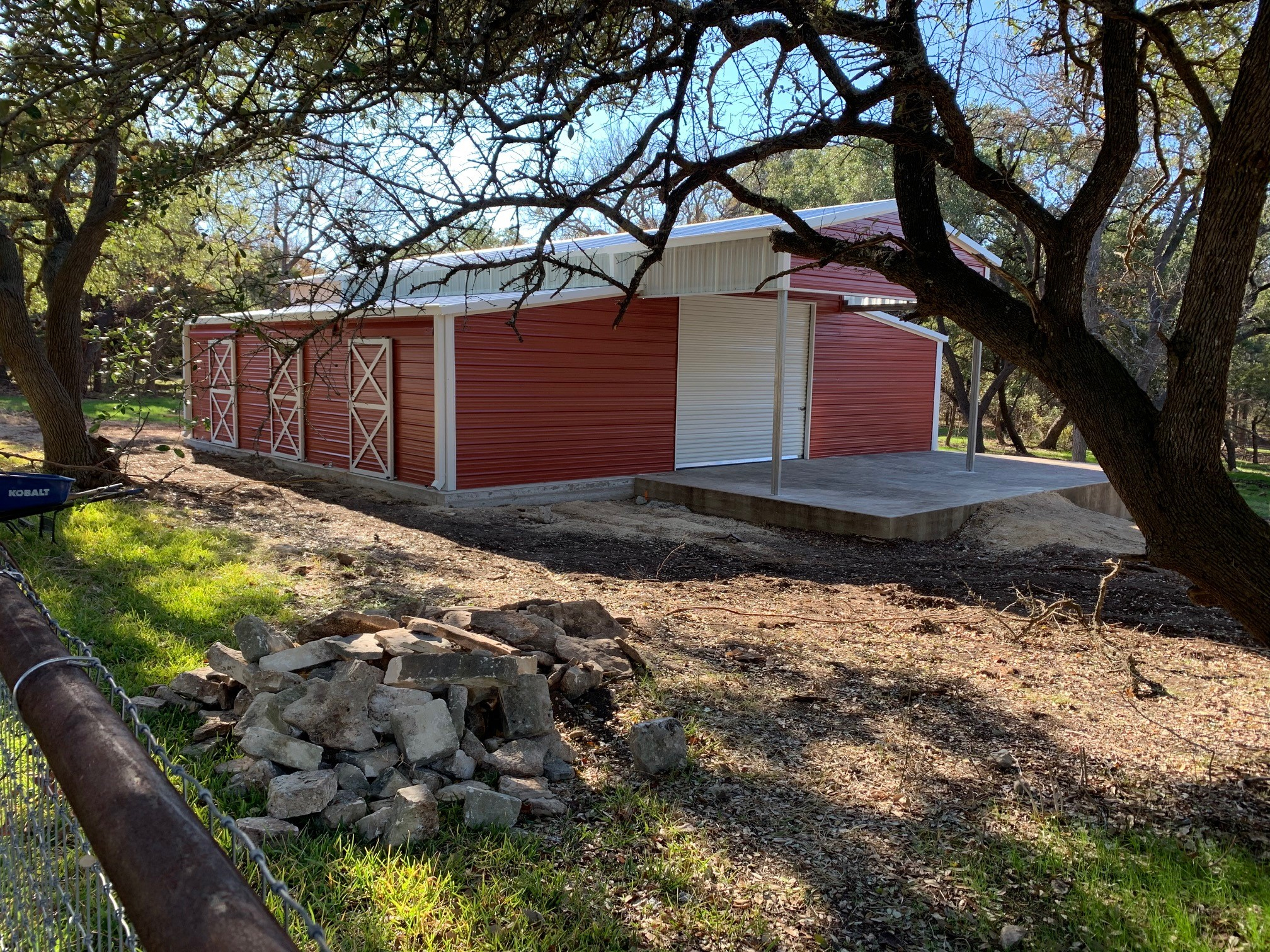

When we bought or place it had a nice 30x60 slab about 100' from the back of the house. I saw it as halfway to a barn. We looked at kit barns which we have done in the past but didn't want to spend that kind of money. We then looked at metal buildings and ended up with this for half the cost of a wood kit barn. Worked with the salesman on the design and asked if I could erect it myself which is my normal approach. He talked me out of that and it worked out well. They erected it in three days. 14ga square tube frame and we upgraded the sheetmetal from 29ga to 26ga. We have since fitted it out with stall fronts on the left and hay storage and tack room on the right. I'm sure the price of metal has changed and don't know what labor cost is in your area. This was a local operation in central Texas. Not a big seller like Morton.
I like the concrete covered porch....perfect for wood choppin!
