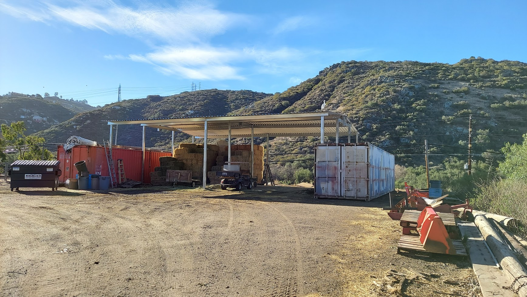

Got this 36x48 from Gator Carports (it was about 2k cheaper when we ordered it last Fall), it's made as a mare motel but was the right size for our hay and vehicle shelter - we just specced the posts a bit taller to have adequate clearance for the hay squeeze. We are limited as to what we can do with the land - no concrete footings, so it's bolted to the cargo containers on either side. Aside from the cargo containers I built it all myself using a rented boom lift from Home Depot to put up the frame, then used the hay stacks themselves as scaffolding for the roofing. Took me a couple of months off and on but well worth it. Still want to put some sort of curtains to better protect the hay from windy rain but even without it's loads better than tarping the stacks and getting moldy bales from the inevitable holes in said tarps.
