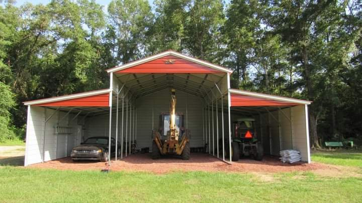

Carolina Carports 42x31 open front on gravel. Panels were standard 26 gauge and I had the frame upgraded to 12ga. I also had the side walls at 9' and the center walls at 14' so the backhoe can driive in with the boom stowed. Actual height is 4" lower.
Mine is Florida spec rated for 170 mph winds.
I had to have the foundation ready and send pics before they would schedule. Took 6 weeks to arrive and two guys put it up in 2-1/2 days.
$11,400 in May 2020. I have another grand in fill and crushed red brick.

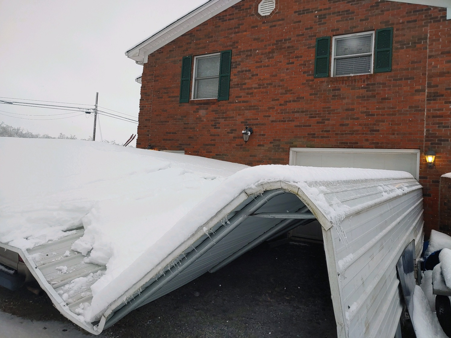

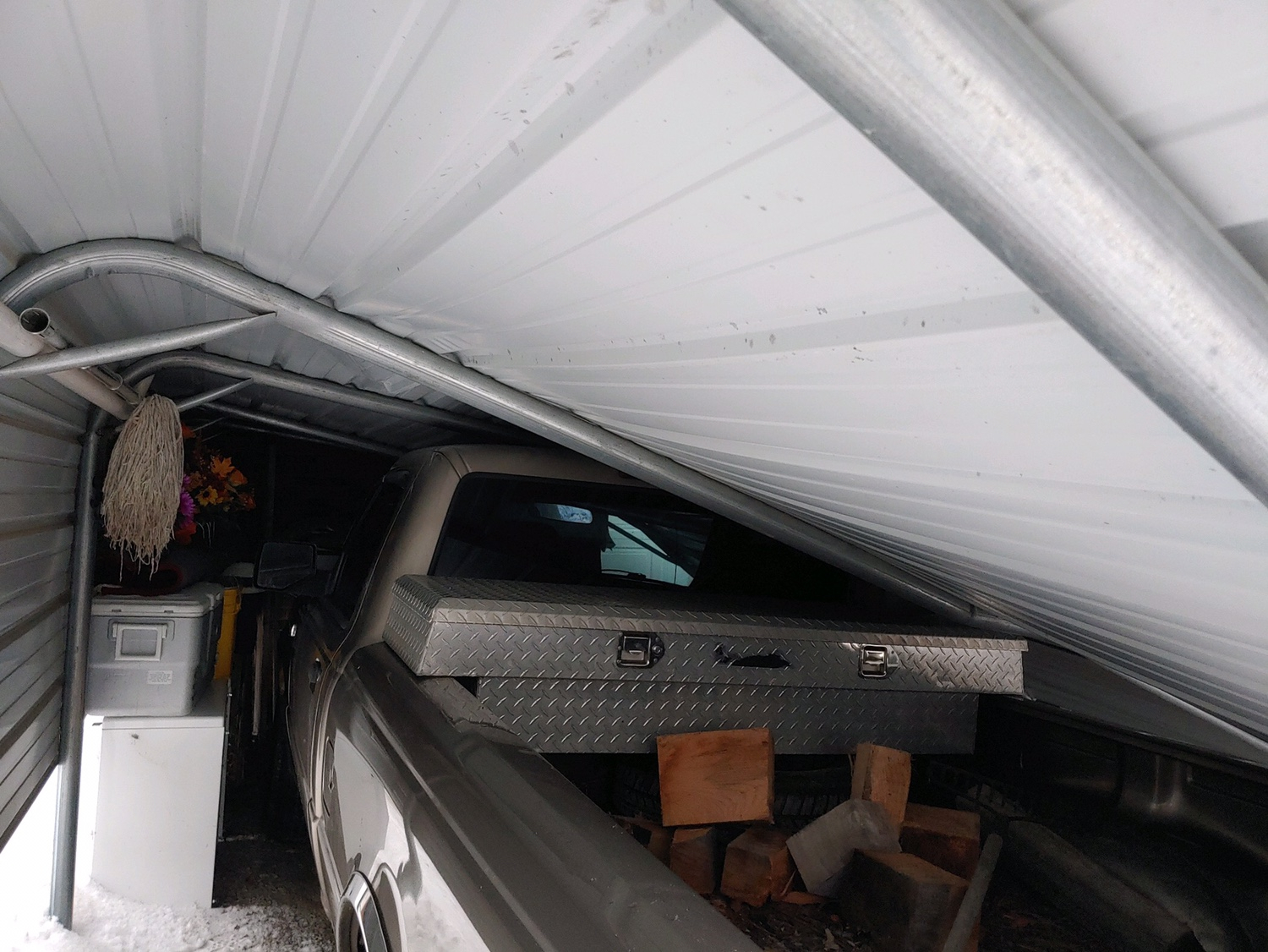

Cousin learned the hard way that snow load ratings are a bit optimistic sometimes on the carport structures.

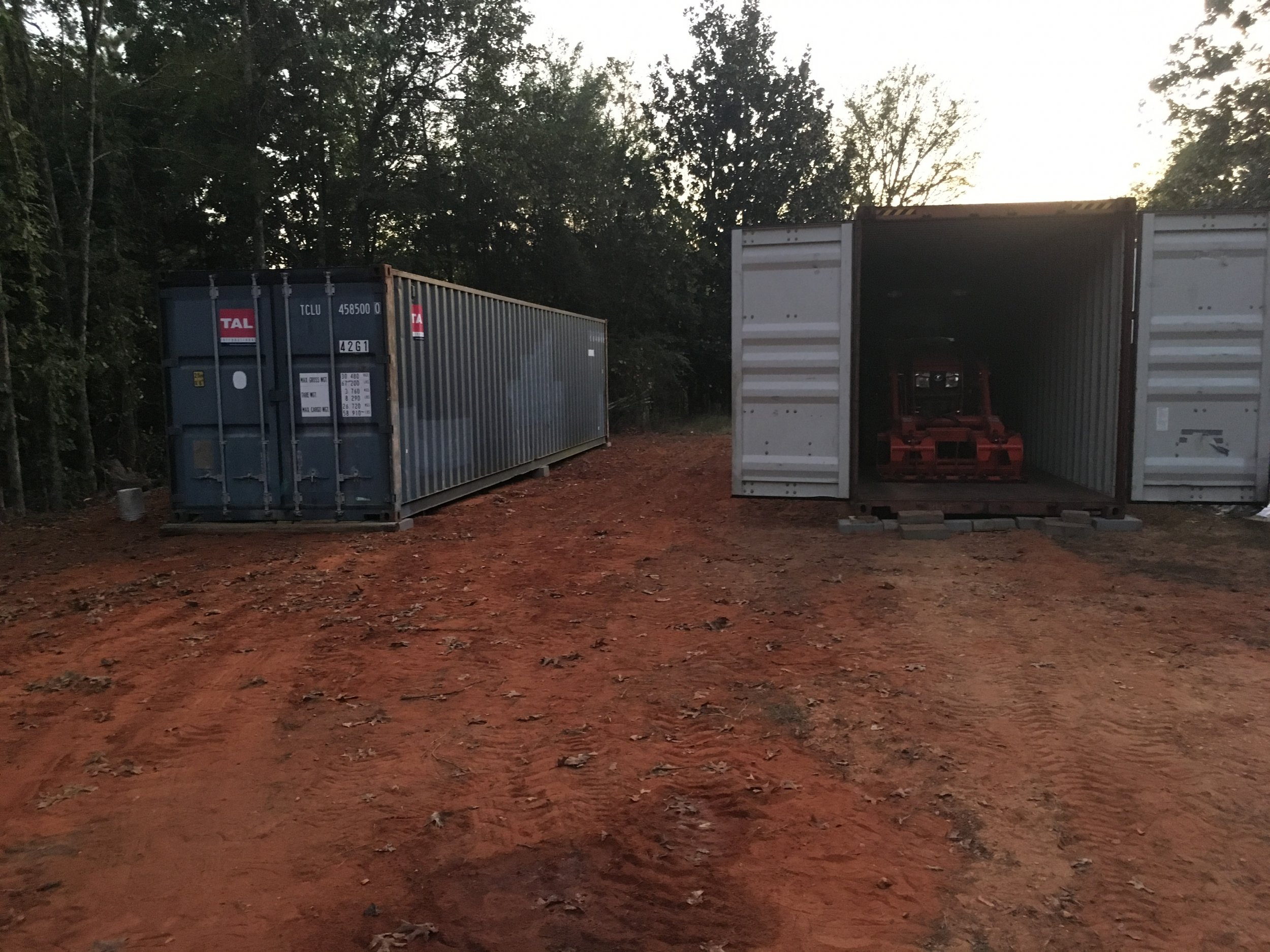

My cheap rodent proof tractor storage.
