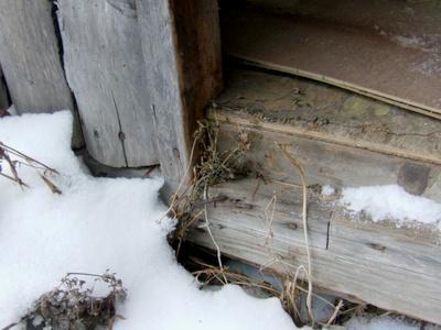

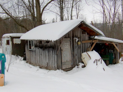

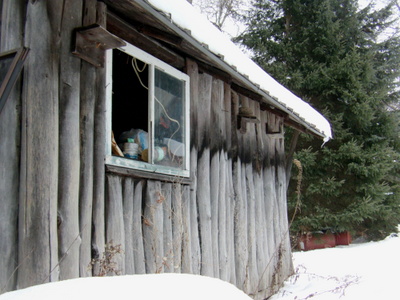

Boeing,
Here's a couple pics of the cabin. One guy could build it alone but it's easier with two. Basically it was done by building the floor frame, setting the corner and center logs in place and tieing them together with a top 2x6 plate, then filling in between with more logs. We tacked each log in place then ran the chainsaw down between them to fit them together, moved them tight together and nailed them in place. After about a year we chinked most of it with oakum and portland cement with small nails to help hold cement in place. Most of the chinking has fallen out for lack of maintenance and the cabin being moved at least 4 or 5 times. Flexible caulking would be better. It is on blocks although with the snow, doesn't look it. We don't have termite problems here but I do know about termites as we built a fence with on site pine posts in Fla. and the next year it was down. You should be able to spray the bottoms with copper tox or zin tox and put termite caps on the blocks.
If it looks of interest, PM me and I'll send more photos and detailed description.
Smiley
Don't know how I managed to get those photo's in without description and I can't seem to delete it???

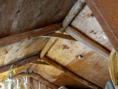

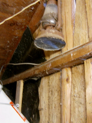

Our cabin is only about 8 x 12 if I remember correctly as it was just a playhouse for my son, but can be made any size within reason, just keep adding logs. In a much larger size, I'd think about diagonal bracing for the walls and stringers across the rafters or trusses. Here's some pics of the pole type rafters and ridgepole, the plate where the support log for the ridgepole is notched around plate and the sill board where the logs sit on it and are fastened to the floor framing. Poplar has always been considered an inferior wood but we have a lot of it and use it for everything (had our own small mill) from framing lumber to finished boards. If not stacked and dried properly, boards will twist all over the place. These logs were cut and put up within days without a lot of twisting. It rots quickly if not kept dry but these in the photos are more than 40 years old. We built wide overhangs to be sure everything stayed dry. I learned from an old time carpenter neighbor that poplar was a preferred wood for dance hall floor joists. It is very springy and a good square dance could really get it hopping. Pine is generally better wood for building except for that southern loblolly or sand pine that we had in Fla. which I don't think is even good for pulp.
