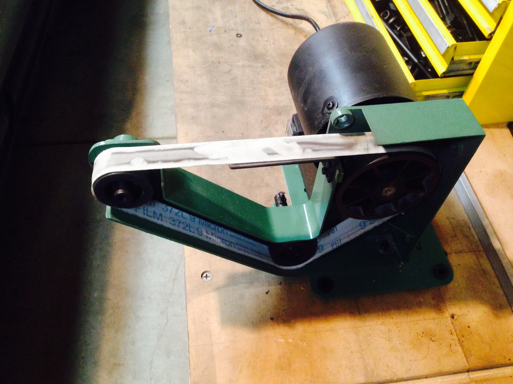

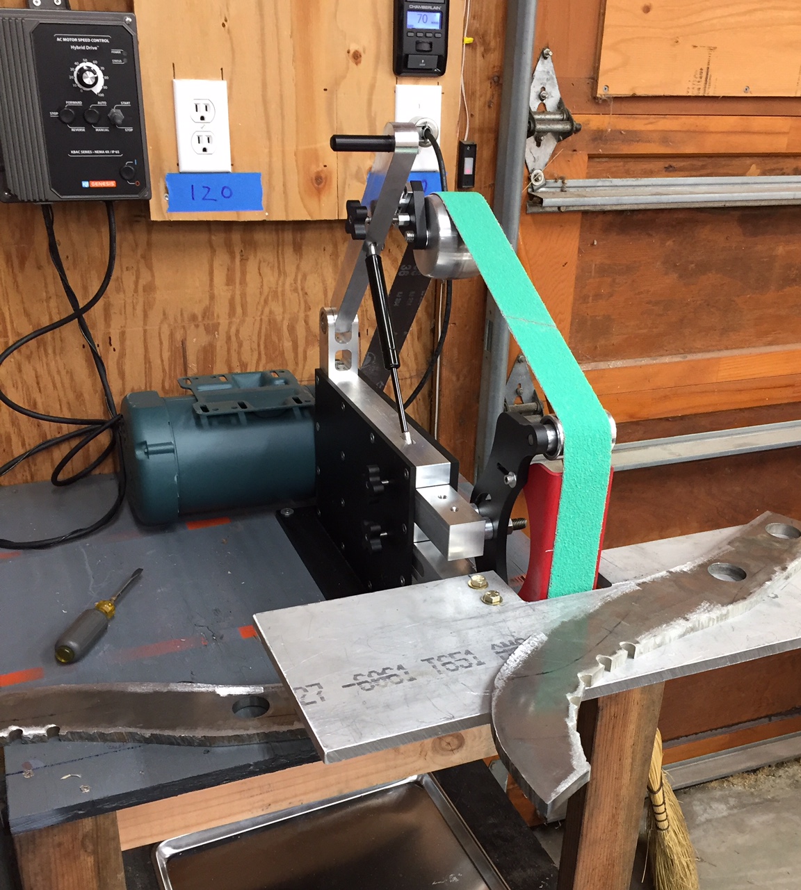

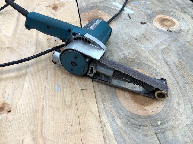

A belt sander or grinder does an outstanding job as a knife sharpener. Use the slack part of the belt to get a nice curved edge as in the illustration posted above. Probably most people on this board already have one or two.
I use all of these general purpose tools to sharpen chisels and knives and other cutting tools. Upside down belt sander, HF 1x30 grinder, Makita 1x21 sander, 2x72 belt grinder.
Once the edge is well-shaped, a couple licks with the Accusharp tool and maybe a stone or steel will keep it sharp for a long time.
