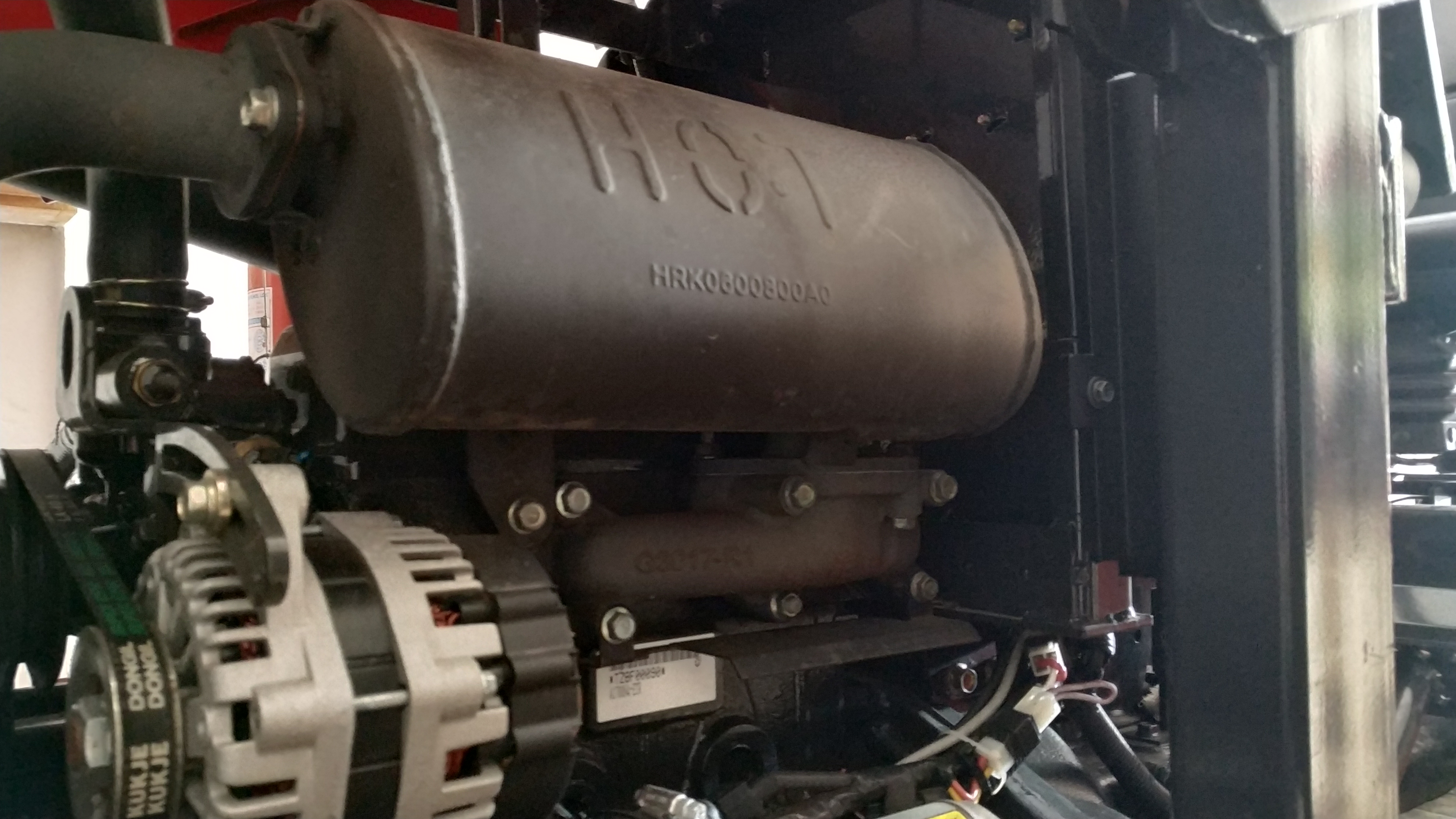

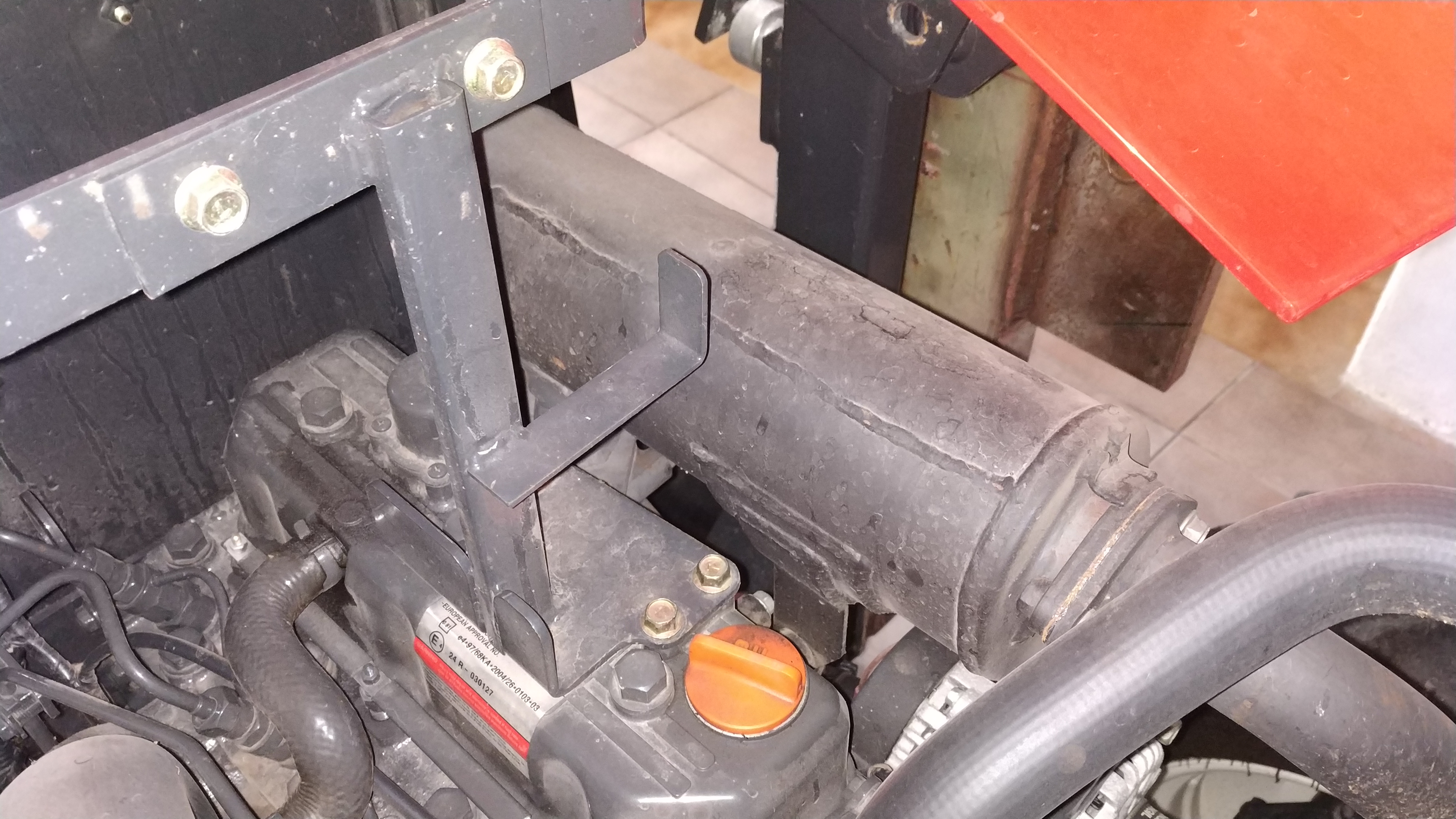

No heat shields on this one though. Well, just one under the exhaust manifold but it's tight. It does make the noise while sitting but, the again, if I press the clutch, it goes away.

{UPDATE} Mine (original post) has been at the dealer since 6-30-2020 now. I checked on it Friday. It's not an exhaust issue. It not anything loose on the outside of the engine. It's not a throwout bearing or clutch related. (HST). They were going to check the valve train next. I hope they get it resolved too and it's not something major. I only had the little guy a few days but I sure miss him already. :(
