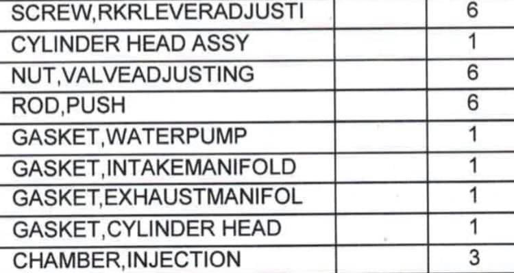

My 2515h was experiencing the same and I worked it until one day it completely lost power. This happened at about 50-60 hours.
It smoked like crazy and I could barely get it onto the trailer to take to the dealer. Turns out it was a bad valve and I had a new cylinder head and gaskets replaced. Picture of everything they replaced attached.
After about 2-3 weeks I got it back. Power restored, drives fine but I definitely still hear a slight knock still. I reached out to the dealer again and they said to just continue working it. The response was that the 2515 has a slight rattle as compared to the 3015 or larger. 🤷🏻. IMG_5288.JPG
