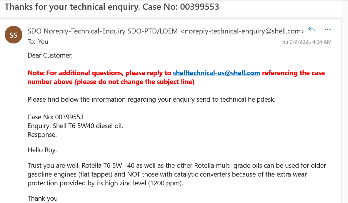

I will look for it. It's on my old desktop if it is anywhere. The reason for not using it on catalytic converter equipped vehicles is the high zinc or ZDDP, (don't recall which, it's been a few years) levels in the T6 (and perhaps other diesel oils, I don't know) does not play well with catalytic converters.

I sent an email two days ago to Shell oil just in case I couldn't find the old one. This reply seems word for word as far as their response a few years ago to the same query.

I'm not sure if you have been online since I posted the email I received from Shell. I only posted the most recent email, since it was the same as the one on my old computer from some years back. I hope that it answered all of your questions.
I still find that hard to believe. I wonder if it's due to emissions compliance and not that it will damage the cat.
Do what I did. Email Shell oil and ask them.
