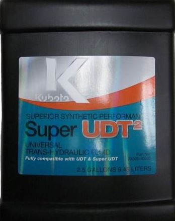

I want to do the 50 hr maintenance on my BX25 and in my mind UDT2 was synthetic. Even though it states "Superior Synthetic Performance"
the MSDS sheet is here: https://www.kubotausa.com/docs/defa...ota-super-udt2-2_2-5-ga.pdf?sfvrsn=c6068022_2 (as previously stated by Jaydee325) made by Valvoline does not show the word synthetic in 17 pages. I have a local Ag Repair outfit that is a client of mine and he sells Dyna-Plex 21C Trac Gard Hydraulic/Transmission Fluid. Initially I was skeptical as (in my mind like I said) UDT2 was Synthetic but that is looking to be false...

I always thought UDT was dino, sUDT was semi synthetic, and sUDT2 was full synthetic. Apparently not, as the Kubota www site FAQ states that sUDT2 is 75% synthetic. No mention of UDT or sUDT that I could find.

Not sure about synthetic but I will say that after using a better quality fluid, that cost just a little less than Kubota, I changed out to super UDT2 and results are amazing.
Was getting alot of whining noise from HST and relief valve always squealing. All gone after paying just a little more and following Kubota recommendations.

Kubota Super UDT is Hydrostatic Fluid for the Kubota Hydrostat transmission. Run as fast as you can if someone try's to sell you Super UDT to put in your engine.
The fluid is very clear and is hard to see on a dip stick or in fluid level windows to check fluid levels in hydro transmissions. John Deere sell a dye to add color to Hydrostatic Fluids to aid in providing color and visibility to the fluid.
