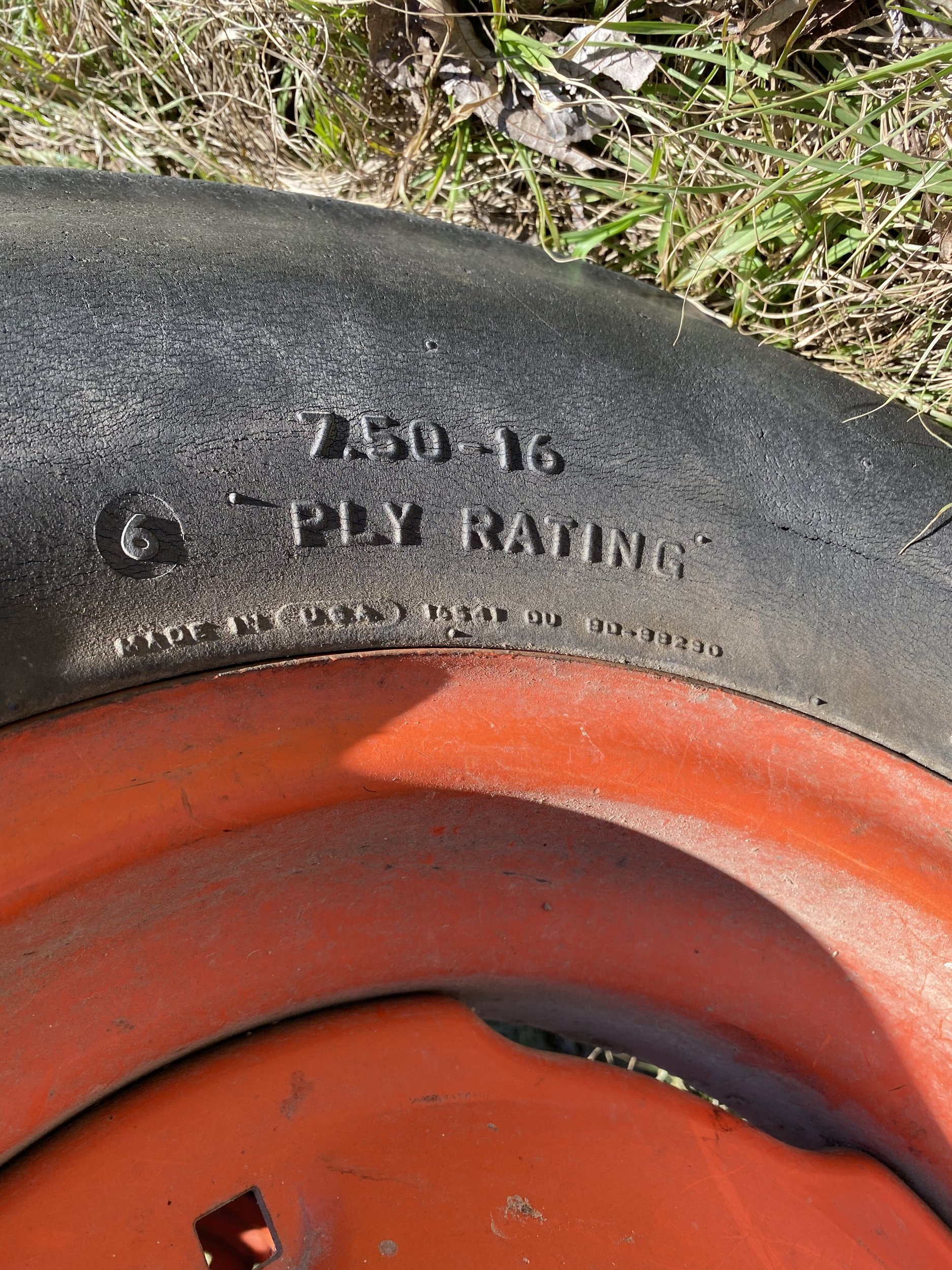

I’m going to the ranch tomorrow and determine if the current tires I have are 8 or 10 ply. I have a pretty heavy duty frt end loader so I’ll definitely go w 10 ply. I’ll take some pics tomorrow & post them.

A high quality 8 ply domestic tire will outperform a 10 ply Chinese tire 9 times out of 10.

The original Goodyear (GY) 2WD 7.5 - 16 ribbed tires are close to their end. I have tubes in both of them now.
Looking for recommendations on replacing both front tires. Is the quality of 2022 GY still there, or is there a better brand available? Thank you.
PS - I’ve kept the tractor in a nice shed when not being used so no UV except when using it
Hope everyone has a safe & prosperous new yr / tstex
Goodyear no longer makes their own ag tires, they sold the division to Titan who makes and sells the Goodyear-branded tires. The ones I've been around that have been made in the last 10 years have been fine. I've not had any issues with any of the larger makers (Firestone, Titan/Goodyear, Galaxy/Primex, Carlisle). I haven't seen newer 7.50-16 F2 tires available in 10 ply though, they are 6 or 8 ply. Most of the tractors this size specify a 6 ply 7.50-16 tire, but you would need to check your manual as Kubota doesn't post them online. Heavier is fine though.

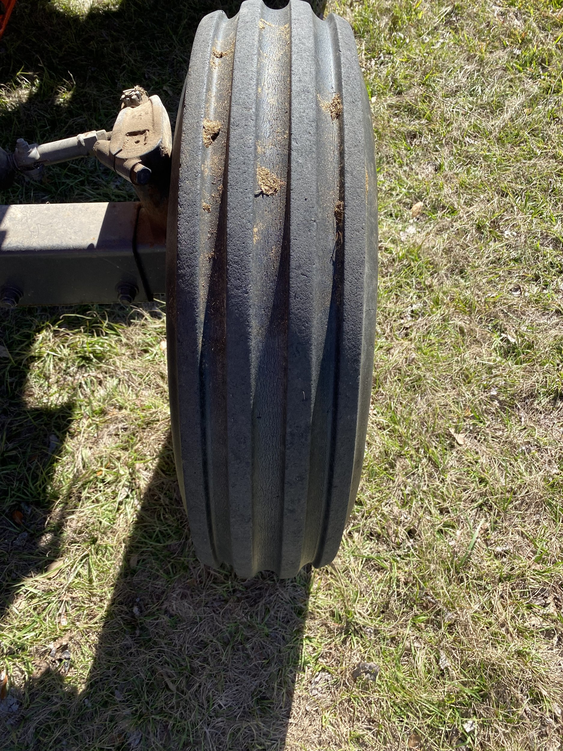

Here’s a pic of the front tire and it’s a 7.5-16 Firestone but I was surprised it was a 6 ply and not at least an 8-10 ply. Therefore, if I went w an 8-ply bc of the front end loader, I should be good, yes?
Thanks for your feedback

thanks. Is an F2 8 ply or other?
What specs need to be specified for the ribs indicated in the pic along w 7.5-16 8-ply? Thanks again
