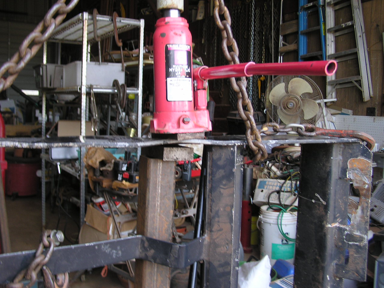

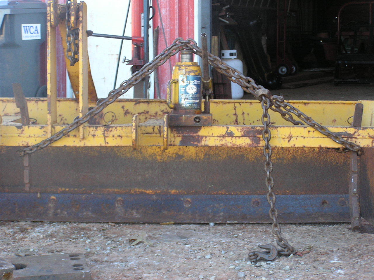

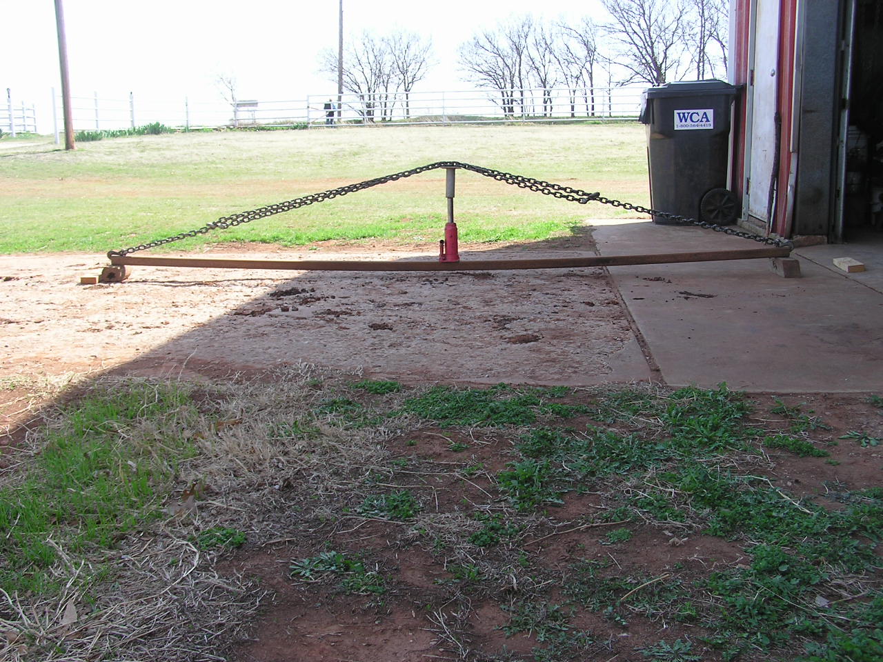

For a lift arm, I would use a strong chain and a bottle jack, rigged with the jack on the high spot.
Like this, but shorter:
Some other things straightened that way:
/ Kubota 3 pt lift arm bent. Repair or replace? #16
Xfaxman--good thinking and very helpful.
/ Kubota 3 pt lift arm bent. Repair or replace? #17
For those with a gooseneck trailer, hook it to the truck and you have a "press"
