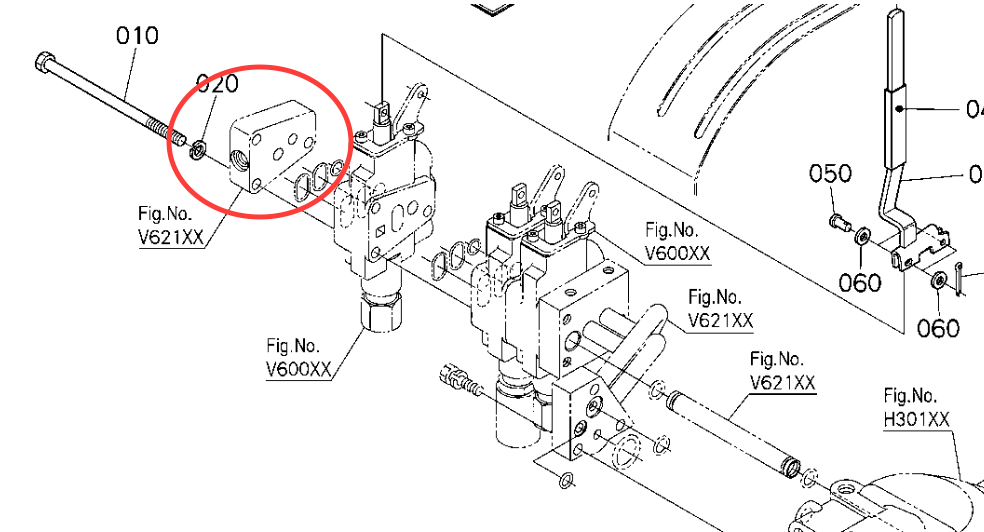

What does the By port connect to today? Lee john is correct if the is an open center system then the By port must be connected to something to operate correctly.
My guess is it is connected to the Power beyond at the front end loader. Difficult to say for sure as I don't have the hydraulic diagrams.
Just so I am clear in what I am trying to do...I want to remove the end cover assembly (in red circle) and replace it with a custom aluminium manifold and bolt a solenoid valve on it.
It wouldn't be easy to directly connect to the By port on its own as you can see in the attached image.

I'm going to do some guessing and if'n. If you look there are 3 holes with o rings in each spool until you get to the end cap. Now "if" that end cap has a plug in it as it looks like it might and "if" there is threads between the last 2 holes so you could screw in a pipe plug to block the loop. Then send the oil out the hole that was plugged to the P port on the electric valve and you need a way to tape back in the end cap at the 3rd o ring hole. It should be easy to line it up if drilled from the inside out, the tape it. You do have to make sure the center hole is the feed from the pump. Also you might want to check the price of the cap, just incase it doesn't work or you mess it up. Don't do anything until you look it over real good and Roy might pop back in see what he thinks, he"s a lot sharper then me when it comes to this.

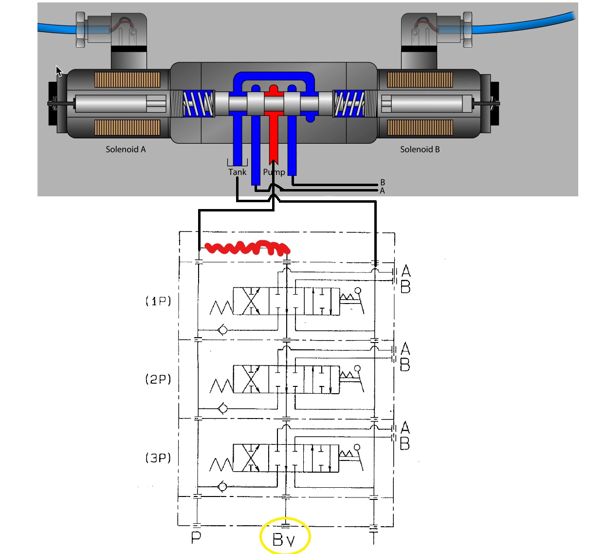

I have a small CNC mill so I plan on making a completely new end cap with ports for the electric valve.
So is this what you are suggesting. Send the P flow through P on electric valve... remove flow through By? (see picture)
What solenoid valve should be used? Closed, open or tandem?

In looking at how this valve is mounted I suspect the end cap you want to remove just directs the oil from the "P" channel to the "By" channel in the valve casting. The "By" port of this valve stack connects to the housing in the picture Fig H301xx. I suspect this then feeds the 3 point hitch. To replace that end cover would require a tandem center valve with the tank line capable of handling full system pressure. Connection to the tandem center valve would be P to P & tank to By.
My guess on the oil flow path of your tractor is: Pump to front loader valve, front loader valve to rear remote valve, rear remote to 3 point hitch, 3 point to tank.
Yes this was exactly what I was thinking was the case. The tandem center valve option was one I flagged previously. My only concern/question before - using the tandem center valve with tank (T) hooked to the By what would happen if you actuated any manual valve whilst the electric solenoid valve was at idle or in operation. Would the flow through the solenoid valve simply just stop or reduce?
Yes I believe this to be the case also.

If the solenoid valve is in the spring loaded center position or energized the manual valves will operate like normal.
If the solenoid valve is energized, the return flow from that feeds "By" passage If a manual valve is shifted the solenoid function will stop since shifting the manual valve blocks the "By" passage
Yeah this makes sense.
I tested the 3 point hitch whilst the 3rd aux were in operation. As suspected the 3 point does not work with any of the 3rd aux valves actuated.
I will design and fabricate the manifold to hook to a tandem solenoid valve, with the P hooked to P and Tank hooked to By.
