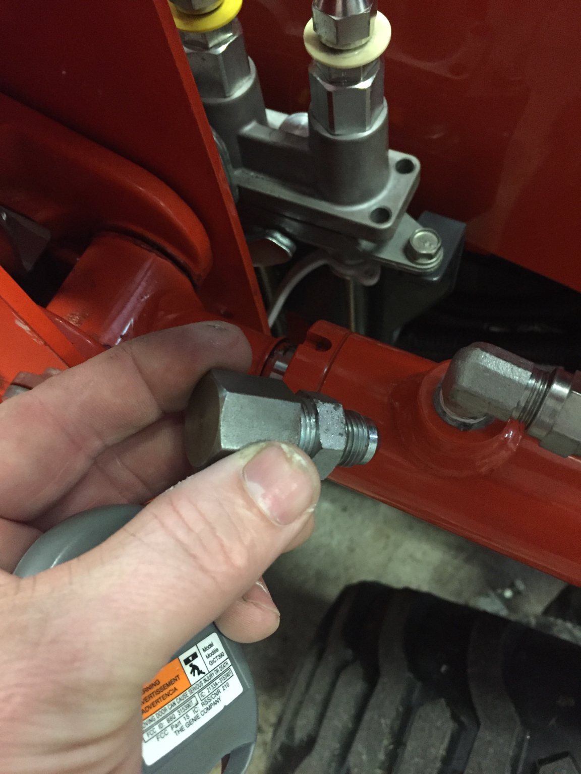

OK, it definitely is a 5/8" connector. Here are some pictures after I removed the FEL to get some. Going to do some more web surfing to see if I can find an easy way to build one. In simple terms, I just need a connector, a hose and a pressure gauge. The hose and gauge seem simple to find. It's finding a connector I can attach to a hose that seems to be the hard thing to find.
Dell, what do you think of this coupler... should be easy to find an adapter to install a gauge on it.
5HTF6 | 5/8" Female Coupler, 3/4" NPTF Threads
   / Kubota 80 Series Hydraulic pressure tester #13
So you attached it directly to one of the FEL lines? If so, which one and where? :)
IMG_6106.JPGi unscrewed the fitting with the white washer on it an attached my pressure test line. Then capped off the line I took off. The fitting you will take out will have a o ring seal on it. IMG_6108.JPGIMG_6116.JPG
