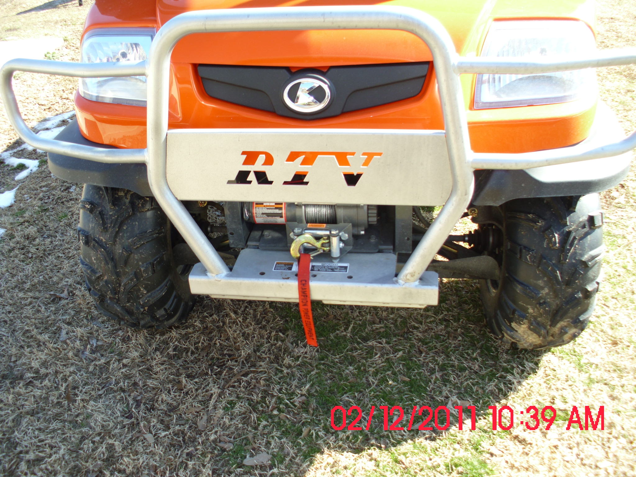

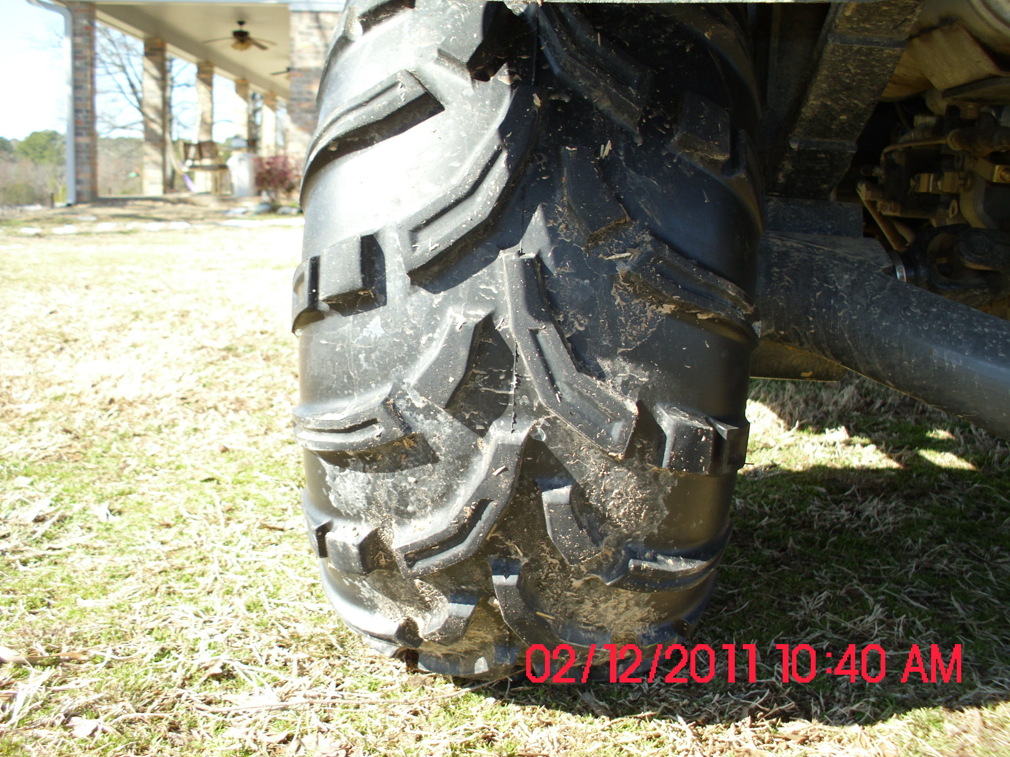

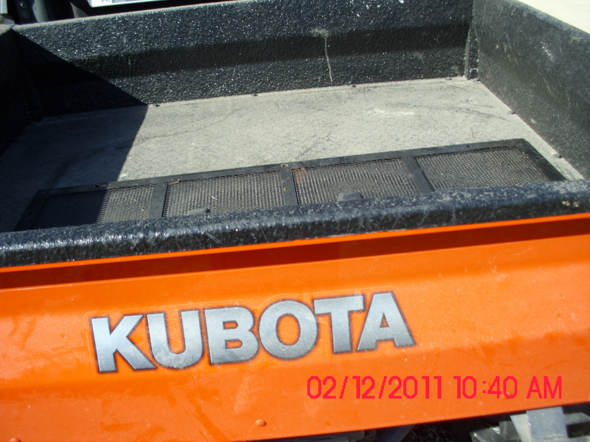

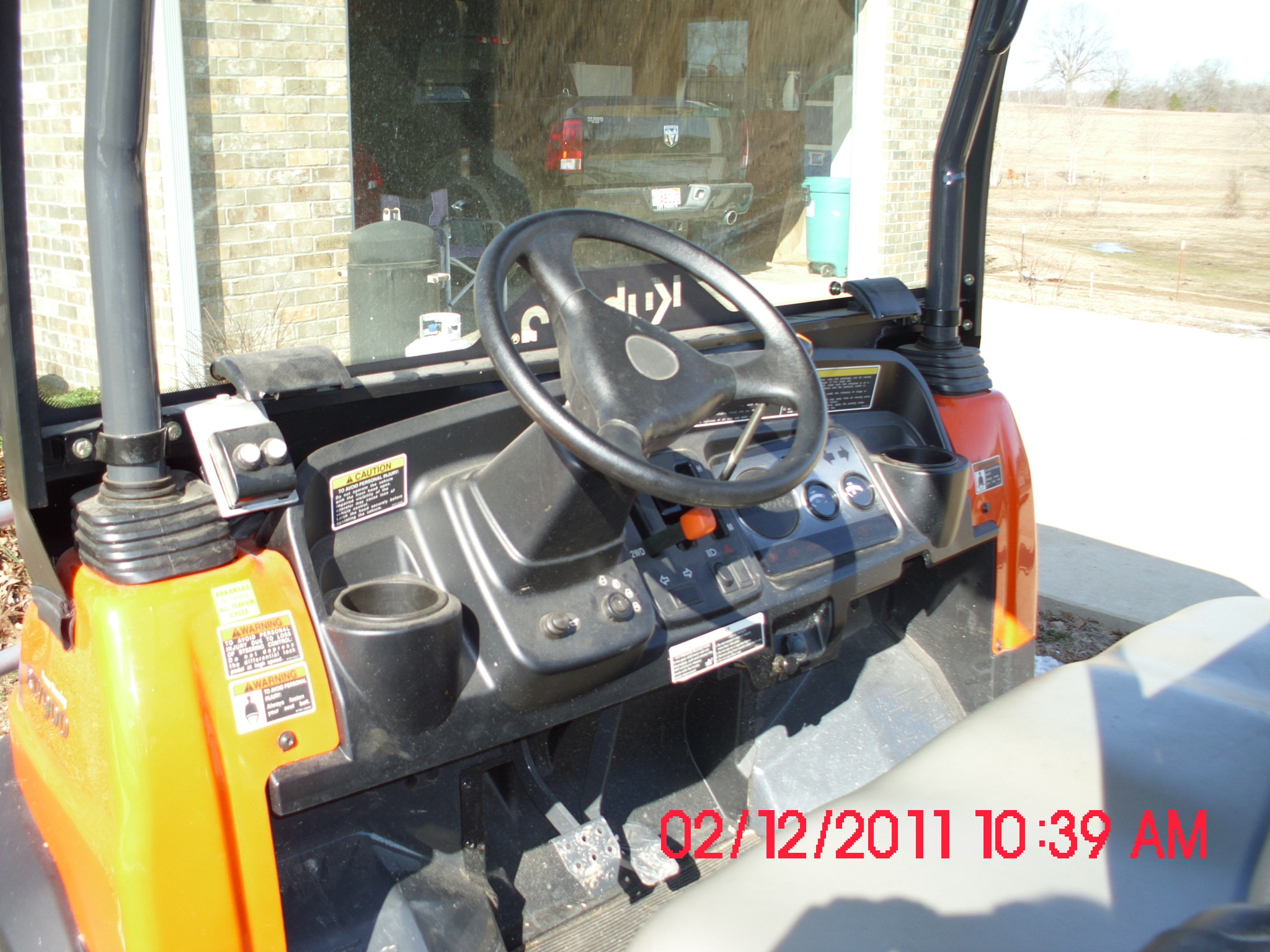

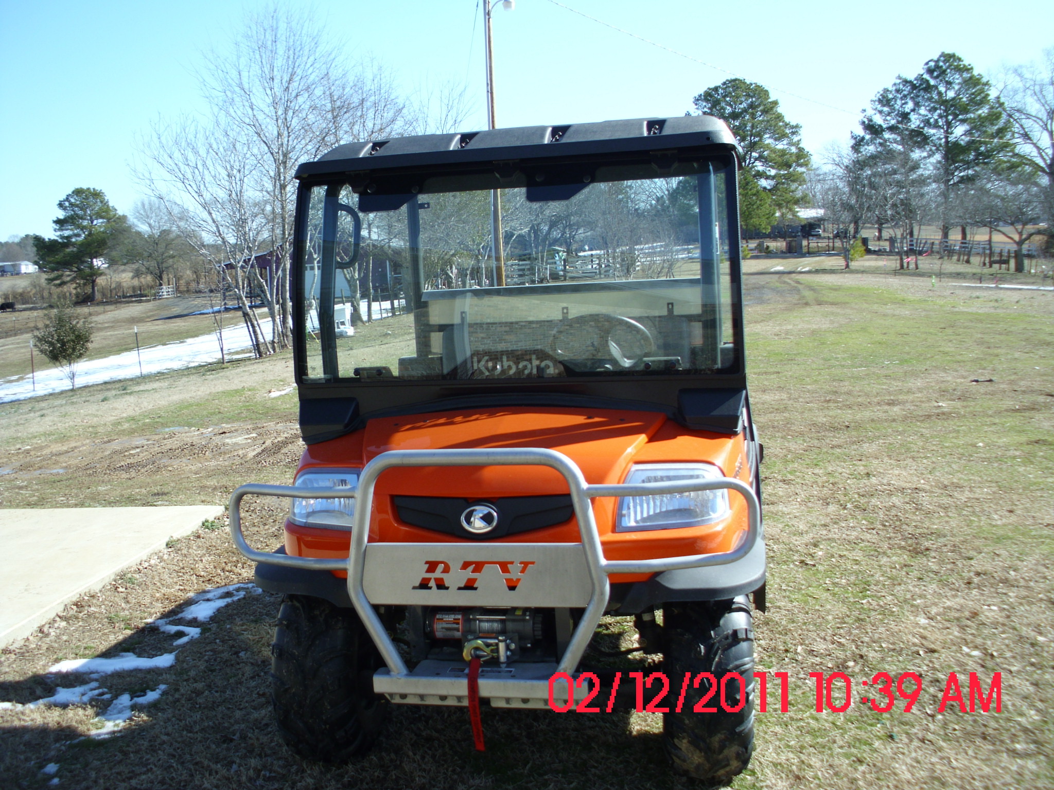

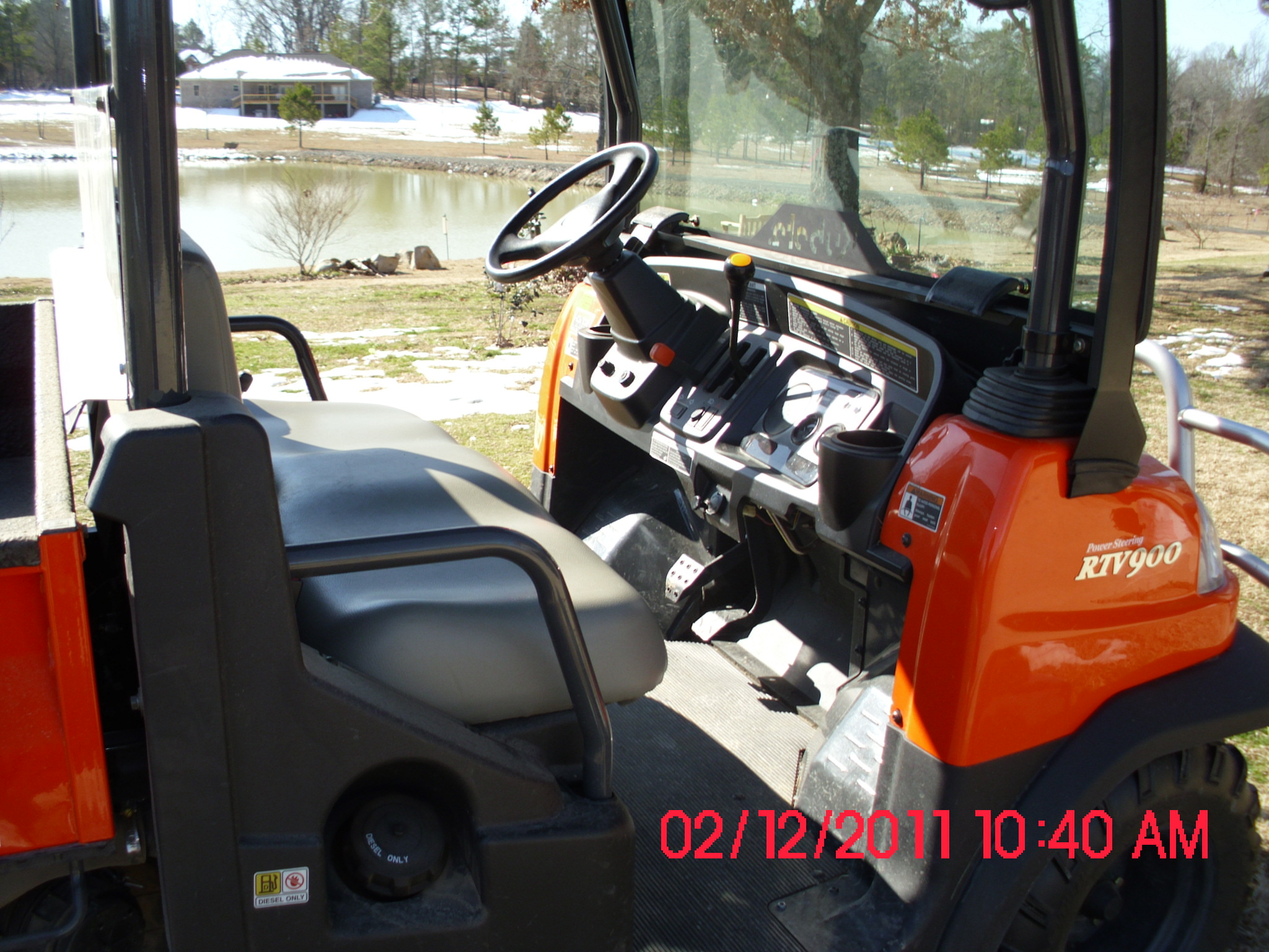

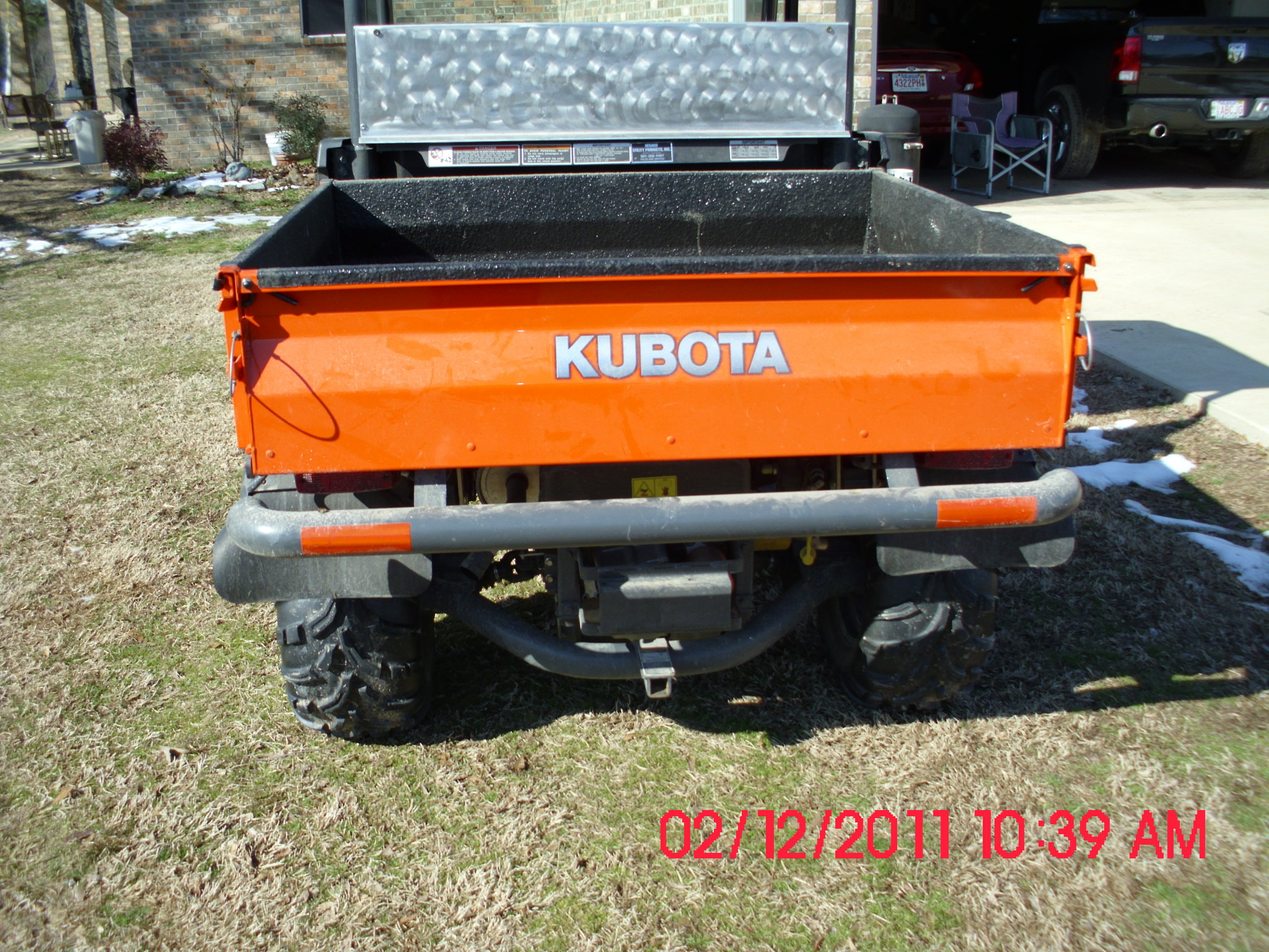

Here are a few photos of it. I am still in Nigeria working but I got the photos posted to me by my sister in law. Mine has the pressure release knob on the dash to neutralize the pressue if it gets hard to shift.

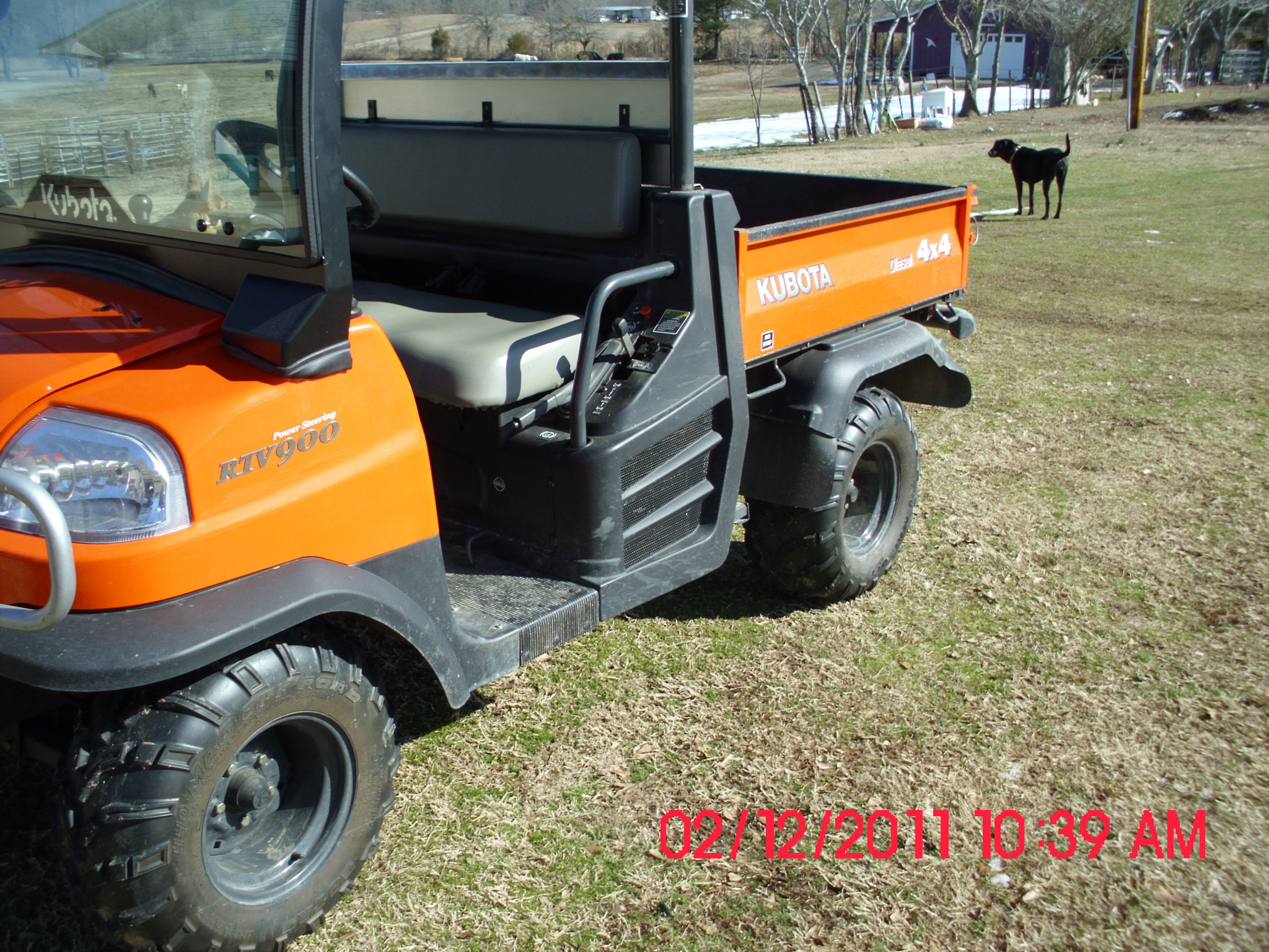

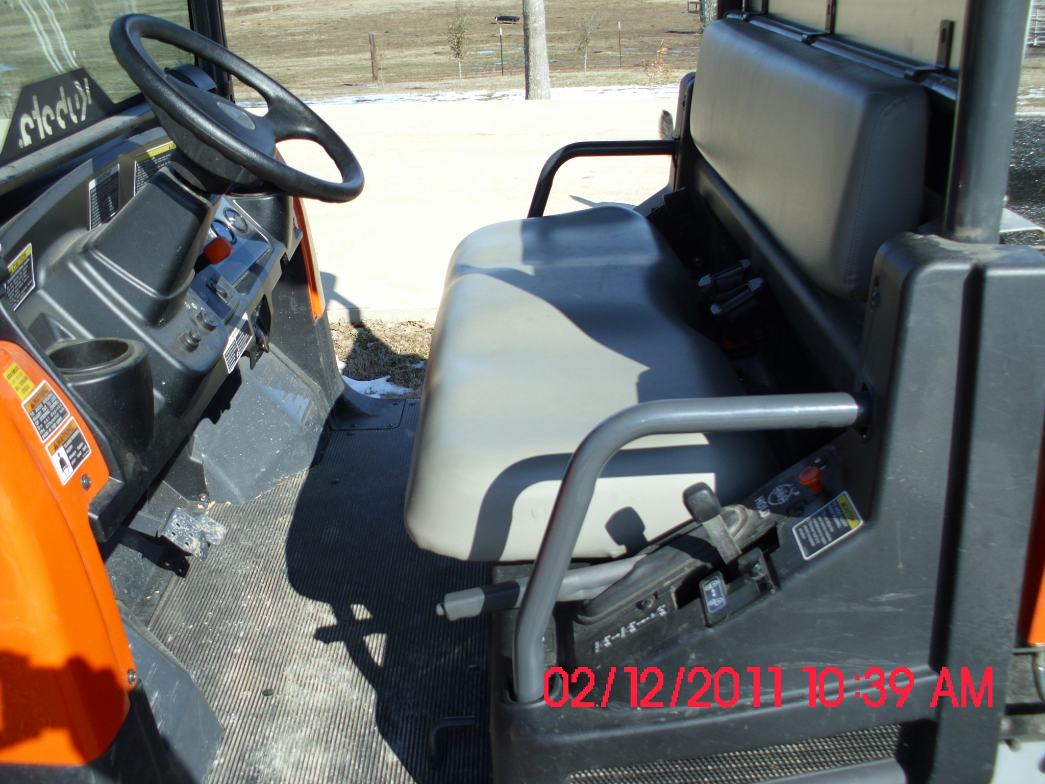

I have a few more photos to show. I will try the check on the pressure adjustment if it is hard to shift when I finally get to drive it next month. The wife drove it over from my brother in laws house and didnt like it at all. Said it drove like a tractor. I thought that was the whole purpose of having one. She said she will stick to her golf cart. If it is muddy and /or snowing she would just stay home. I will have some work to do to convert her over I suppose, but, maybe that is a good thing. I wont have to look for it when I need it.

Good looking machine.:thumbsup: My wife enjoys driving our RTV 900 -- a mixed blessing for me. She thinks the purchase was money well spent, but I get less driving time.

Your original post was to inquire whether it was a good deal. Well, after looking at all those pictures, my opinion would certainly be favorable. Nice looking machine you have there.

Congratulations. Nice loooking RTV. I noticed he had the sides of the bed coated with bed liner which is a nice protective idea. One thing I did to mine this past summer was to pull up the rubber mat on the floorboard of the cab and put a coating of bed liner on it. I don't hardly have a level place on my property and had slipped one too many times getting in with wet or muddy feet. It also helps to protect the floorboard as moisture does get up between the stock rubber mat and the metal floor. Although I didn't, for the reasons mentioned, you can always re-install the rubber floor mat after using the bedliner. To help with protecting the dump bed and as a possible aid in quieting down some of the engine noise and vibration I bought one of the thick rubber stall mats at TSC and cut it to fit in the bed. Just some project ideas when you get back home.:)

Wow, impressed with the overall appearance of that machine. That was a *good* deal.

I thought it was a good deal before but after seeing the pics it was an even better deal....it looks great. :D
