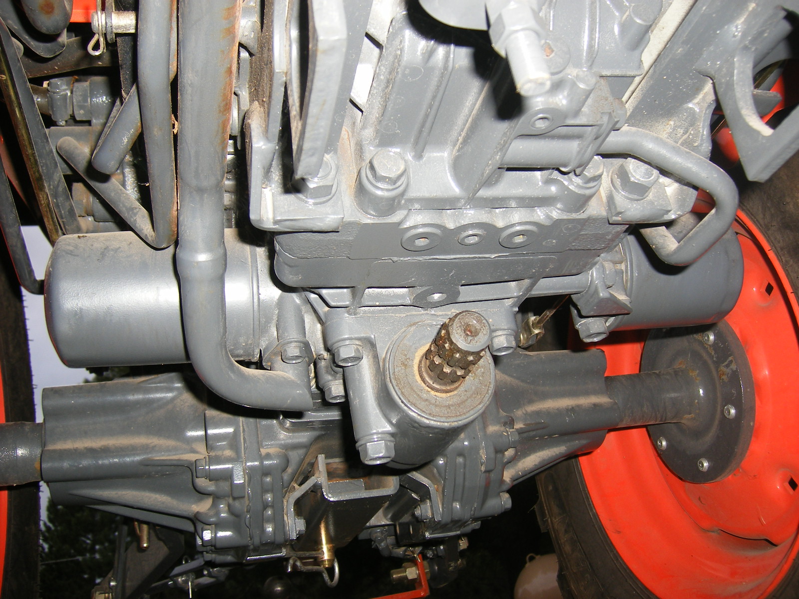

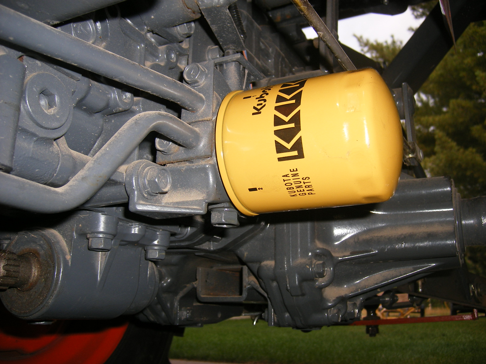

Changing the HST Filter​
The Kubota I have has two filters mounted horizontally on the trans, one on the right and one on the left. One is the HST filter and the other is the suction filter for the hydraulics. I have both on hand, as the dealer threw in the full filter package to sweeten the deal at purchase. Since both filters are painted over in gray, one cannot read the numbers on them. Again, the manual does a good job of pointing out their locations.
The hydraulic suction filter does not need to be changed, according to the manual, until 400 hours.
The HST filter is called out by the schedule to be changed quickly. No doubt its job is to catch any debris left over from manufacturing.
Simply put, on the 20 series B, the HST filter, the one you want to change now, is the shorter of the two, located under your left cheek, when seated on the tractor. :)
Doing The Deed

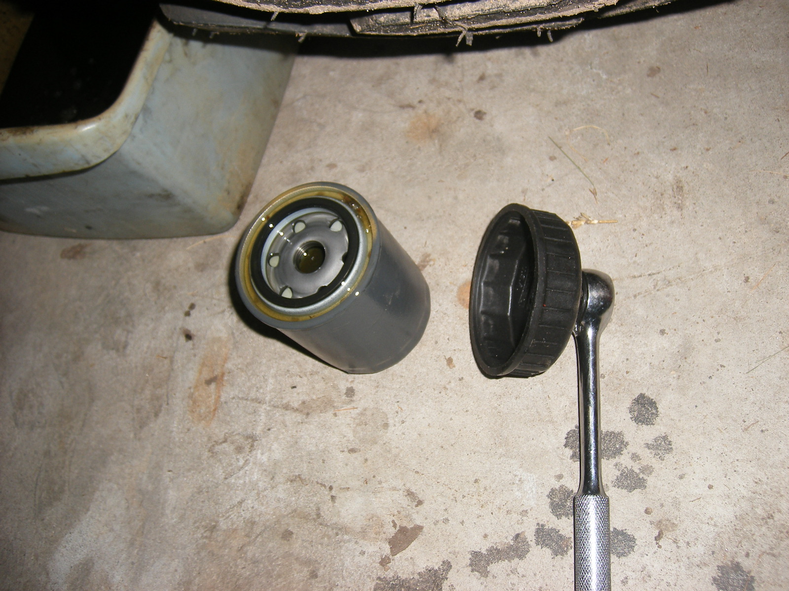

The HST filter, in this case, uses the same Cup #3 filter wrench. Readied the drip pan and took the new filter with me under the tractor. I had heard how tight some of these filters are, but this one was not too bad at all. I didn't know if I should expect a gush of sudt or what. Turns out there is nothing to worry about. The filter drains when you crack the seal but the the flow quickly ceases. I quickly spun on the new HST filter and Ta Da!!! Done.
I honestly did not lose even a quart. I quart I have on the shelf, so I'm good to go. Couldn't have been easier.
