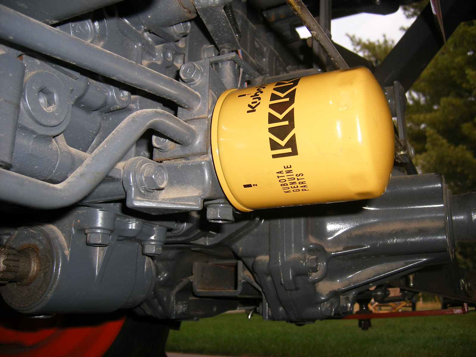

ericher69, you're a better mechanic than I am, I'm sure. I just know of no way to pre-fill a horizontal filter with oil and then install it, all the while fighting an obstructing radiator hose. But, sincerely, your step by step is worthy of guys following, as they can. Thanks.

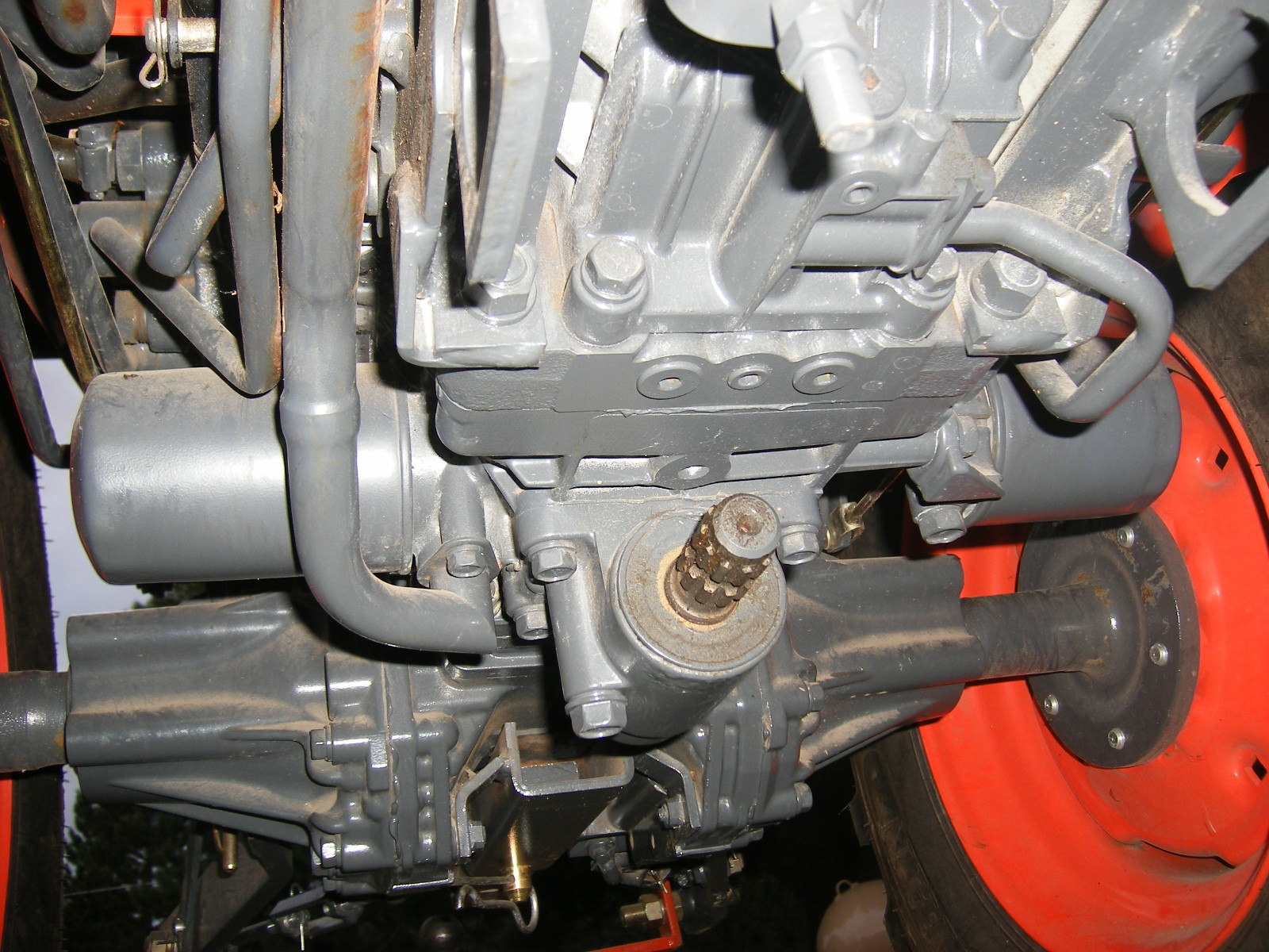

Update: on post 17, I've updated the HST filter change. I actually did the deed this morning. Piece of cake, and only lost a pint and a half, tops.
I don't know what the labor cost savings from having the dealer do this would be, but not even counting the transportation to and from, which is no small hassle and expense in itself, I imagine dealers charge a couple hundred bucks, on top of materials for a job like this.
Seriously, if you change or have changed oil on a car, you can do this. On the scale of 1-10 in degree of difficulty, I would peg this entire thing at less than a 2. Some guys contend that servicing your own unit teaches you about your tractor and helps you become familiar with it. I suspect so.

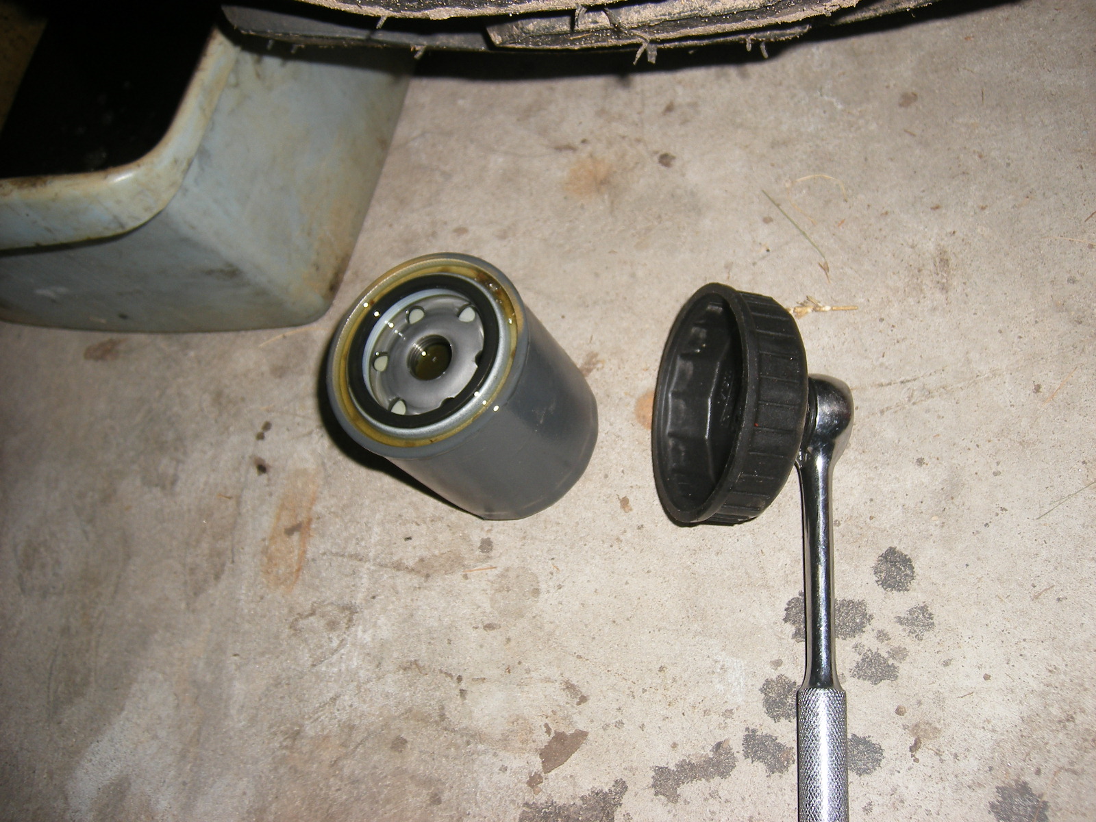

Bp fick
Not criticizing but...
Why would you change engine oil filter then engine oil?
I've always 1. Drained oil
2. Oil filter
3. New pre filled filter
4. Refilled sump
Am I missing something?
Thx
I'm not understanding this? What difference would it make which one happens first, draining pan or removing filter? Also, how can you prefill a filter that screws on horizontal and all the oil not drain out of it? I understand filter could be prefilled if the filter if threaded up from the bottom with threads on the top but not when they thread on the side of the engine block.
